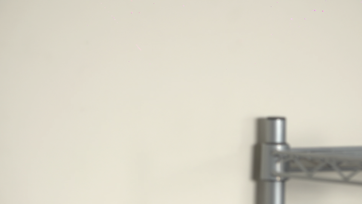

Hi, can any one tell me where or why there are small purple dots at the top right of the screen.
Thanks.

Damaged Sensor by the looks of it - If it's still under warranty, I'd send it back to Sony & get it replaced!
I had something similar on a previous NX70 camera & it was sensor damage caused by disco lasers - It required a new sensor & was covered by business insurance luckily. Don't know if you ever film discos??
Good Luck
edit:
Yes it's definitely damaged by lasers - the Purple is where there's damage to the green part of the Bayer filter - there's an article at http://www.laserist.org/camera-sensor-damage-thesis.htm

Oh Crap, yeah a few weeks back we were filming a concert and they were using 2 lasers, I did ask them to point them up so they did not point straight at the camera but it must of still hit the top of the sensor. It is under warranty, so I will send it in and see what happens.

Most definitely laser damage to the sensor ..we have seem this quite a few times on the forum and the venue always had lasers present..there has to be a lesson learned here. I wonder if that is classed as a warranty repair ...you might have to pay for a new sensor in this case and I bet you will make sure they are always behind you at the next event!

Yep....lazer damage......replace sensor....expensive....

Actually, I'm wondering if it might be some kind of damaged lens element as there is movement on the whole field of dots from 0:03 to 0:04 and 0:06 to 0:07 when the lens (it seems) arrives at the end of its range. Or there is some sensor based image stabilisation at play in the clip.

In the UK we have plenty of legislation on lasers for entertainment purposes and scanning the audience is an absolute no-no, but loads of dodgy dave double decks have no clue - and they just buy the kit and shine it on the audience. The impact on your retina would be equally destructive, and probably life changing.
Back in the tube days, we destroyed them when shooting videos of arc welding, and now that seems ok, but cheap lasers do more damage!
Out of interest, as it is just a few pixels is there a service routine to take them out of the scan on these cameras. Like the older dead pixel fix?
Still, it's a bit of a bummer to have that happen.
Andrew
No, the horizontal & vertical movement will be from the active stabilisation which uses a mix of digtal & optical stabilising methods. The zooming of the dots looks like it's due to using the clear image zoom feature.

So Sony Australia has replied to me, "yes this looks like laser damage, sensor replacement cost is $600 plus labour" well, well well, looks like it going to be expensive, i wonder if i could purchase the sensor and have a local camera tech fit it. hmmm,

That is an expensive bummer but you have little choice! Problem is at a wedding it's not the bride's fault ..it's the DJ and the DJ doesn't book us or care!! So what do you do at an event ...Talk to the lighting guy and ask if they have lasers or who really books you? I think they need to be made aware that you will not film if lasers are used and at most concerts they are part of the show. Concerts would be a tricky situation to handle unless you make sure you only film where the lasers don't have the angle to damage your camera??? Were you at the back and the lasers up front?? Is it actually possible to get decent shots at a concert and have camera positions that cannot be in the line of fire??
I guess I would send it straight to Sony and bite the bullet and pay your money..It's gonna be close to $1000 in the end!!!

Going forward, I wonder if some enterprising company could come up,with a filter that would prevent this kind of damage without screwing up the image too badly.

It would have to be partially silvered like a one way mirror. You'd lose a bit of light coming in to the lens, but it could be enough to deflect enough of the laser light off the surface that it would save you from sensor damage.
Its a matter of what size the market for this would be, and if it did indeed work correctly.
