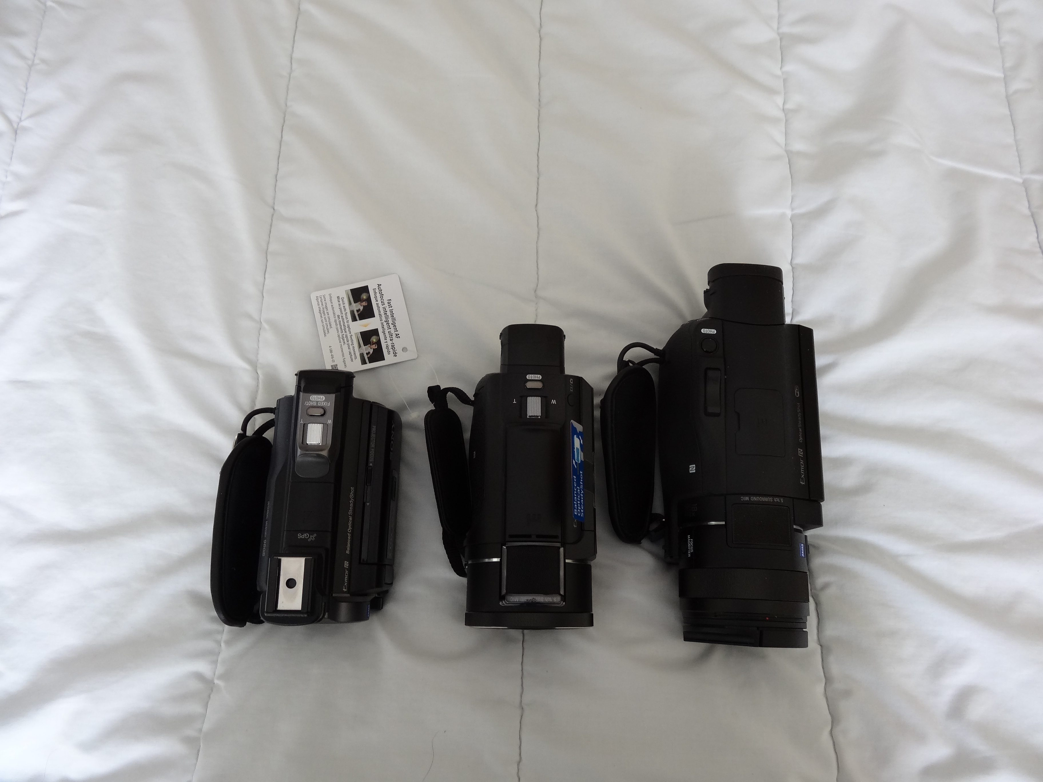

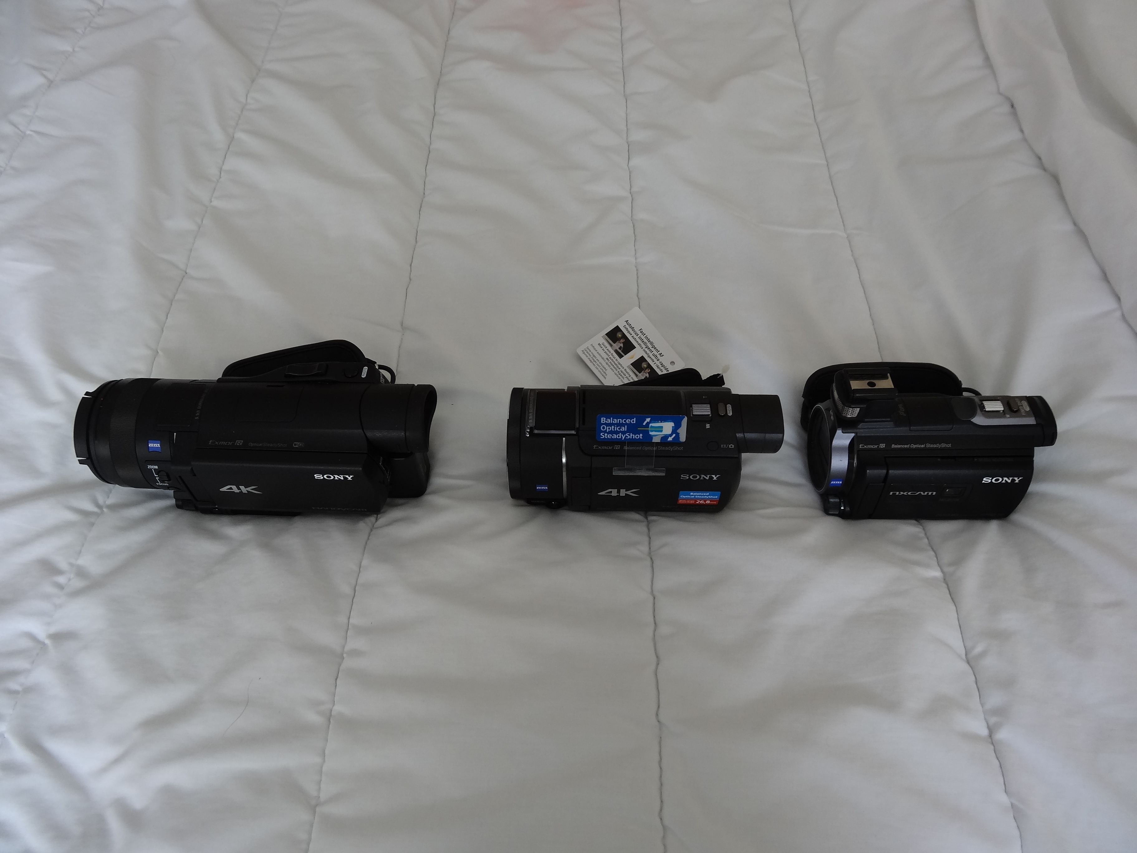

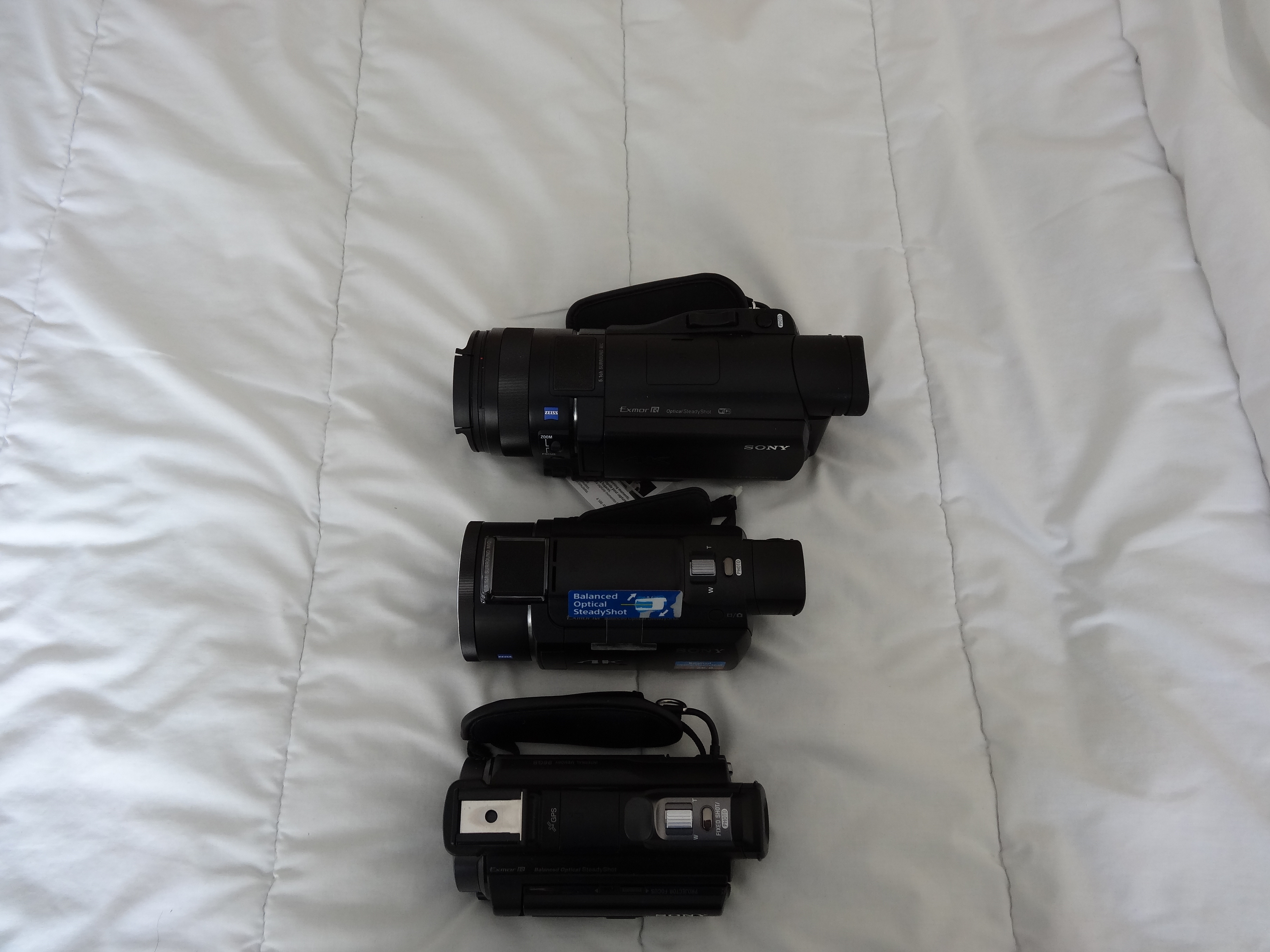

Old April 25th, 2016, 03:48 PM   #53
Join Date: Mar 2003
Posts: 4,222
Re: New Sony AX-53 Testing
Attached are a few photos of size comparison ( AX53 is in the middle in all photos ) to the AX100 and the NX30U ( like your CX760 ). It is midway between the NX30U and the AX100 in size. Wider than the NX30U and a little more heavy. The two things that stand out are longer zoom, wider wide angle and cleaner image in XAVC-S than the NX30U. It also has full data code and time code( in XAVC-S file ) too for integration with other cameras if that is what you want to use for multicam editing sync. Image quality is closer to the AX100 than the NX30U, clean and sharp. It is a lot bigger as you can see but I have changed to use it for family stuff rather than the NX30U. Performance is a little less sensitive than the NX30U ( maybe 1/2 stop and a stop slower than the AX100 ) but a lot cleaner especially at really high gain. I would say a marginal but noticeable improvement over the NX30U. Side by side the image is cleaner and a lot sharper than the AVCHD from the NX30U. Interworks well with the AX100 and both of course shoot UHD 30P. You should note though that the older A/V or LANC with adapters , wired remotes do not work with the AX53 and you will need one of the new Sony wired remotes or it does work with the IR remote from the NX30U but does not come with a wireless remote.
Ron Evans
