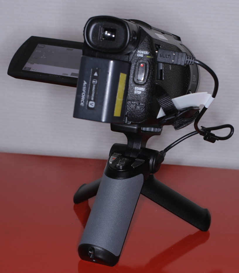

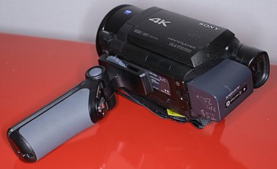

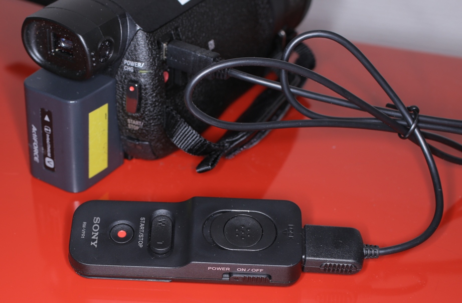

Posts: 880
Re: New Sony AX-53 Testing
It doesn't work with any of my regular LANC remotes, nor with some Sony remotes that work with my AX100.
I have two Sony remotes that work with this camera; the GP-VPT1 Shooting Grip and the RM-VPR1 Remote Control.
The RM-VPR1 can turn the camera off/on, zoom, record. Zoom has two speeds, I think it is 4 seconds and 21 seconds full tele to full wide.
The GP-VPT1 has zoom, record and photo functions. There are two zoom speeds.
Mark
