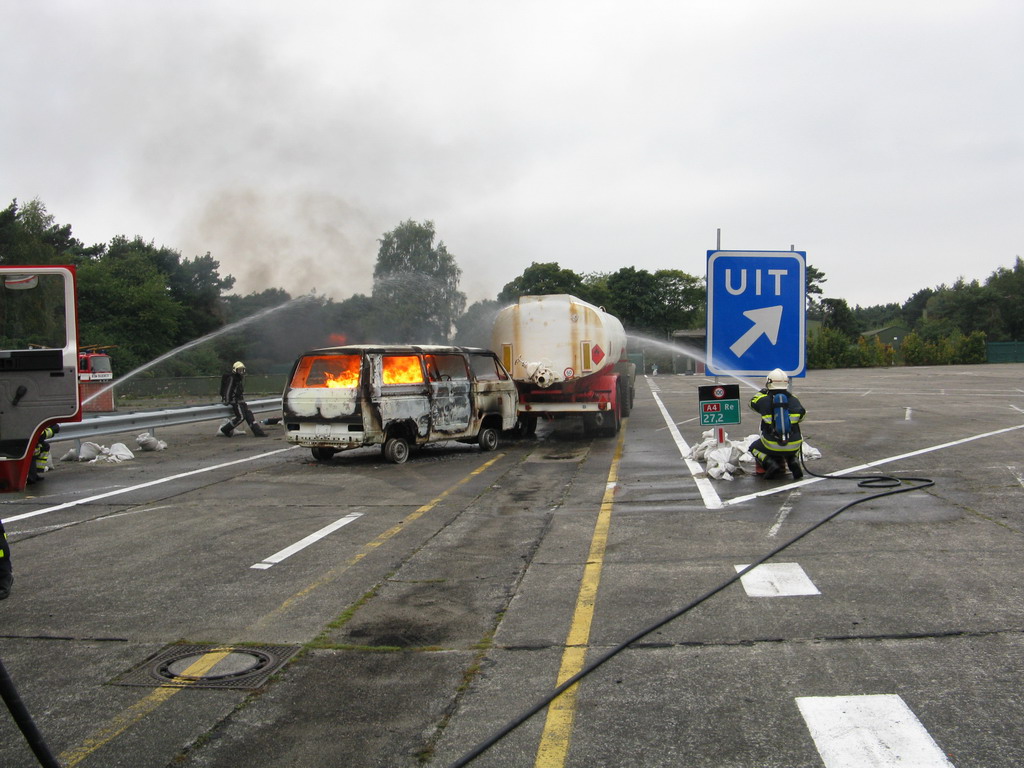

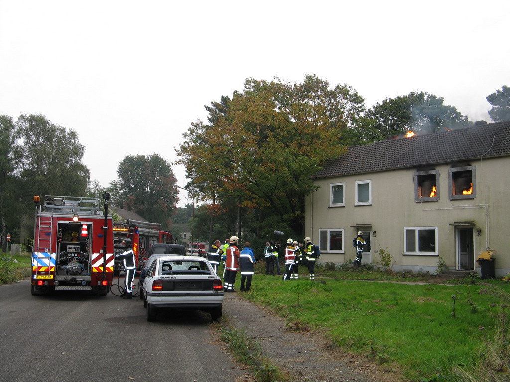

Hi All,
Shot the training last week, and all went well.
Thanks again for all the great input!
Attached a couple of photos of me with my sound guy Rene and of some of the scenes.
Richard
