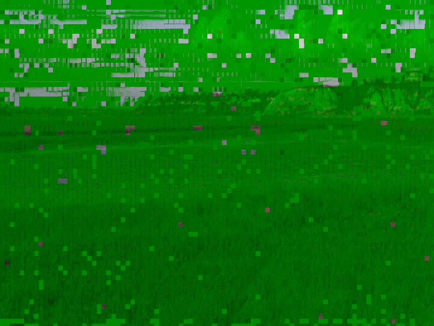

However, after a fun day experimenting, I've found that the MRC1 consistently creates two files per take when hooked to the A1 - a small 8-10MB file, then the remainder of the take in the second file with no further errors. Between the two files I see a glitch for two frames at 00:02;15. An example is shown this PPro2 grab.
The error does not appear on the tape of the same take. On the same subject with the Z7U, it does not create the error, and has a single file per take as would be expected.

Thanks James. So this 8 - 10 MB file is what - the first 3 seconds or so of each shot? If so, that's pretty bad news, right? That glitch could ruin a lot of otherwise good shots.

Just to clarify - the first 2-3 seconds are recorded ok in the first file, then the glitch appears for the first 2 frames of the second file. The rest of the second file is ok. Of the about 20 takes I did on the A1 yesterday, 14 of the small files are 2 secs-15 frames long, the rest are 3 secs 0 frames.
A quick snip in your NLE of choice should remove the error without losing anything significant - it's just annoying as it is definitely repeatable on every take. It would be good to hear from any others with this combo - if they are seeing the same problem, of if I'm doing something boneheaded...

Ok, getting to the bottom of this now... I found a setting in the MRC1 menu that sets it to "SYNCHRO" rather than "FOLLOW", with synchro selected I now get single files per take (6 out of 6 tries, anyway).
Just the sort of goof that happens when playing with cool new stuff without access to the manual! I found out that Sony put the manual for this on the CD that came with Z7U, which I don't have here.
Anyhow - it seems to work as Evan originally posted, and I will be borrowing this one every chance I get...
