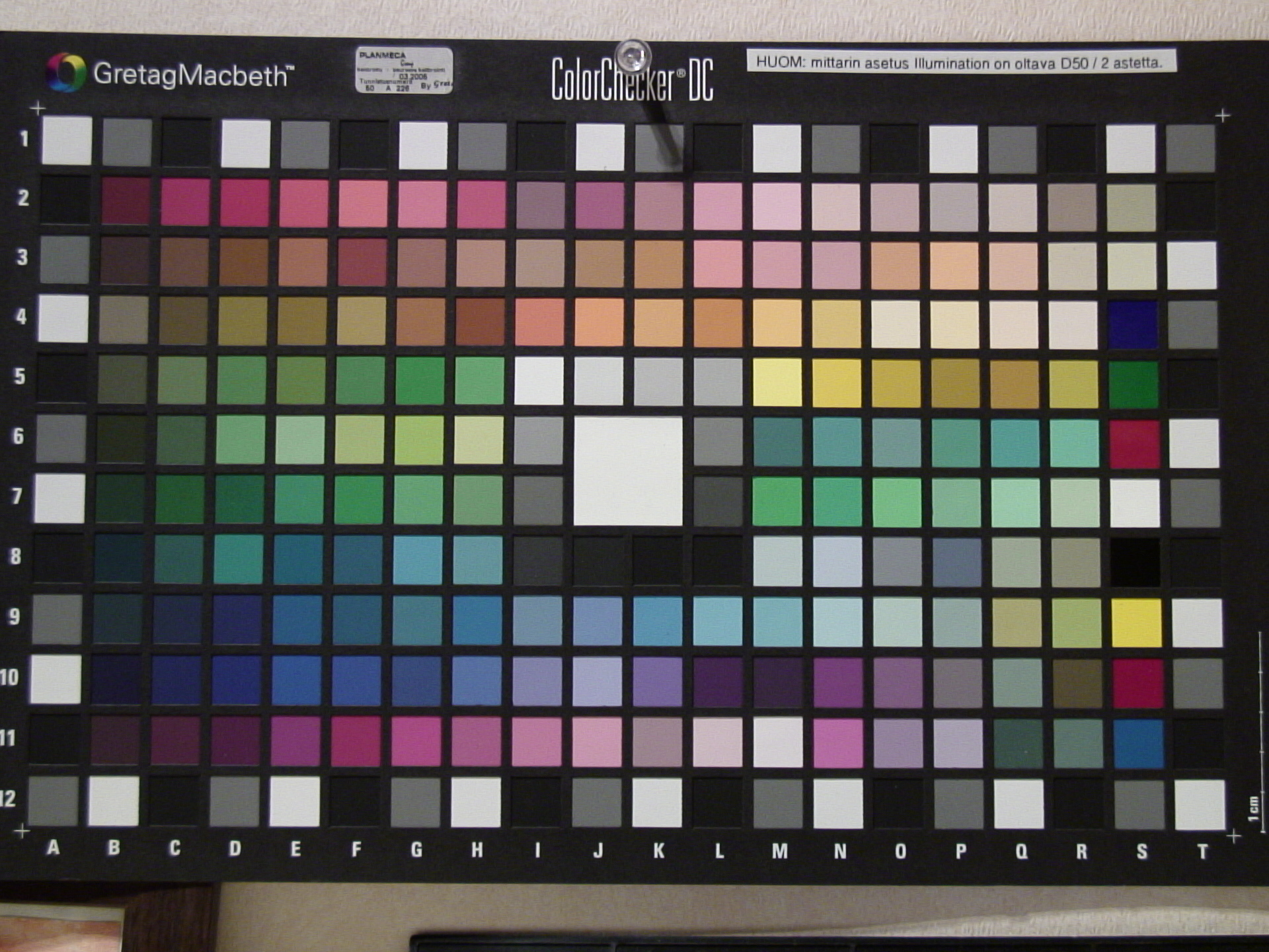

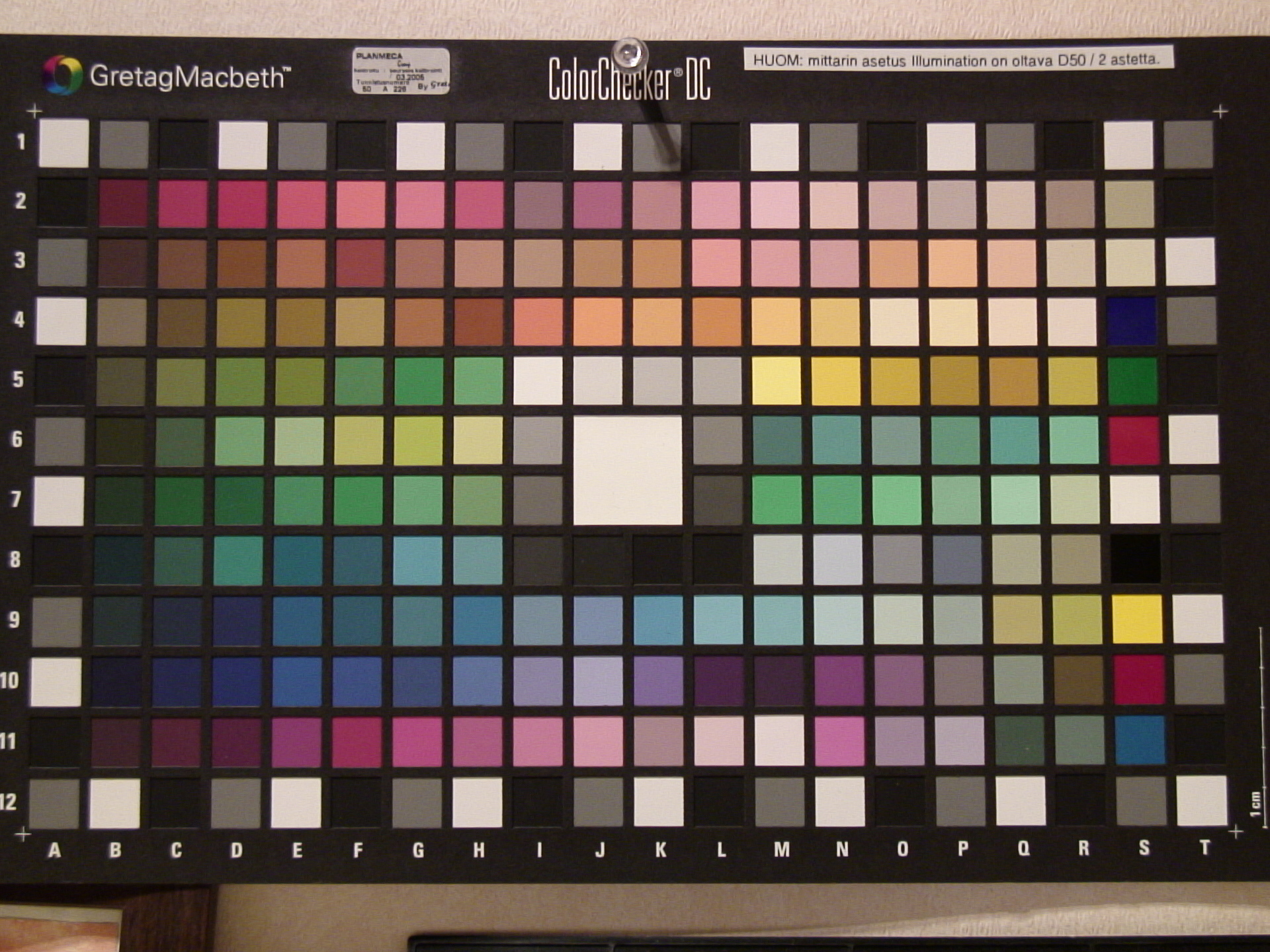

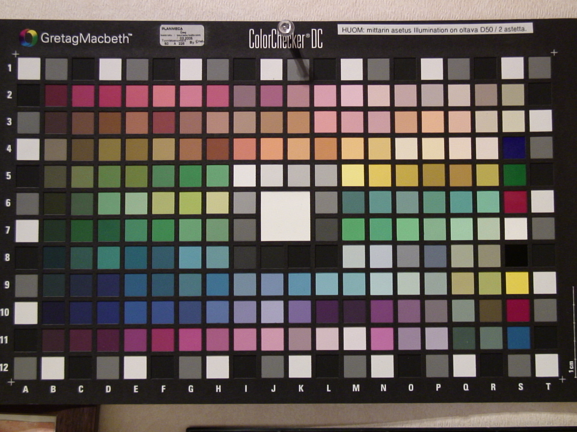

HC1 back from service - red color issue solved!
Hi,
Finally - after waiting for almost a year - I sent my HC1E for service. The reason was the poor red color rendering, and unsatisfactory color saturation in general. And the warranry was just ending.
The camera did its round-trip from Helsinki to France in only 4 days - quite a remarkable achievement. Great work Tele Niinimaa Vantaa!! And Sony :)
The firmware was updated and the HC1E recalibrated. Best of all - the repair that I suspected would be just another unnecessary trip payed off - THE PROBLEM IS NOW FIXED!! The colors are now more vivid and natural - compared to the washed out bluish color rendering before.
What a great day today is - finally this beast lives up to the last expectation that I had before I made the decision to purchase.
You CAN live with the rolling shutter, the artefacts produced by it are normally so subtle that they go unnoticed - if you do not know where to look for them.
I thought that Sony would have fixed the zoom speed issue at the same time - but no. The zoom lever is still ridiculously fast as its slowest. Well - I am shooting mostly using a LANC-enabled tripod where I get 24 second zooms...but it would have been nice if they would have fixed this at the same time - it is just a software issue.
I could afford to wait this long for the service, since I have not been shooting during this summer. Some earlier recordings with poor reds I was able to fix during post edit. This very late update guaranteed that I got now the latest firmware available. Probably there are no newer ones coming for this discontinued cam.
To proove my experience and for you to see yourselves, I have added couple of stills (of a professional GretagMacbeth Color checker chart) - taken with the HC1 before and after the service. The color behaviour in the HDV and DV modes are very similar. I have just included the stills for the sake of simplicity and size:
Before the service:
HC1 OLD AUTO: Fluorescent low light condition, FULL AUTO
HC1 OLD MANUAL: Fluorescent low light condition, manual WB
HC1 OLD INDOOR: Fluorescent low light condition, Indoor WB
After the service:
HC1 FIXED MAN FL LL: Fluorescent low light condition, manual WB
HC1 FIXED AUTO: 2700K 2000Lx Halogen lighting, auto WB
HC1 FIXED INDOOR: 2700K 2000Lx Halogen lighting, indoow WB
HC1 FIXED AUTO WB+2 AE-1: 2700K 2000Lx Halogen lighting, auto WB but tweaed so that WB+2 and AE-1.
Comparing to my Canon MVX2i the colors are still somewhat "cooler" in the HC1 - but that is typical for Sony. Overall - I am now very satisfied and the difference is remarkable. To be fair, please only compare the pics with each other that are shot in Fluorescent lighting (HC1 OLD AUTO, HC1 FIDEX AUTO FL LL).
To match with my personal taste I have noticed that I get the most natural exposure and color balance (using full auto) if I tweak WB+2 and AE-1. This gives a little warmer tones and avoids the slight overexposure tendency in the HC1. Setting the AE slightly negative also limits the HC1 gain boost at low light levels - not a bad idea at all.
Now I smile again :) Thanks Sony for making my day !!!
