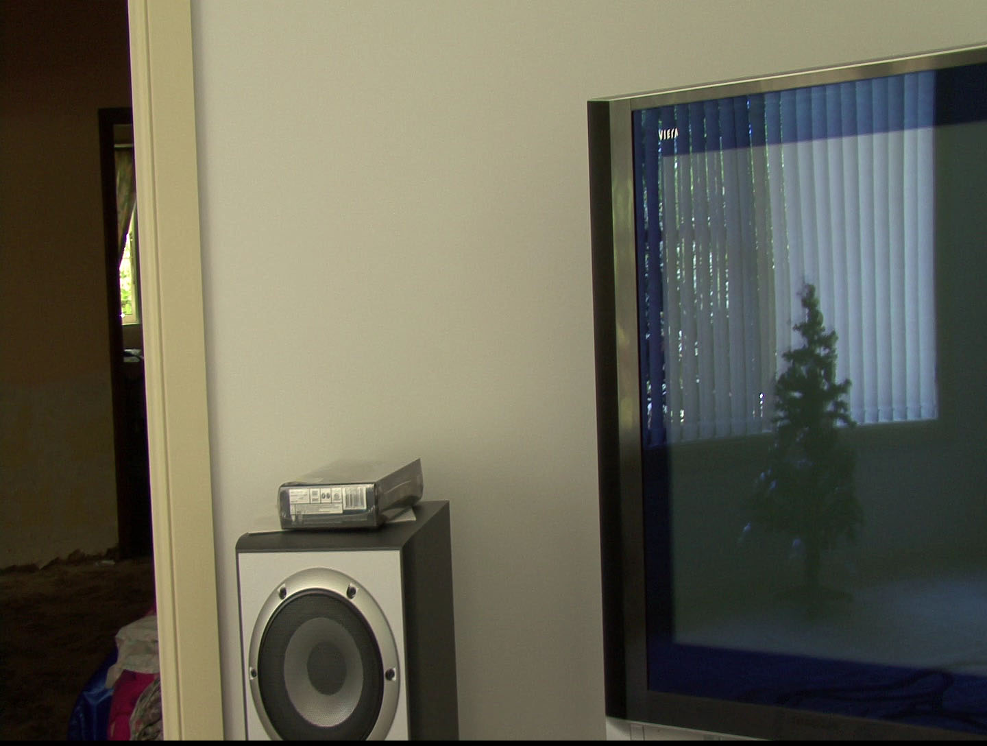

The crawling that I reported is both horizontal and vertical and is taken directly out of the camera via HDMI onto a 42" plasma HD screen.On a second look a some footage taken inside as well, the edges don't exhibit the crawling but are slightly fuzzy in places making you look at the video as if it were out of focus in those edges but fine on other edges. The video does not look sharp on some edges but fine on others at the same time. Bit like having one lense out of a pair of glasses fall out. You keep looking to find what is a clear image. I won't put an image up as too many variables come into the equation to be able to get a definite conclusion, an mt2 would be the only way of really evaluating the footage.
Michael.
Michael.
That sharp then fuzzy edge is due to interpolation.
An image would be useful to demonstrate the issue as you see it. The image doesn't necessarily have to me moving.
Please post a grab.
Michael.
This crawling report shows similarities to the other report don't you think? If you can post a small .mt2 that would be fantastic. I think we have more reports coming up soon.

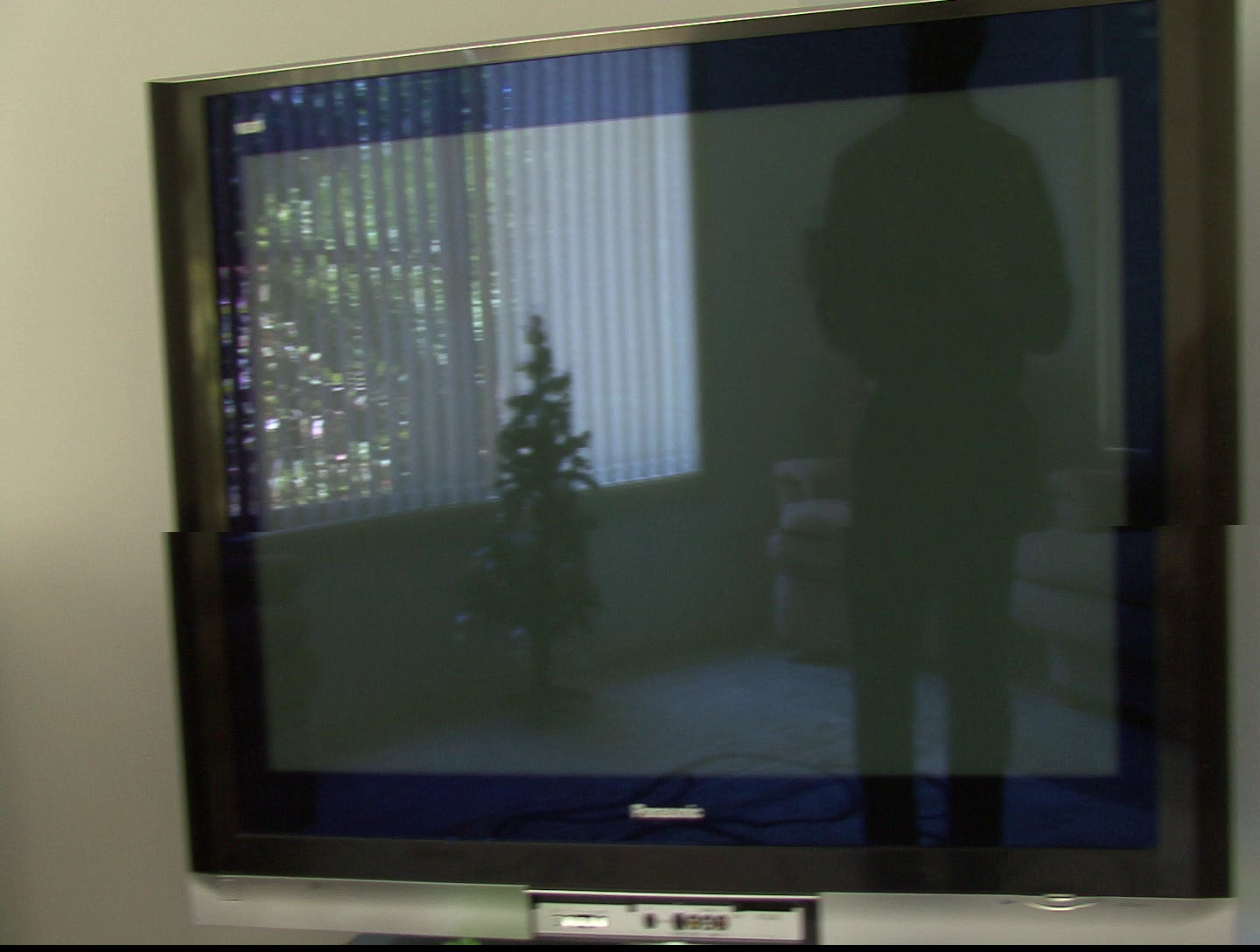

Here is a couple of images. Note the top of the TV screen. The blur is panning across the screen.
25p flaw of the V1 E model is official?-ndvd_000-copy.jpg   25p flaw of the V1 E model is official?-ndvd_001-copy.jpg
Michael Phillips is offline

All I'm seeing are some information-challenged screen grabs. Your aspect ratio is not accurate on whatever camera you shot this with.
Shooting something that has clean edges with contrast might be of use? If you're trying to shoot the television screen displaying whatever you're shooting, shoot clean edges, use your still cam to zoom in deep on the edges, and then photograph that. It still won't show much useful information, but it at least will demonstrate what your television is doing to the image.
Dang, I wish my house was as clean as yours!

I think Mike's talking about the jaggies along the top edge of the bezel.
This was just screen grabs using Nero as I am having trouble with Vegas reading my M2T's. These were captured with Vegas but I could not get them on the timeline to do a screen grab. The ratio is nero's doing,I did not have time to adjust.
Michael
Well the problem with those images is aliasing, nothing to do with the camera I suspect. I can make the problem worse or better by just doing a crude rescaling. That it's being displayed at the wrong AR is probably what caused it. Any image with a strong diagonal line in it will suffer from exactly this problem when scaled without AA and/or bicubic sampling.
This would also explain the issue with the a plasma screen that's not native 1080. Also the potentialy higher res of the progressive frame will make matters more obvious.
I sadly spend a lot of time having to watch HD broadcasts on an attrocious BRAVIA Sony LCD TV, this and a large number of other artifacts appear on that device that I know are not in the HD source or in the broadcast.
I think this is going to be the challenge with HD for a while, it looks so good on the right gear and can look worse than SD on poor "HD" gear.
Sounds to me this phenomenon you see is quite normal for HDV material. A moving image like a pan causes the image to soften anyway thus reducing the visibility of any stairsteps until the camera comes to rest.
Having read Bob's message re:Bravia HDTV artefacts I have a feeling the marching ants is a phenomenon of the viewing device.
The 25P recorded by the V1E is interlaced material and is the viewing device is unaware how to deal with Progressive material encoded in an Interlaced stream. The HDTV in question is probably de-interlacing the 25P which could easily account for marching ants type artefacts seen. How these HDTVs de-interlace 50i material is a black art and differs from manufacturer to manufacturer.
