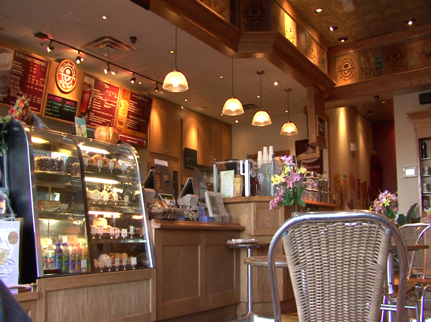

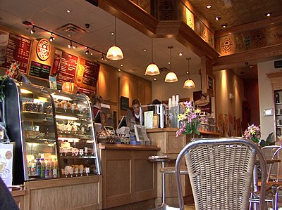

OK -- which are 24p and which are 60i? They are 60i at 360 and 24p at 216.
Just use the pix number: 0 1 2 3
Sorry for the JPEGs. I wish we could upload TIFF or large BMPs.
And, yes I've made it harder by using 4 pix -- prevents guessing at 50:50 chance.

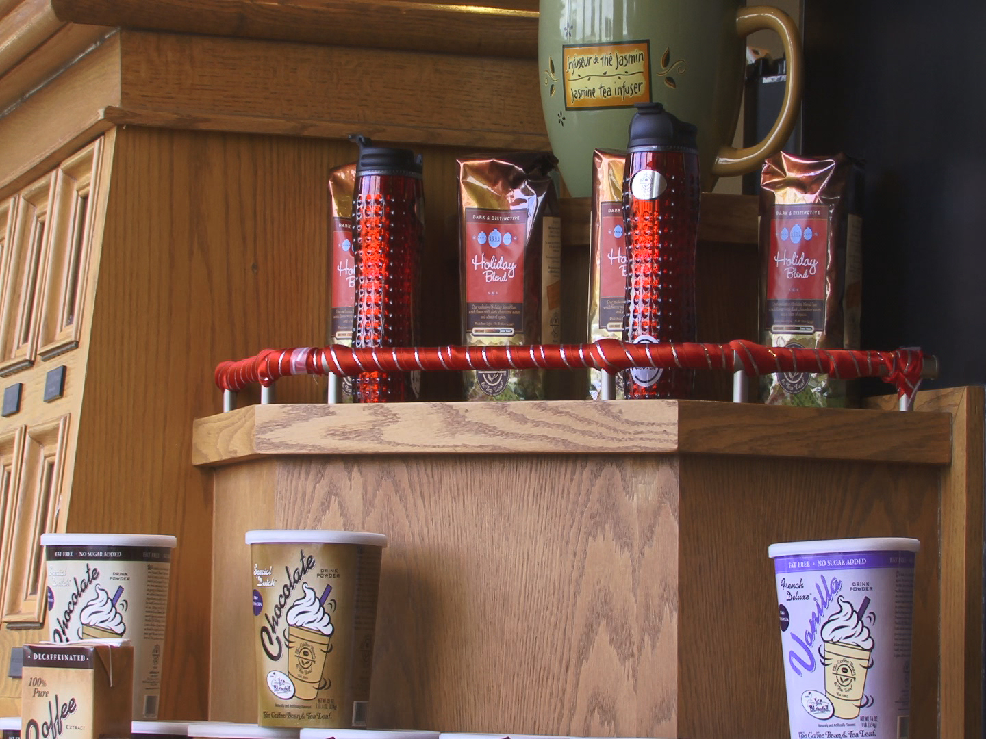

Now for those who claim 24p is different than 30p -- which it's not since it begins as progressive just like 30p -- which of the three A B C pix are 60i and which are 30p? Maybe one of them is 24p?
Given the claims that there are huge quality differences between frame-rates -- you shouldn't even need to play games and blow these up. The claimed differences should obvious at a glance.
Look for the oil paint FX. Look for the ants. Look for the macroblocks with no detail. Look for the ringing. :)
And if you claim you see some artifact -- you must describe it and point out where it is. No general "I see X in Y." Your observation must be able to be verified by others -- or it ain't valid.
Remember, it's claimed the effects are so serious that they are a deal breaker, so if there isn't a consensus -- then there isn't any problem with the V1U.

In c.jpg I can certainly see the oil painting effect, nowhere near as dramatic as what I've seen in some footage I've shot but given the subject matter that's exactly what I'd expect anyway.
That's the issue here, the problem only becomes pronounced enough to be objectionable with certain subject matter. I don't think anyone's saying you can't shoot footage that looks great. Rather the issue seems to be that you can shoot certain scenes under certain lighting conditions and get really bad results and under those and only those conditions there's a difference between shooting I and P.

I think this qualifies as "good" lighting -- so where is the "ringing?"
Or, if you think it qualifies as "bad" lighting, then there should be all the artifacts.
Remember, you must describe it and point out where it is. No general "I see X in Y." Your observation must be able to be verified by others.
Time to put your claims to a public test.

Btw in the numbered line two pics are copies of each other, not different shots with different settings. It is indicated by the identical head positions. The other two maybe identical, too - at least no heads there to indicate the difference.
What I see is two times two identical pics, two of them show oil paint inside the cake chiller.
If I had to live with that, I would be happy with it. But 25p is different.

After looking at your pics, it seems to me that pics 1 & 3 are the 24P images. To my eyes, the dead giveaway is the drop ceiling behind the counter. It simply loses detail when compared to the other images.
