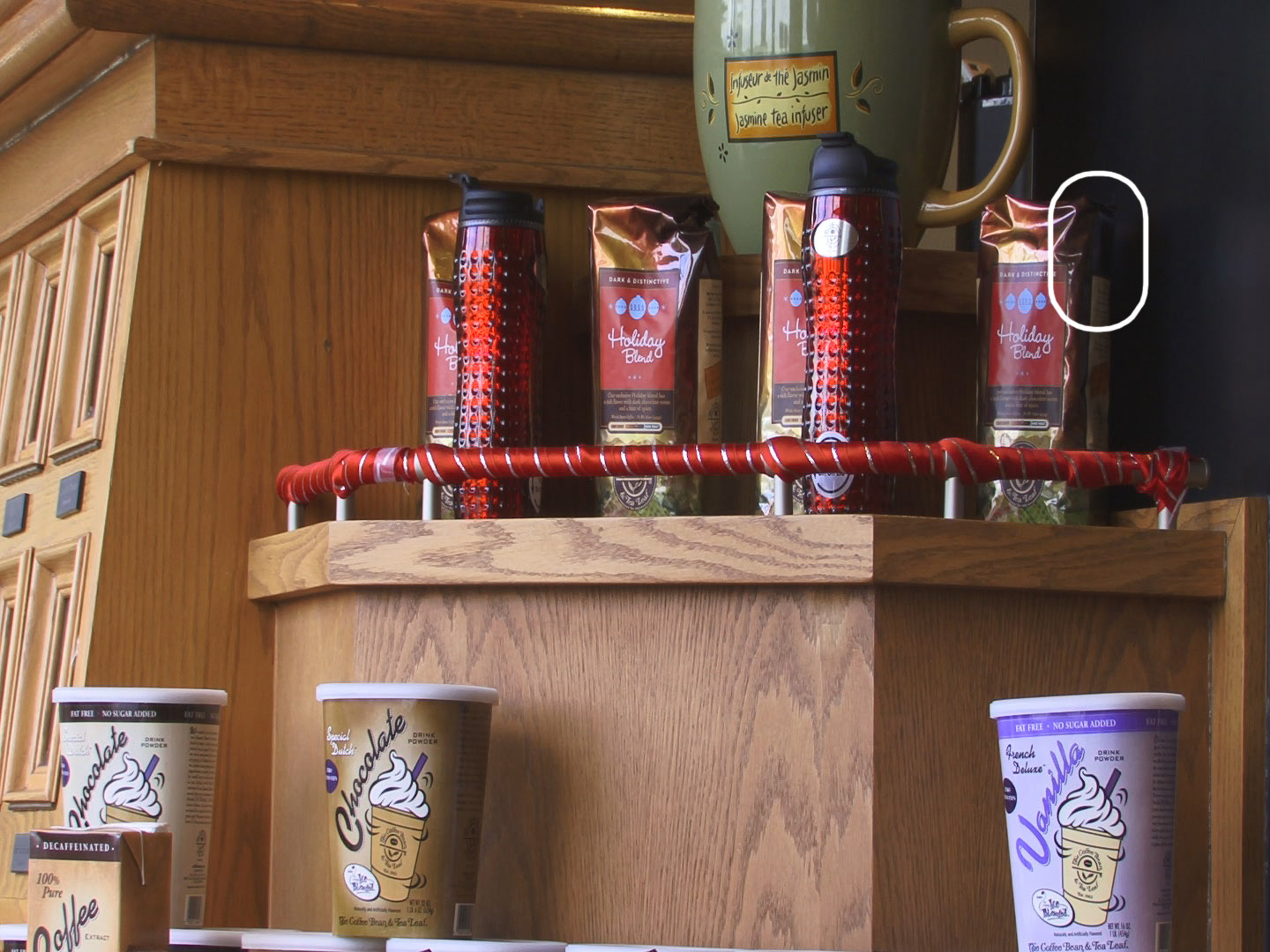

Steve,
sounds like I've had that V1U in my hands briefly too, well travelled camera!
Look I don't think anyone's telling fibs, I mean that most sincerely. I think we all need to take a deep breath and realise that IF there is a problem it's a damn complex one. As I've said before my analysis is that you could very easily shoot with this camera for the rest of your life and not feel there's any issue at all. I still think for the most part it produces some of the best looking images of any camera in it's price range and it's got enough image controls to keep any test pilot happy for years to come, I mean what image controls are missing on the dang thing, not many, it even lets you store setups onto flash memory, can't do that with even a Z1!
Now you mentioed the footage shot by DSE, I have to admit when I first saw it after other had pointed it out I could see the odd problem but a) it was a prototype and b) you had to look pretty hard to see the problem, sure didn't put me off one bit.
And then I saw your first posting of those coffee shop images and I was blown away, they looked great. Well OK, there was the odd bit that looked like CA but heck for the money no one could complain, every HDV camera has these issues. It's not the camera it's the glass mostly and you'd spend a lot more than what the whole camera costs just to get a lens that doesn't have issues.
But now we're seeing what were minor issues affecting small parts of the frame affecting large parts of the frame. No I don't think it's something that's crept into the production models that wasn't in the prototypes. There's a small trace of it in one of your coffee shot frame grabs. Well I think that's what it is and no I don't mean the wood grain. Take a look at the attached image I've circled an areas where I think the same thing is happening. In this case it's not a problem, no one would notice it without looking real hard and they shouldn't normally be doing that. But when this effect hits larger parts of the frame it's then that it cannot be ignored.
Now maybe there's a way to stop that happening, maybe I'm looking too hard, I don't have enough experience to really say for sure. All I can say is it looks wrong to me.
Now I'll admit in my most recent test I did something really dumb, I forgot to turn off the ND1 filter after the camera had told me to switch it on. Don't remember seeing it telling me to turn it off, stupid of me to not realise I should have anyway. One things for certain, causing the camera to wind the gain up sure bought the smear problem out in a high contrast scene. Again this shows two things. a) I'm a lousy cameraman b) Sony could make the indicator a bit more In Your Face c) the problem seems to relate to noise levels. Or perhaps part of the problem is people other than me not turning the ND filter off? And for what it's worth I was shooting 50i.

Bob, I looked carefully at your circled area and I honestly have to say (even though you said the same thing), if we have to look THAT hard at an image to see an issue, then perhaps we should paint the picture instead (no paint-effects jokes please). I don't think there's another camera that could hold up to the scrutiny that this camera has.
Heck, I've looked at the Canon images and frankly I couldn't live with the terrible color seperation that seems to occur in some images on the right side of the frame. Just like the Sony, it doesn't show up in all clips, but IMO when it does, it's far worse than the issue with the Sony. It's particularly bad since this issue effects both the 'i' and the 'p' issue, it's inescapable. I've seen a number of clips that show this effect and it almost looks like a color CRT TV with terrible convergence issues. I myself could not live with that because it's such an 'in your face' problem. Frankly I'm utterly amazed that more Canon owners don't complain about that. My tiny little Canon HV10 HDV cam doesn't display anything like that problem.
So yes, none of these cams are free of issues, I guess you "pick your poison".

Just my $0.02: you're right about the color fringing issue with the Canon, but IMHO it IS escapable - it only shows at the zoom and aperture extremities AND contrasty scenes all at the same time; you may easily avoid it (and BTW, just take a look into the "Purple outline on background objects" thread - I never saw a color separation that bad on the A1).
That said, I agree that the issue in the area circled by Bob is a minor one.
