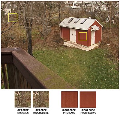

Well this is getting even weirder. So I'm looking at the two screen caps with the red work shed. I'm really trying to work with this reduced sharpness theory but I'm actually noticing now that the tree branches, especially in the right side of the frame, look quite a bit sharper and crisper in the progressive frame. There are actually some very fine branches that wash out in interlace mode that are clearly visible in the progressive frame. The increased resolution and detail in some parts of the progressive frame just does not align with the theory that progressive mode has reduced sharpness over interlaced. I think it stands to reason that whatever the sharpness settings are for progressive vs interlaced, it should be even across the entire image. I'm very clearly seeing now that the red siding on the shed - especially the front with the single door - is extremely blurred out in progressive and the details in the branches are actually increased.
I think I'm going to pull this clip into After Effects tomorrow and take a closer look.
Good eye. That effect is visible on LCD as well. I think the reduced sharpness is unlikely. I played with the clip in Vegas 7 using levels and channel blend. The red shed lines that appear to soften in progressive are actually the more underexposed portion of frame. They contain much more blue and red, much green.
Most of the branches appear to stay same or sharpen slighty in progressive whereas the shed detail disappears.
My guess is that it's noise reduction (or possible a gamma/matrix issue) that is causing somewhat underexposed (lower IRE) areas (seems to be more blue and red channel affected) areas to get excessive noise reduction applied, basically treated detail as noise and smoothing it out.
However, areas of the frame that it identifies correctly as detail, and we see the slight progressive sharpness improvement we expect.
This jibes from my observations of Tony's images - areas of low detail in darker areas of frame lose detail and/or watercolor effect.
Ha! I noticed the exact same thing! The progressive frame even seems to have more sharpening artifacts in certain areas of the frame. I made these 100% crops to illustrate Philip's point.
In the m2t, I also definitely see the dancing noise in the progressive versus interlaced.
I too noticed this, but I feel these HIGH-CONTRAST lines are exactly the ones where edge enhancement would be applied to increase their apparent sharpness.
In other words, overall detail can be soft -- the siding, grass, the wood railing -- while at the same time EE is applied to edges that meet certain criteria. And, at the same time noise reduction -- perhaps only chroma noise reduction -- is applied to areas of the same color. Multiple alterations to the video occur at the same time. And, each alteration is dynamic. It is turned on and off as needed.
This is what DSP does to "enhance" the image. This is how Sony got Hi8 to look so clean compared to S-VHS. This is nothing new in camcorder design.
I agree that increasing Sharpness might not be the right solution because -- as I think about it -- it might not help the grass and siding at all. It all depends on exactly what increasing sharpness does. I'm now thinking it only affects EE and not detail. (Which means there may be no way to avoid the fact P looks softer than I.)
Thus, if Brett's video was shot at 9 -- the branches might look better if 7 had been used -- while the siding might look the same. Which raises the possibility that Sony defined 5 for Cine
because it reduces EE while not really reducing detail.

Originally Posted by Steve Mullen
Look for the oil paint FX. Look for the ants. Look for the macroblocks with no detail. Look for the ringing. :)
You deinterlaced those pictures. That means effective resolution is dropped by half even in the progressive pictures. Previous pics were not deinterlaced, but they had no motion so the interlaced pics also contained a lot of information and no visible interlacing.
Atleast the 1,2,3,4 pictures, the a,b,c shots look fine. Compared to the a,b,c shots the four first ones are visibly lower in resolution.
I'd have to guess A is interlaced. B and C are not.
