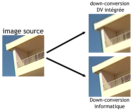

"going HD>standard def produces a lower grade quality"
Definitely yes, because this is poorly done in the camera.
why ? because this must be done real time with very limited processing power.
If you want a good conversion, capture into a computer and do the conversion with a decent converter.
shot from a PDW-330 XDCAM HD and top picture converted by camera, bottom by computer
