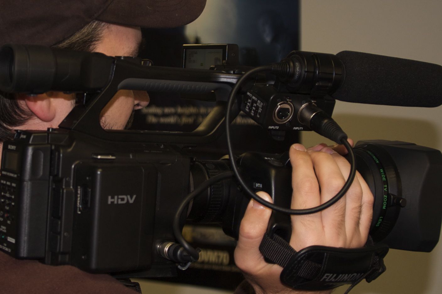

The Fujinon 13x3.5 works very well on the Z7 (and I'm sure would be the lens of choice on the Z270.) The lens just plugs into the lens port on the side of the camera and you are ready to go.
I found that I had to release the mic cable to give me some more room for my fingers on the zoom rocker. Also, it would seem impractical to attempt to use this lens in a shoulder mount configuration without some sort of 3rd party support. The LCD flip out doesn't really work as an EVF replacement.

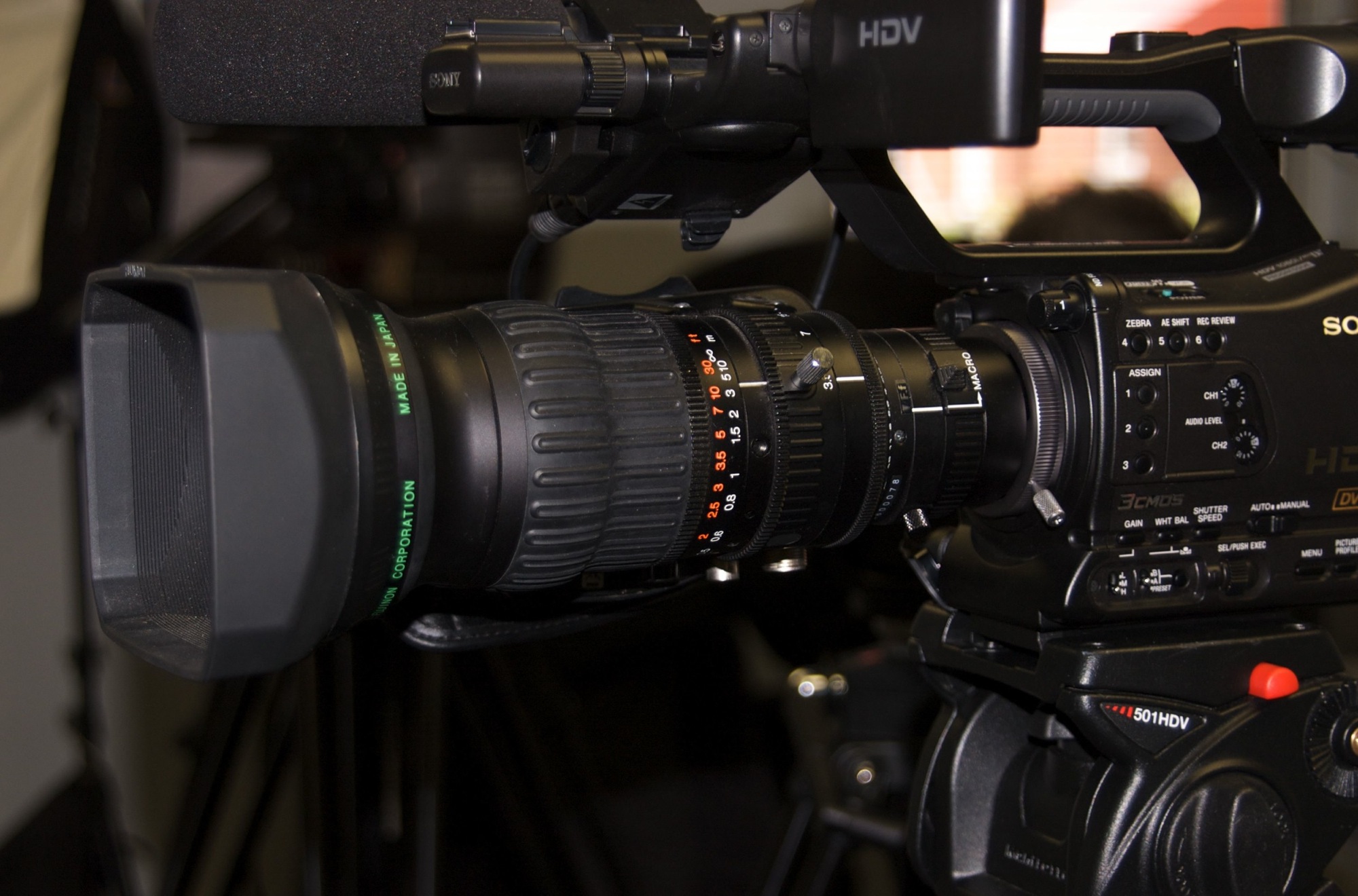

You can connect any external monitor you want. The camera can output a signal from composite, component or HDMI connectors.
My complaint was that the camera cannot output a HD signal to the HDMI connector while simultaneously outputting a downconverted NTSC signal to the analog connectors. The analog out turns off the moment you plug in the HDMI cable.
This means that the monitors must either be all HD or all SD and loop through each other from a single output (or you could do both HD and SD with a 3rd party downconverter.)
BTW, I've attached a better angle on the Fujinon 13x3.5BRMU zoom lens.

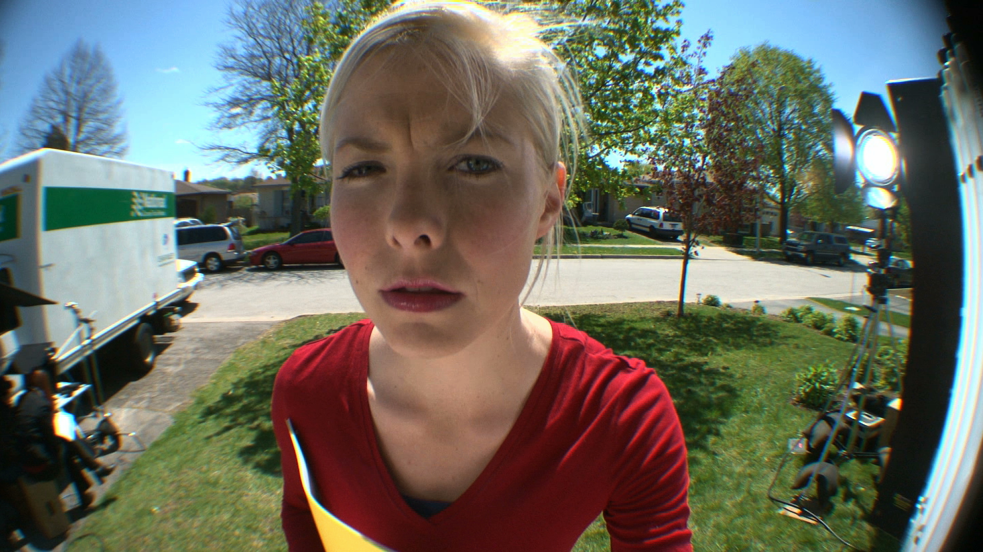

Has anybody tried any fish eye type lenses with the Z7. I'm interested in getting those styles of shots but not sure where to start.
I have used a 3.5mm PL lens with the HZ-CA13U PL adapter with almost 170 degrees angle of view. It is great for a peephole effect (of course the lights and crew in my example will get matted out.)
does the black circles from the corners show up on the tv much?

You mean the vignetting Kevin? Pretty much all of it on modern flat-panel TVs as they show no overscanning at all from DVD through HDMI.
