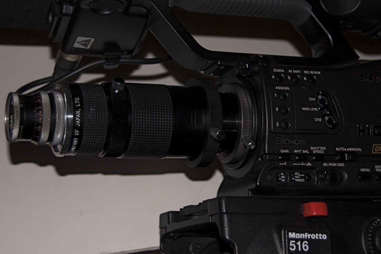

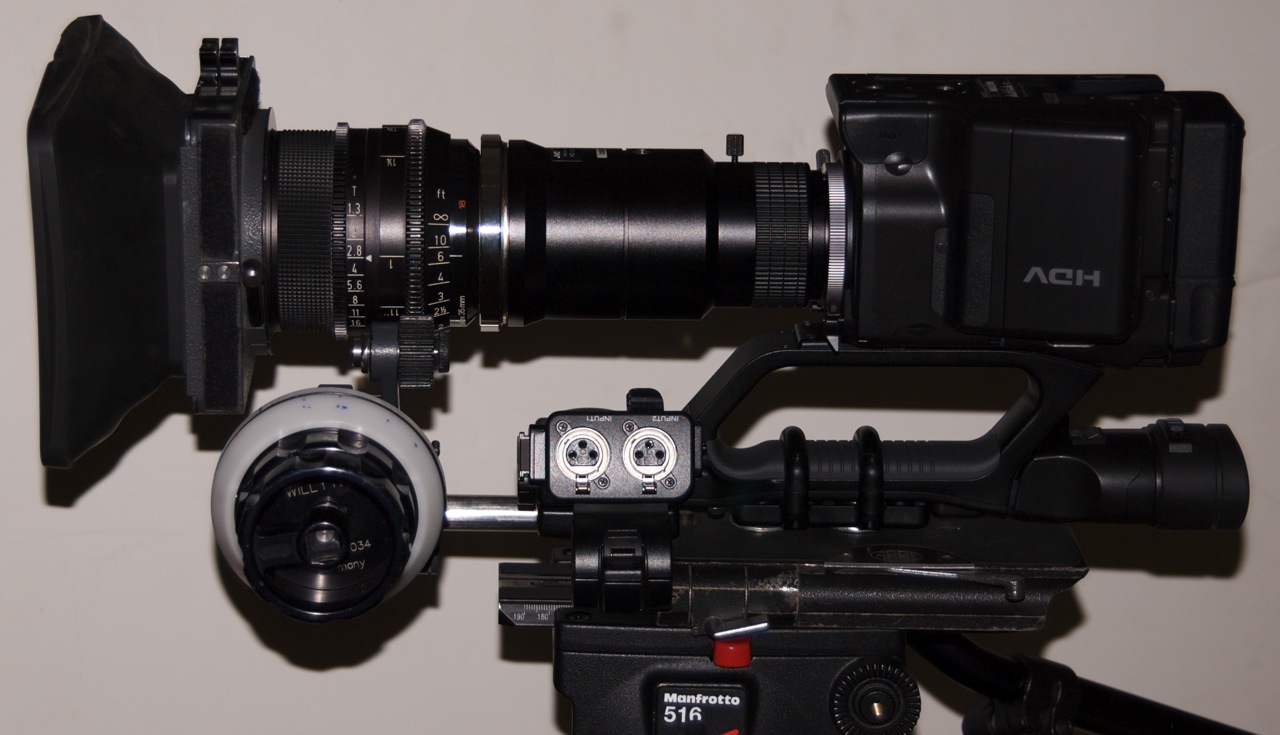

Any 1/3" lens designed for the JVC ProHD line of cameras will work, this includes the Fujinon 17x5 or 13x3.5 wide angle zoom.
You can also purchase the ACM-17 1/3" to 2/3" adapter and use 2/3" lenses or other adapters. Fujinon also makes a 1/3" to 1/2" adapter that I believe is called the ACM-12.
Other alternatives include JVC's HZ-CA13U PL mount adapter which I used with great success this past weekend (in conjunction with VFGadgets' handle bracket so the Z7 could be mounted upside down) and then there is also the P+S mini35 with 1/3" mount relay lens.
There are also a couple of Nikon mount to 1/3" bayonet adapters available for using Nikon F lenses.
Loads of options!
I've attached a couple photos with the HZ-CA13U PL mount adapter (camera must be mounted upside down) and the HZ-CA23U C-mount adapter with ACM-17.
What Alternative lenses?-z7_c-mount.jpg   What Alternative lenses?-z7_pl_mount.jpg

Awesome, finally someone used that JVC PL mount adapter. By chance, any stills or video to show how the footage turned out?
Coming soon...just need releases from the producers.
Tim Dashwood
How'd that go? The test material I've seen posted using the hd200 with the plmount adapter looked absolutely fantstic. What lens did you use? Can't wait to see the z7 footage.
Greg Hartzell is offline   Reply With Quote
Old May 19th, 2008, 07:00 PM   #8
Location: Toronto, ON, Canada
Posts: 3,637
I'll write up a full review for dvinfo soon.
The prime lenses I rented were 16mm format 3.5mm (fisheye for peephole gag) & 8mm for wide establishing shots. The prime kit also had 35mm format Zeiss T1.3 18mm (my "go-to" lens for the shoot) a 35mm and an 85mm. My ACs would set the backfocus with the 85mm at the top of the day and then we'd be golden for all the other lenses.
As for the Z7 I was impressed with the range of adjustment available, especially with the knee levels and shape option. I also really liked the histogram and "electronic bubble level."
The biggest cons for me were lack of 180 degree image inversion in camera or even in the viewfinder, lack of 144 degree shutter angle (for 60Hz), inability to output HDMI 1080p and a downconverted signal to the composite out simultaneously (which meant I couldn't use the small NTSC camera mount monitor I had) and very disappointing mpeg2 compression on fast movement (a candied-glass vase breaking over someone's head.)
The CF card system performed well but I wish it had an indicator in the viewfinder for time remaining. It is sometimes very difficult to read the LCD display on the CF recorder in the bright sunlight.
The files imported easily into FCP6.0.3 but I'm sure glad we had tape backups because a card filled up during a good take.
Tim Dashwood
