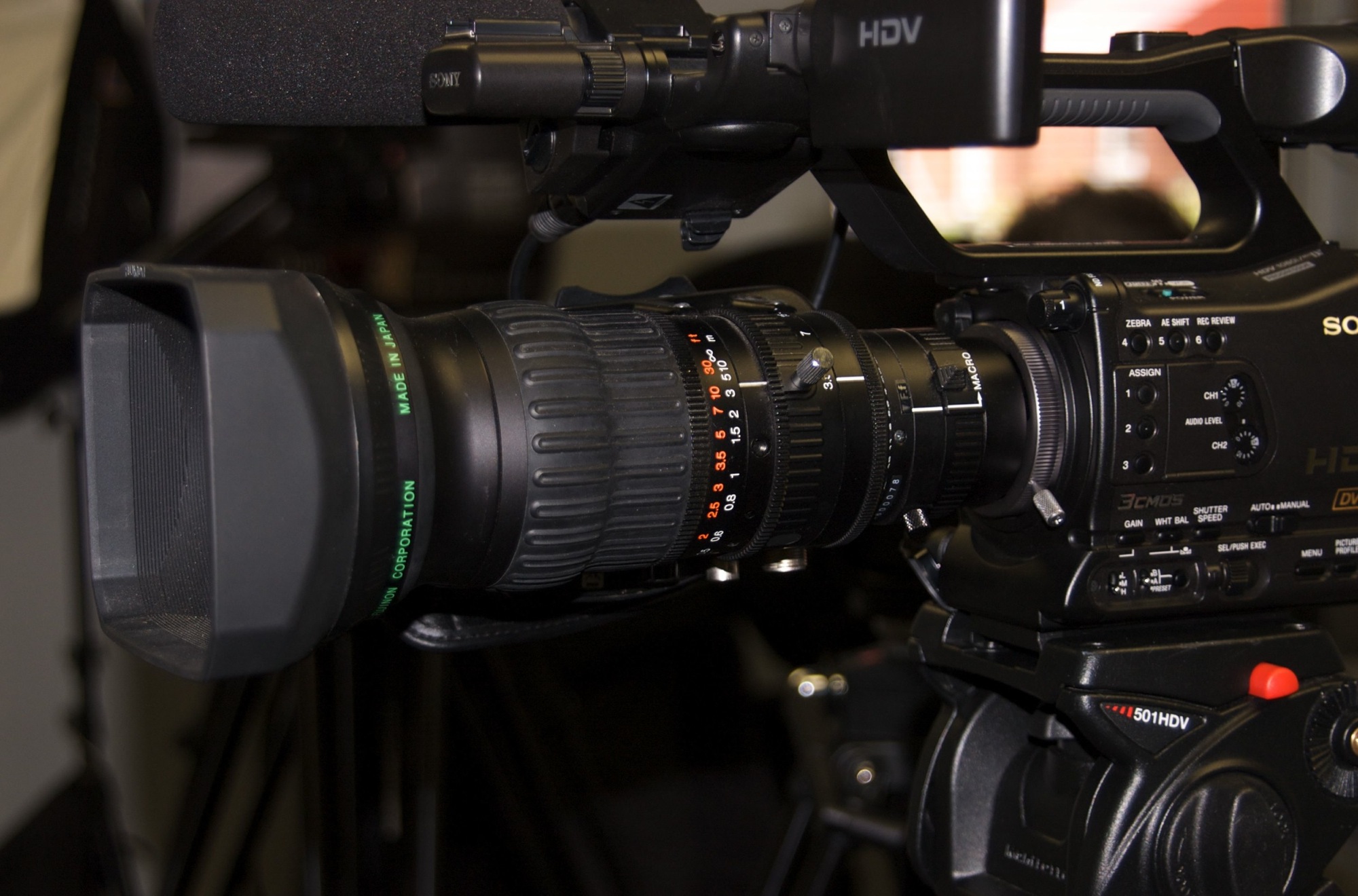

I can confirm that Fujinon lenses do work full servo. I've even used the Fuji 13x3.5BRM on the Z7 without any issues. Sorry I don't have a Canon lens to test.
Attachment 7719
