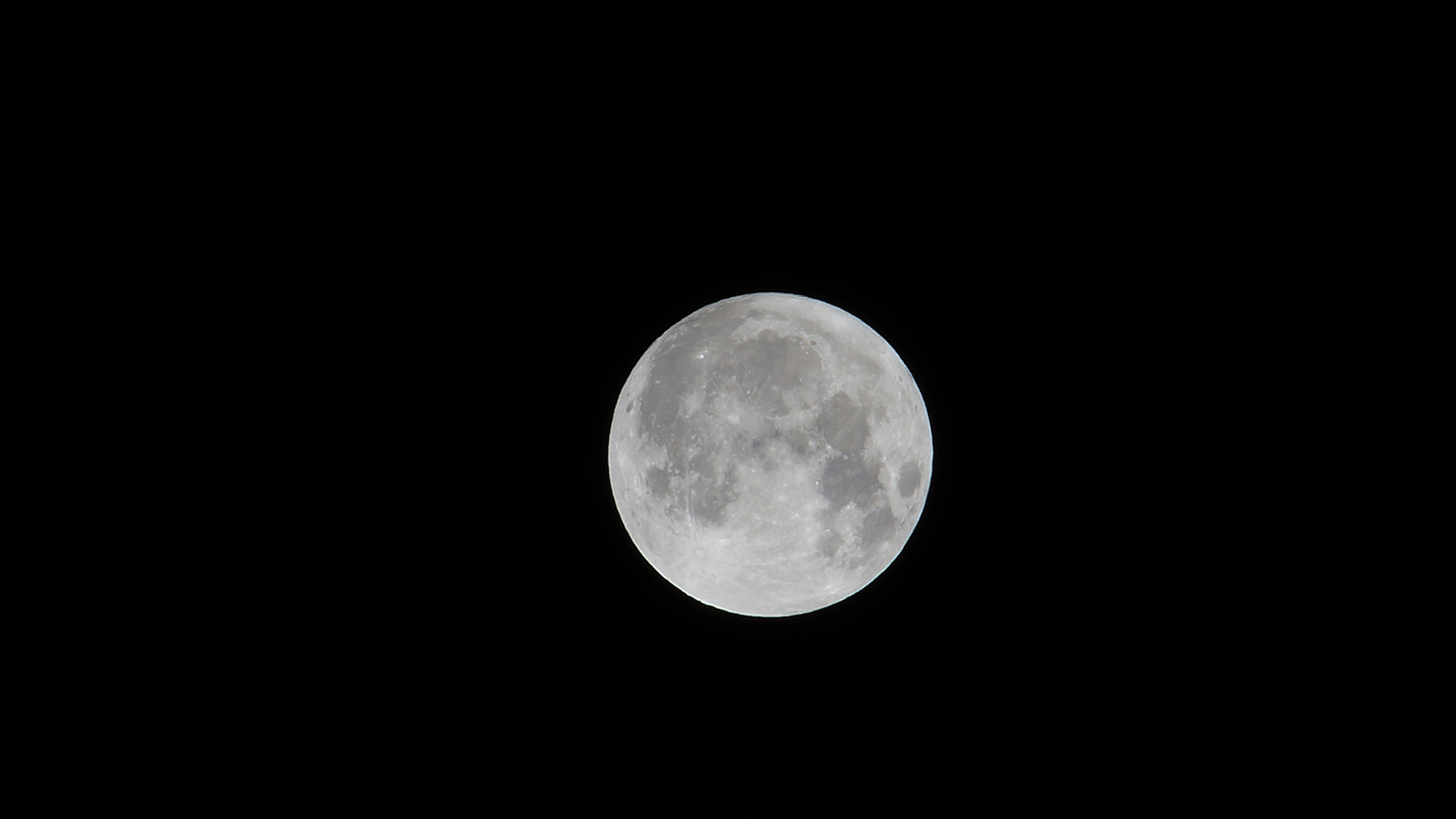

Attached is a 300mm DXed shot of the moon (2 X 300mm = 600mm) reduced from a 16mb still. AHAIK, there is no real artifacts in the pix.
Robert Moran is offline   Reply With Quote

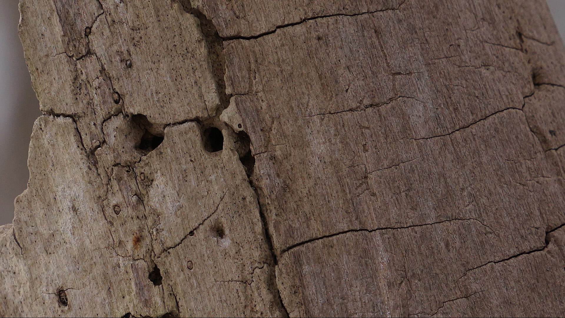

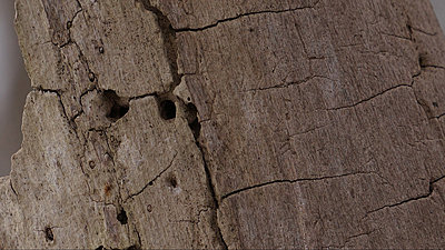

Here's another of a dead tree using the kit lens and DZ to the max.
