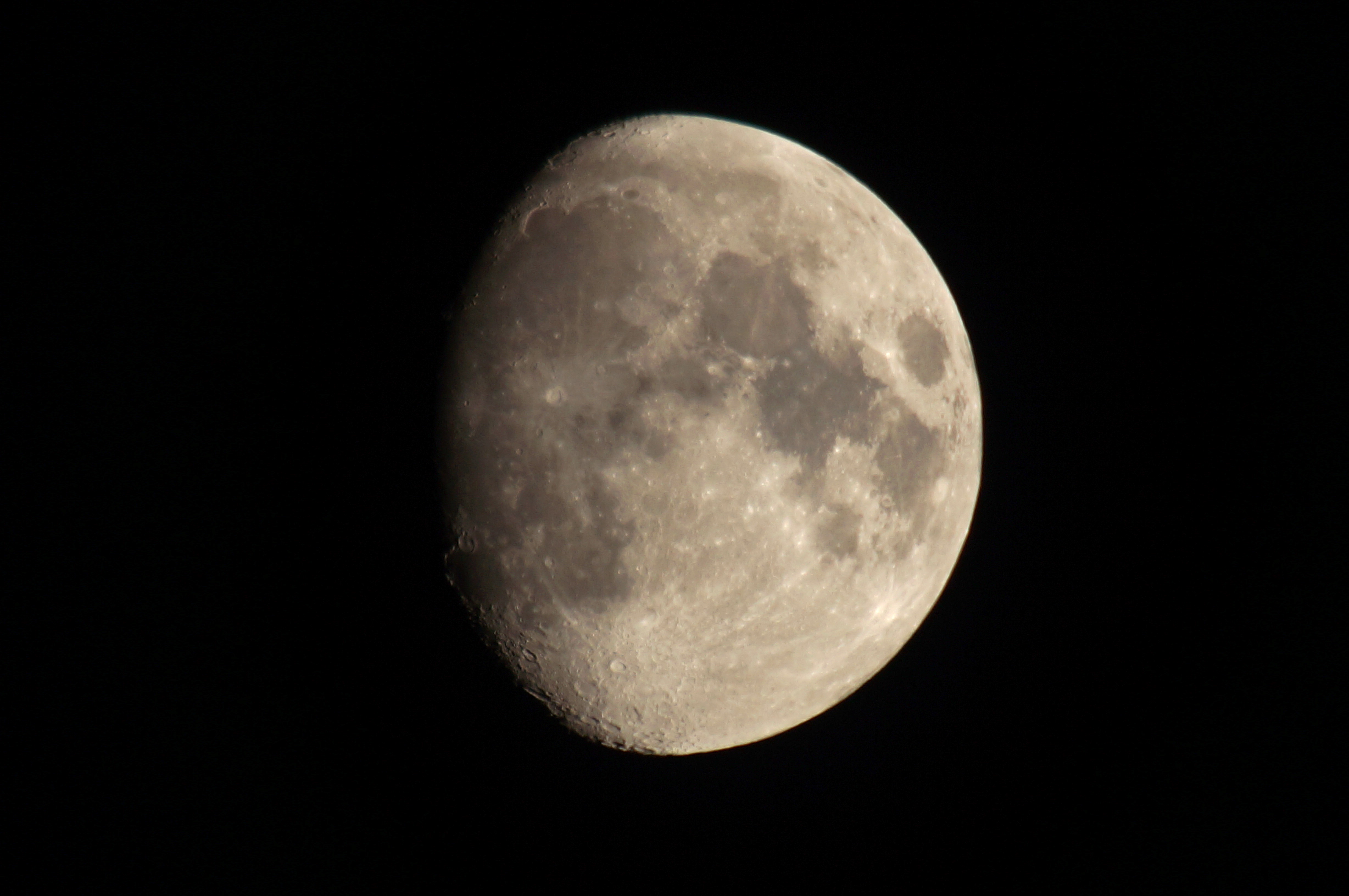

By all rights this photo should be as soft as you could ever imagine. I put more stuff in front of the processor than you ever should. I was testing a new metabones adapter last night. This is an unsharpened still.
EA50 / at 2X digital zoom, metabones EF to EX adapter, Canon 2X optical doubler, Canon lens at 350MM = 2800MM x 1.5 = 4200MM
Could my math possibly be correct? That seems outrageous. And of course, there is 250,000 miles of compressed atmosphere between me and the subject. I think it turned out OK.
But to answer your question, I am in the "no average client is going to notice the 2X digital degradation" camp. It is a great tool to have available.
