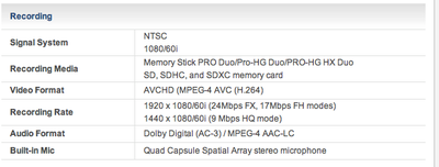

Old December 10th, 2010, 06:02 PM   #24
Location: Boca Raton, FL
Posts: 3,014
Dear god, another person who doesn't know anything about the VG10!
It shoots PROGRESSIVE VIDEO. It always has, either 25p or 30p.
These comments are so like the owners of Beta-SP when Sony released the first DV camcorder. It hurts when you see your investments going down the drain. :)
You are right about it storing in 25p and 30p but you are wrong to put me in the Beta-SP box. I looked at this camera and many others a few months ago when it hit the scene. It's hard to keep track of them all but I did check B&H. Attached is what they listed. Neither Signal system nor Recording rate specify it lays it down in 25p or 30p.
But just now I took the time and went back to a review I'd read in HD warrior and noticed this:
"The first thing that has confused me is the 1080 50i now for all intent and purposes this camcorder records 1080 50i but that is capturing at 25p and wrapping it as 50i why…Confused ? Well, you’re not the only one. In brief, what’s going on is "
I don't mind the correction but I do mind the manner in which you did it. Here's the article:
HD Warrior Blog Archiv SONY NEX-VG10 Conclusions
