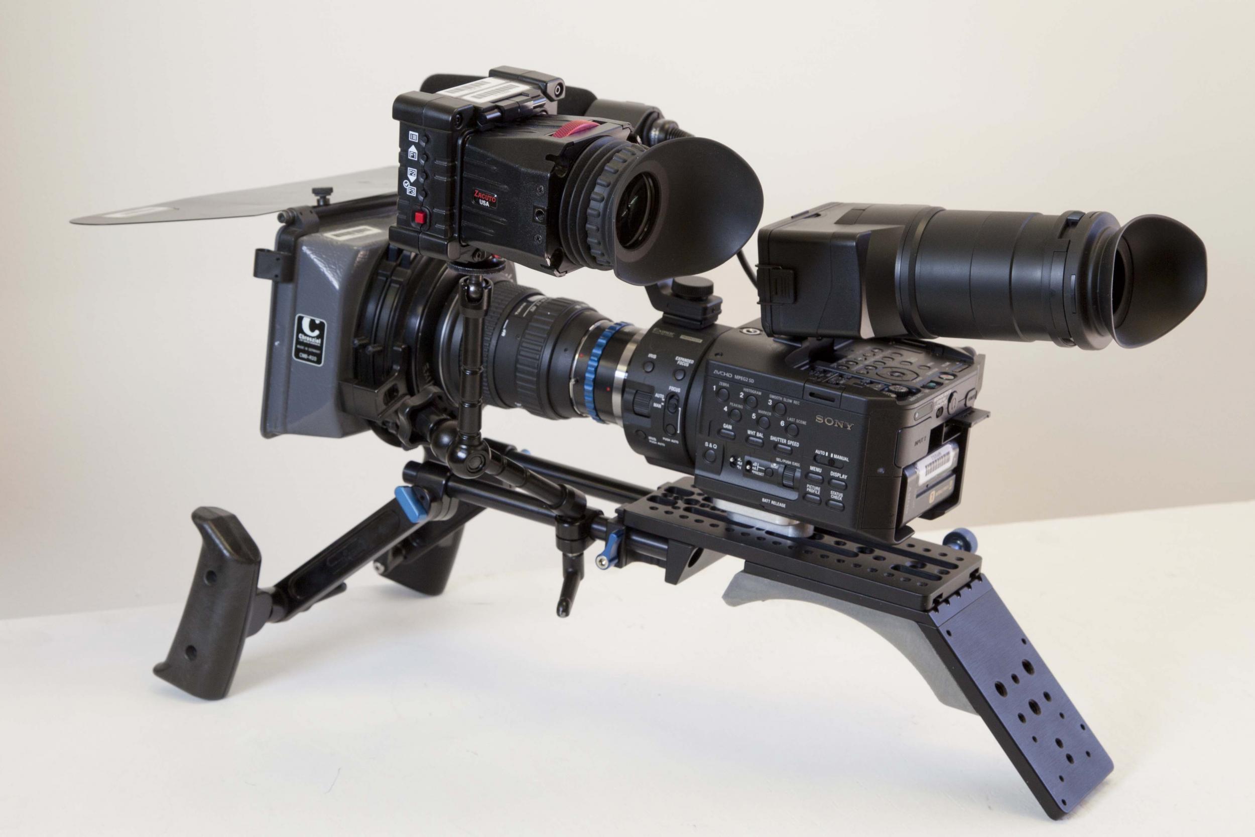

Bruce, I have been thinking a long time on how to do exactly what you are talking about. I have looked at the one Doug Jensen posted about, but the all need a EVF to work as a shoulder rig. I have seen the one the Denny( I think that's his name) use from Zucto. The real question is what kind of lens are you using. The kit lens and most zoom lens would limit you from using a mattebox, so you could use a rail without the mattebox. But the way they made the viewfinder you have to have another way to view the picture. I am trying to save up for http://www.bhphotovideo.com/c/product/582764-REG/Sony_SAL1635Z_SAL_1635Z_16_35mm_f_2_8_ZA.html It has internal focusing and zooming so that I could use a my mattebox. Here is my rig I put together for my NX5 to make it a shoulder rig and stuck the FS100 to give you some ideas. I also used my multirig spring pod on this rig to.

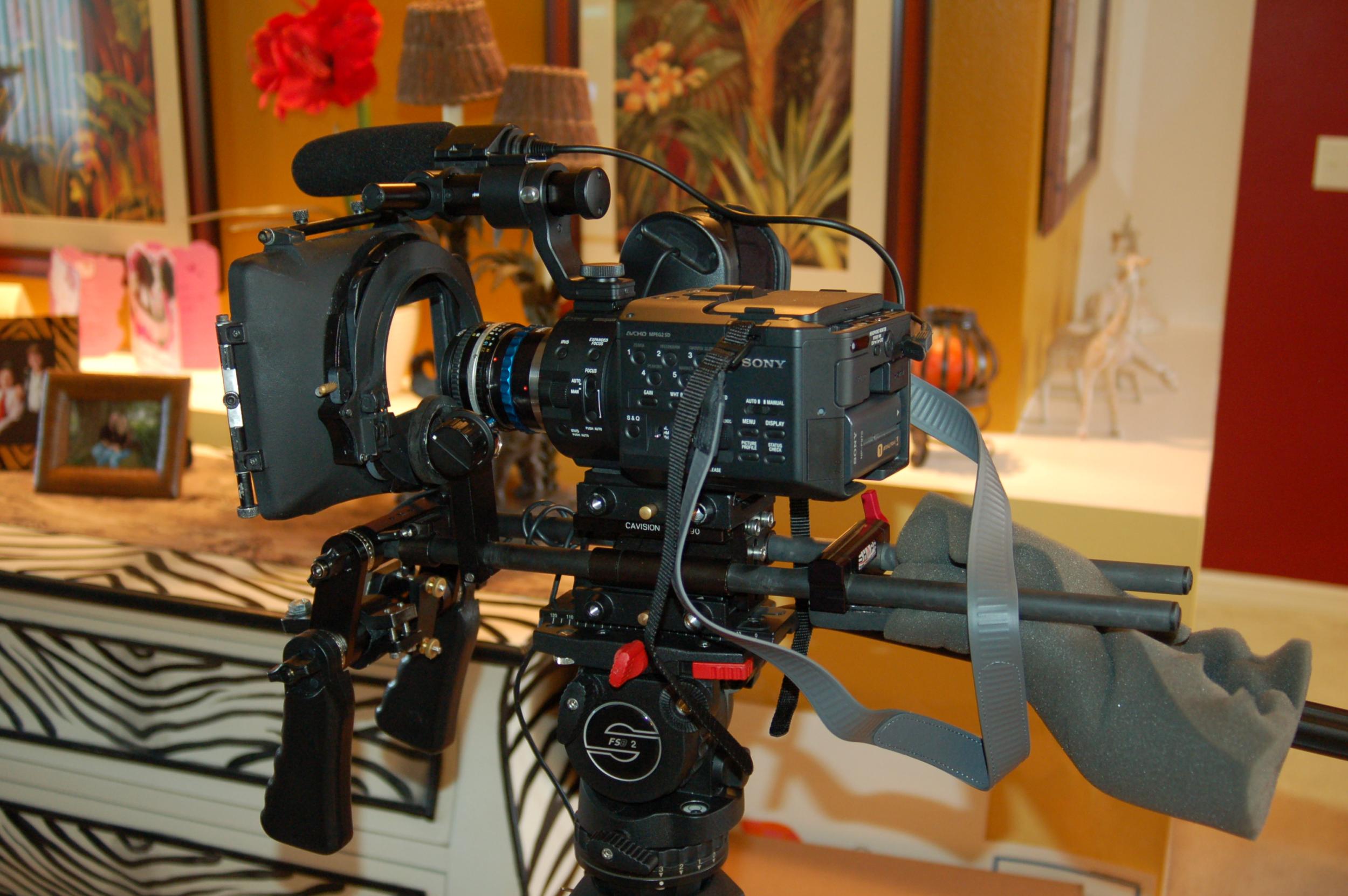

I would get some kind of rail system like this http://www.bhphotovideo.com/c/product/335222-REG/Cavision_RS_15IIM_RS_15IIM_Rod_Support_System.html with a 12inc. rods and get a slide on shoulder pad and mount some weight on the back for counter the weight of the FS100. I think any arm would work with all the mounts this camera has. Here is the guy how help design the the FS100 rig.

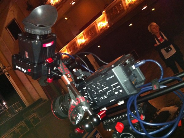

I rented a camera from www.joesutherland.com here in Toronto and found Joe's solution to be very useful. He has several cameras with zoom lenses with Zacuto EVFs mounted on a SA tripod mount. This mount allows you to add accessories such as a battery and additional recorder for backup. The mount is well made as I have one on another camera.
A photo tells the whole story.

That looks great. I see there is the Novoflex mount that I have, what was the nikon lens range? Do you happen to know what the length of the Israel arm is? The arm and EVF is the only thing I lack to make mine a shoulder mount, so I want to make the right choice before I buy.
