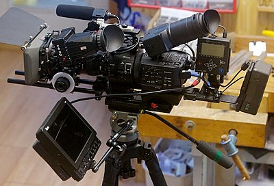

I got some of the right plugs and just tried it.
I can now supply IDX (V-mount) and AB (GoldMount) plates and cabling that work great with the FS700. So you can use existing brick batteries.
So I will have the AB and IDX power kits available for ordering on my WEBstore by the end of the week. These will also be able to power NanoFlash and/or EVF and still have an open D-tap for an on camera light.
The kits will also help balance the camera for shouldering.
If you need one asap contact me direct.
Here are a couple photos of a kitted out 700 including IDX plate.

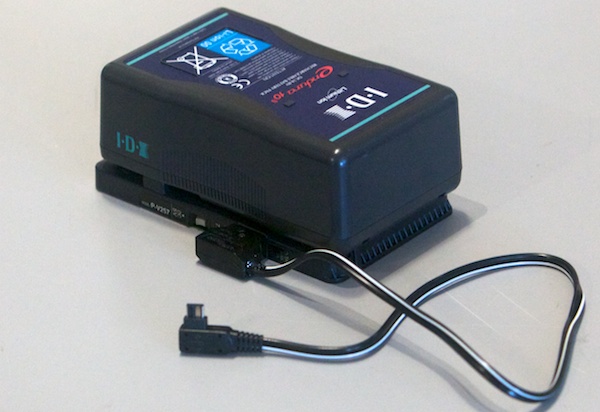

I just ordered a batch of those jacks, so I will have finished cabling by the end of the week.
Here is a photo of the IDX version using the 7.3v D-tap on the IDX plate. There is also a 12-18v Dtap on the plate.
I will have a few different solutions for mounting the plate to the 700, I will post photos of that soon.
The AB version will simply be a cable coming out of the Gold-Plate with the correct power for the 700.
If you want to just order the cable I can supply those as well if you already have a Gold-plate wit 7.3-7.8v battery adapter and want to do your own conversion. Or you can send me your plate and I will do the soldering for you.
Contact me direct if you are in a rush. I should have all the options on my WEBstore by the end of the week.
