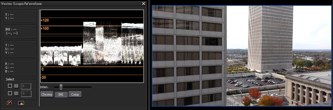

That's the video I downloaded, here is a screenshot of the Edius waveform meter where I see the sky is clipped sharply at 109 IRE.
Ron, not only AVCHD format records super whites, MPEGII format was just the same on my old Sony V1E and also with my current cam the EX1R. It's the camera that decides what to do with overdone highlights, compress them or not. If the camera has an adjustable knee setting in it's gamma curve then it can roll off the exposure at the top end of the scale. I was hoping the RX10 might have something similar, I will of course keep an open mind but there is so much unknown about the inner workings right now.
For instance how does the internal ND work? Because it's internal I read suggestions it may simply be an electronic attenuator following the sensor, how about that, oh and it was proved to be effective, wow...
Just one thing, has anyone noticed in the full quality download video the power lines appear to be broken into little pieces? Similar to watching fields instead of frames. You need to see the fully zoomed up part, I saw it on Edius computer screen and put it down to scaling artifacts but it's still there out onto my Panasonic HDTV. Perhaps US power cables are not smooth? Not sure about this, is it just me seeing it? If not, maybe it's because instead of line dropping from the sensor this cam re-samples the whole lot and it's "interpolation" effects?

Yes Claire I know that other cameras and formats expose super white but was just referring to RX10 and AVCHD. Applying AE shift to my cameras that do not have independent knee controls seems to solve this problem and even my NX5U used this way is better.
I am downloading the original to see if I can see the power line issue you noticed.

Old November 11th, 2013, 07:56 AM   #34

I can see the power line issue too in Edius and Vegas 12. Not really visible when played but definitely there when stopped on a frame.

Thanks for checking this Ron, I see it in motion (60P) on a 32" screen as a vertical dither or "trembling" just on these cables , not to be confused with the camera shake. BTW the WD Live TV Hub will also display 60P if you have one.
I do suspect this is likely to be an effect from the downscaling in the camera. It must be a fast processor indeed to manage this in real time at 60P and remain very good quality, Maybe better this than simply skipping lines from the sensor.

As Ron mentions, Sonys overexpose in many situations, easily rectified by EV - adjustment. Doesn't worry me for one second, my thumb is already "muscle trained" from shooting HX series cams! VERY easy to adjust the cameras "intelligent" auto to reflect a bias towards a "better" exposure when needed - I think they try to retain shadow detail vs. highlight detail, where I would lean the other direction in "most" cases...
I'd observe that that sample looks like many a "hazy" day - not sure where it was shot, but many cities have smog/haze that looks just like that in real life - it's not "blown out", it's just this "stuff" hanging in the air! The joys of living in a city, where you get to chew your air!
There is significant "handheld" camera bounce at full zoom, and when I paused, most of the time the wires looked pretty good as "stills" - when "rolling", I saw what could have been camera 'bounce", OR quite possibly atmospheric distortion - at that distance if there was any heat coming off of nearby concrete/asphalt surfaces, the wires could well have appeared "wavy" and distorted - I had this recently while shooting aircraft taking off - at the far end of the runway, there was HUGE distortion from ground heat waves "shimmering", when zoomed!
I would be more focused on the apparently fine detail on the nearby buildings than by a distant object at high zoom... Half the fun of having high zoom is being able to shoot at great distances, but as a practical matter, you have to expect stabilization to be pushed to, or past, it's limits, and that there is a strong possibility of atmospheric distortion between you and the "target". Heat, moisture, dust, haze, smog... all can drastically reduce effective "visibility", even if you have optics capable of resolving at long distances and a stable platform!
