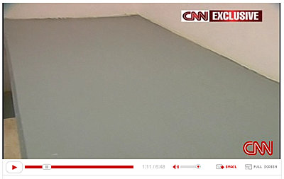

How to spot who's using EX1
I saw this shot on CNN. Look at upper left and right corners. Vignette issue is more severe on upper left.
BTW I'm seeing this on some of the HD channels (Voom channels) from my Cable service.
Either there's another camera on the market with this issue or you can see who's using the EX1 and haven't gotten them repaired/replaced. It kinda makes you think how many are out there with this and other issues that simply go into service and NEVER get checked.

Good eye.
It's pretty much a perfect shot for seeing the vignetting problem.
I'm not sure CNN should be so proud of that exclusive - it's a pretty boring shot!

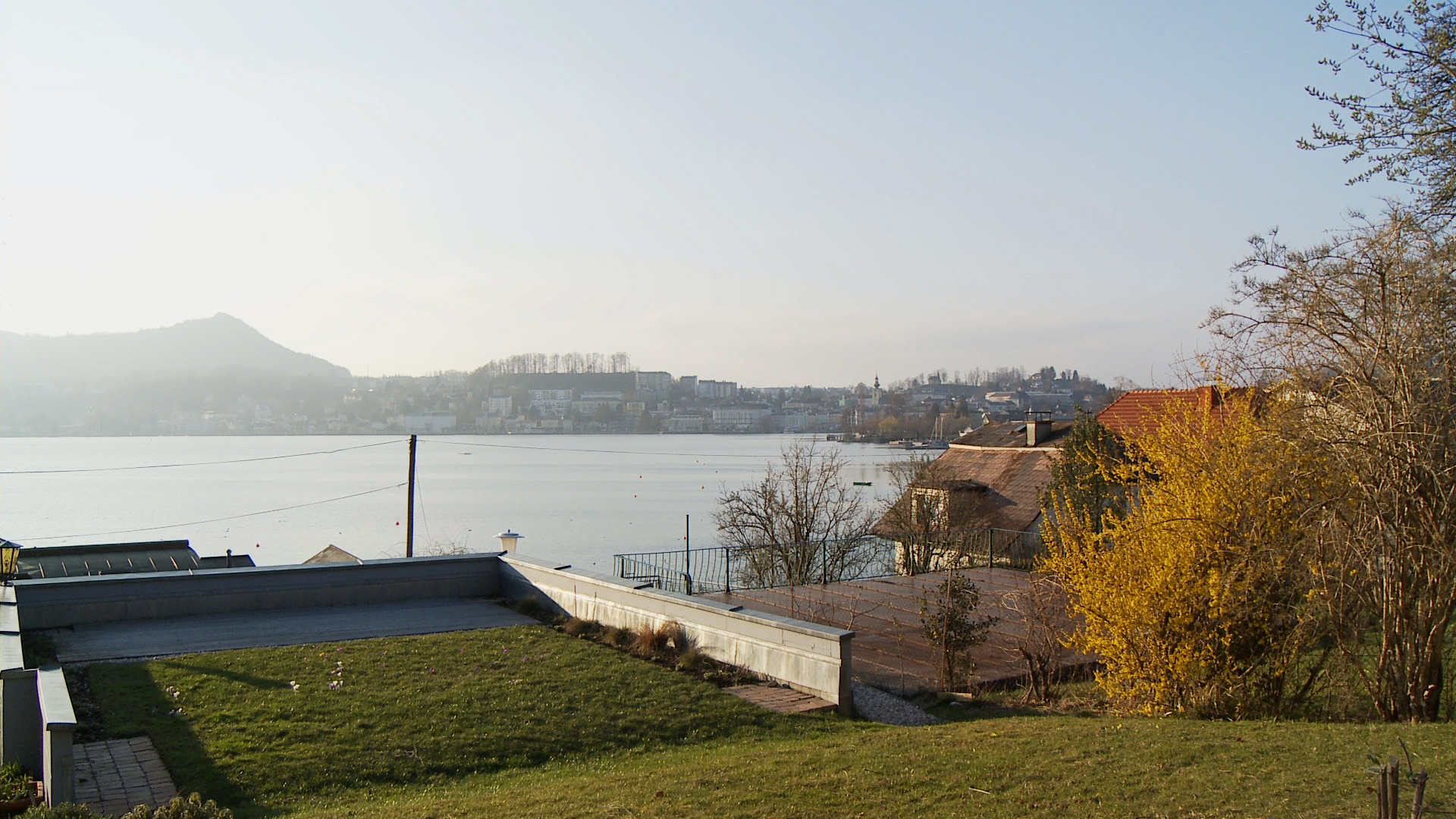

Paul, your result looks real sharp.

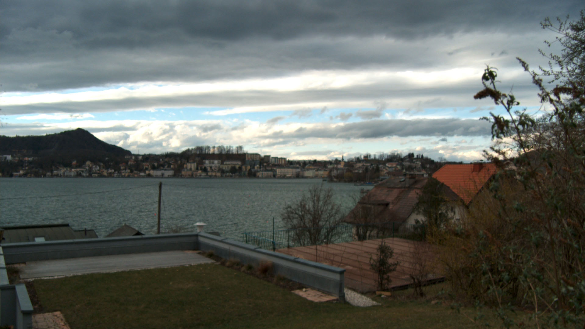

one shot was done a couple of weeks ago (the darker one) - second one 15 minutes ago with same settings. (light is very different though and its pretty hazy today)
Yours look sharp to me - I think you fixed it.

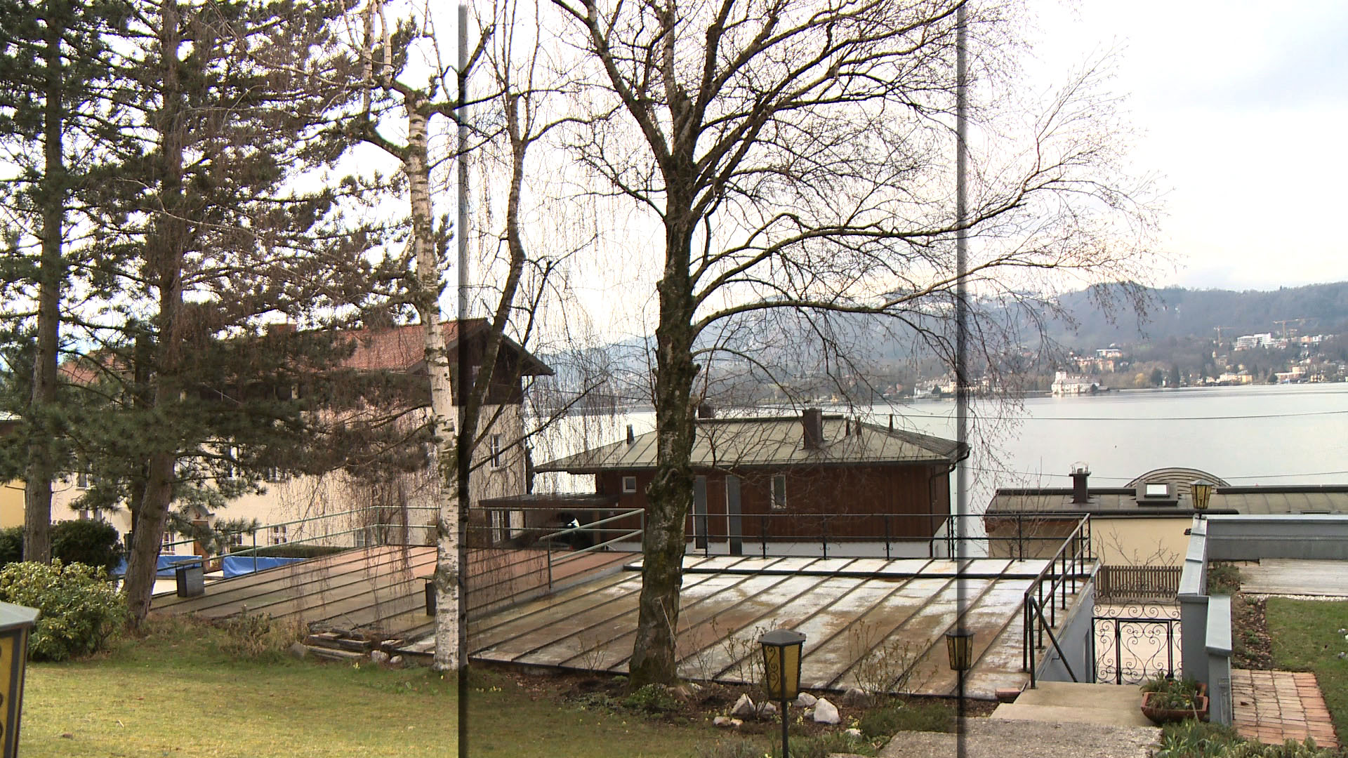

Here is a split screen image with ND off/ND1/ND2 after adjustment. Everything is in manual mode.
Focus is near infinity, f1,9 - shutter speed varies from 1/2000 to 1/50. Detail off.
Itīs been a little too bright to match ND off correctly though:

Posts: 1,896
Gerald,
That looks real sharp man!
You fixed it!
Dang, hmmmm... Maybe I should look closer at mine. Your wide shots may be even a tad sharper than mine. I'll need to check mine closer.
It's hard to believe that was with DETAIL OFF. This is the first camera i've seen in this price range still maintain so much detail with enhancement off.
