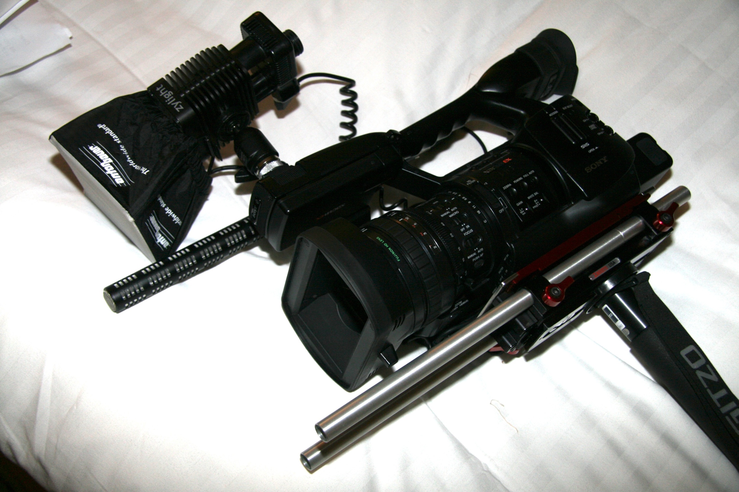

The Anton Bauer Softbox fits perfect on the Zylight, without the plastic adapter plate that Zylight supplies. It is called the Anton-Bauer UL Softbox. I had a Chimera but it was too big so it was returned.
Steve,
Do you have any other pics of how the AB softbox attaches to the Zylight without the plastic adapter? I can't really make it out from that picture or the one on your blog...
I don't know how much the AB one runs, but that Chimera cost a small fortune for what it is...and I hate having to wrangle that ugly adapter plate on and off the light.

The AB has two metal tabs that slip into the fins on the light. Not meant or designed to do so but it works and stays in place.
Thanks for that, Steve. Damn -- it looks like I paid like 60% more for the Chimera, direct from Zylight, than it would have cost for the apparently more convenient A/B model...
If you don't mind another question, is the AB softbox rectangular or square, and if rectangular -- which way does it end up when you clip it to the Zylight fins?
