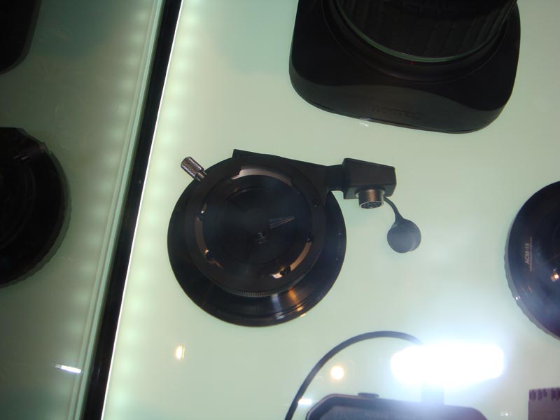

There will be an adapter from Fujinon that will include the standard lens socket so you will be able to use 2/3 inch cable powered lenses. Don't know when this will be available but there was one on the Sony booth at NAB. Picture of it is attached.
There was also an EX3 with a Canon KH20 1/2" HDgc lens on it on the Canon booth and I have to say the pictures looked really nice with very little CA. On the same display there was an F355 with the same lens and I really struggled to see any difference between the two. The EX3 had a more saturated image and appeared more contrasty but I think this was probably down to camera setup, I suspect the F355 had the stock gamma while the EX3 looked to have a cinegamma and hisat matrix.
