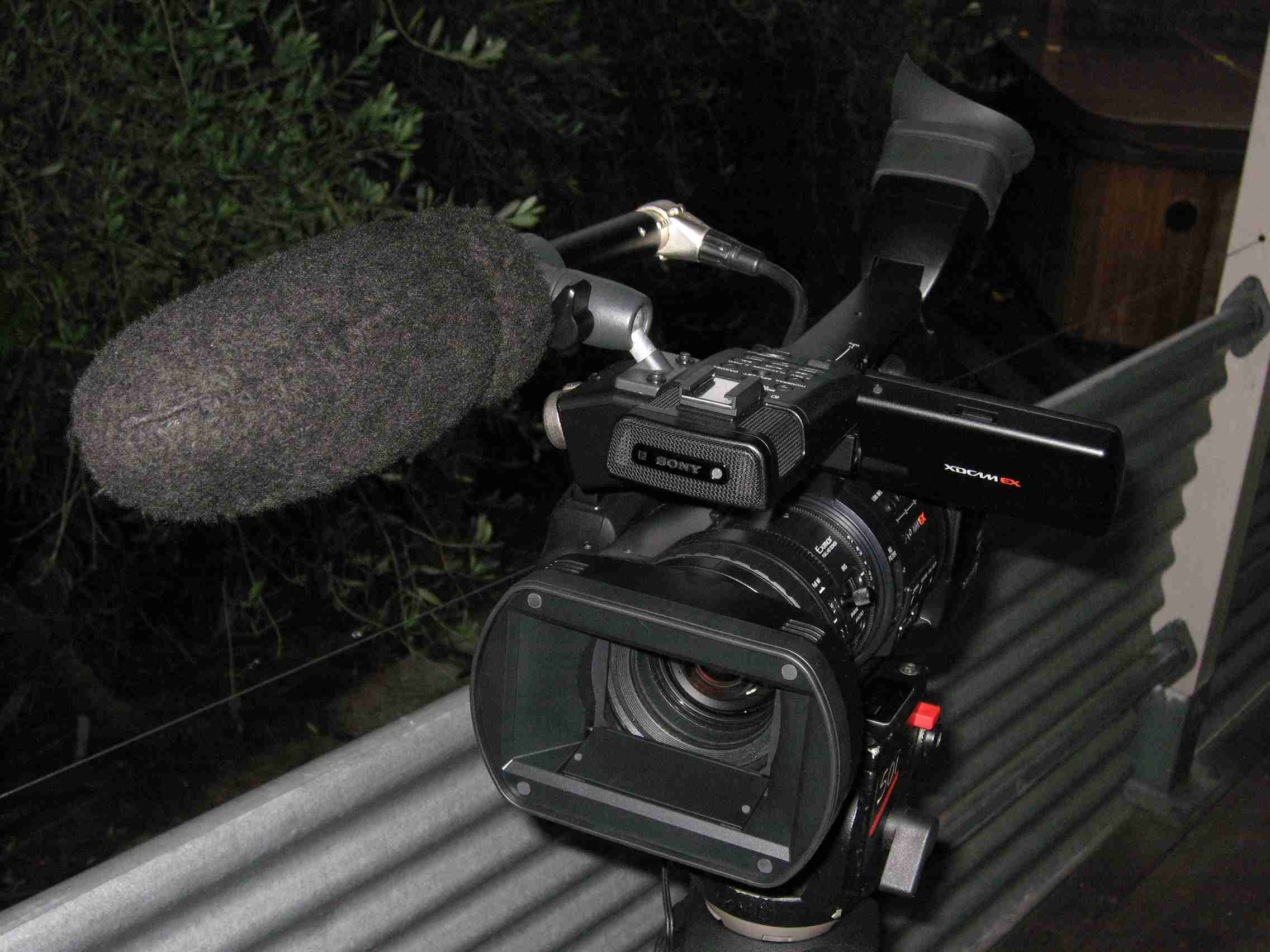

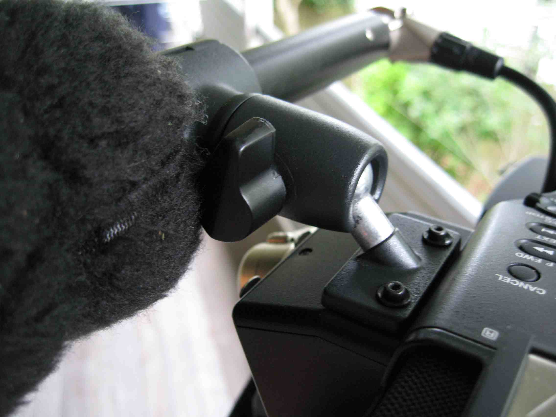

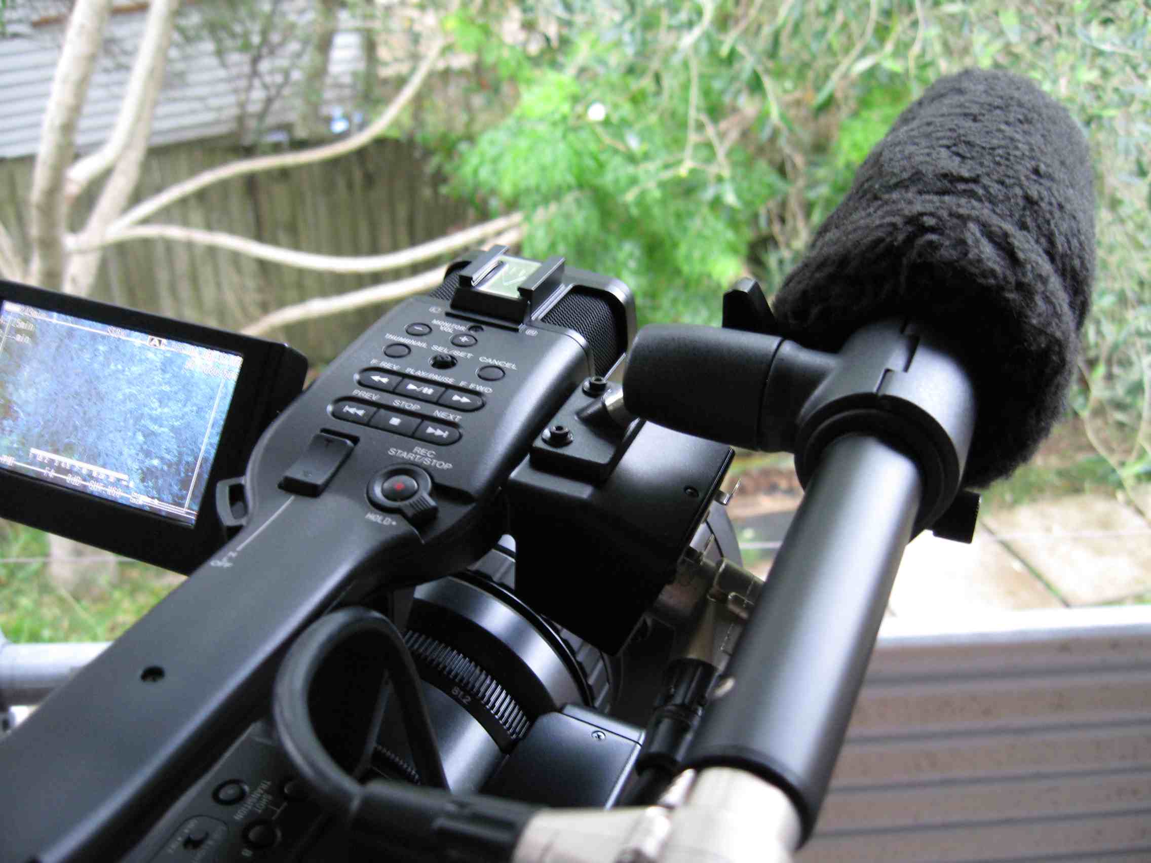

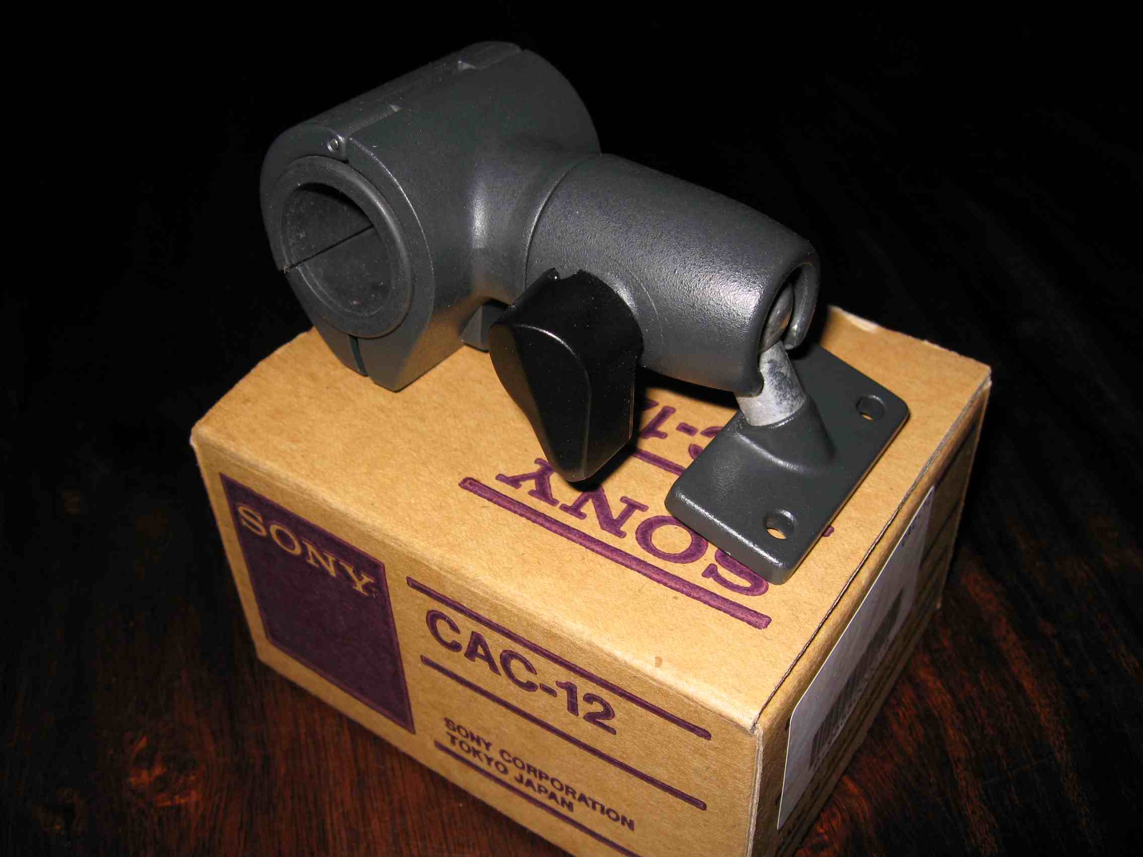

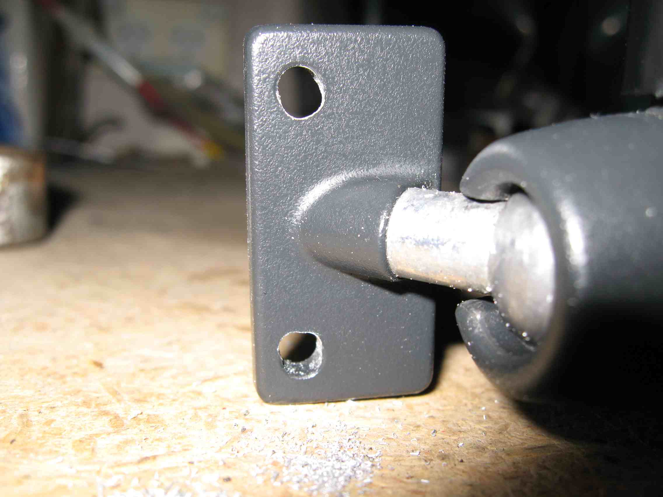

Hi there - Sorry for the late post - Sony's own CAC-12 mic mount fits onto the EX fine - you have to elongate the screw holes slightly and use longer screws but you'll end up with a secure fully adjustable swivel mount. These mounts were originally used on the BVW & DXC series BetaSP cameras but I've fitted them to PD170's and V1P's since them. I think the Sony part No. is 3-750-734-11.
I broke the original mic mount on my second day shooting, bit rough on the gear I guess...
So where exactly did you obtain your degree in metalworking Mal?
Seriously, thanks for that. It's reassured me that there's life after my mic mount (inevitably?) breaks off. I've been dreading it since I first read about the mount being so flimsy.
Another of Sony's economies - but I don't mind, they brought us unbelievable quality images at a really affordable price. I can live with a few bits and pieces falling off as long as I can get great pictures.

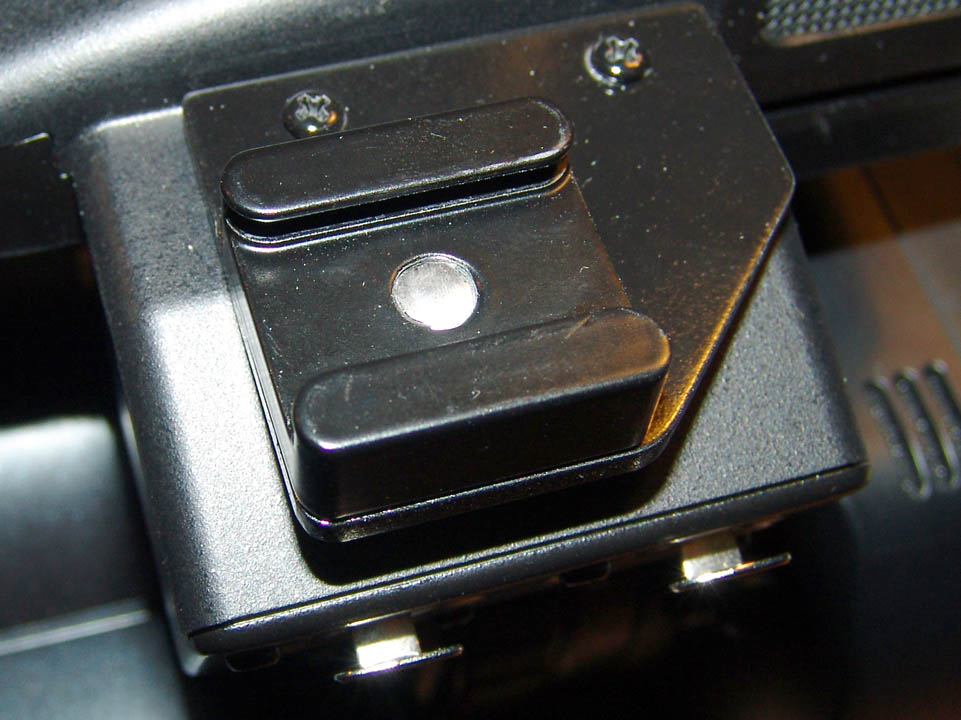

I just got a Sanken CS-1. It needs the K-Tek K-CAM-SSM mount as it is a very short shotgun. I'll use the same plate to hold a cold shoe and mount the K-Tek mount into that.

Originally Posted by John Gilmore View Post
Do you have any images of the finished product?

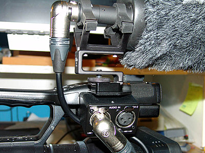

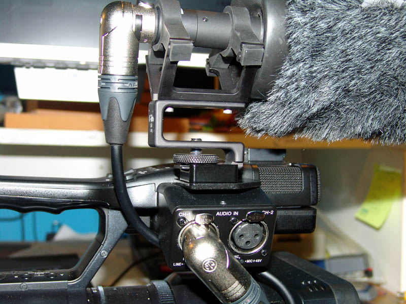

Sure thing, hopefully the pictures explain it all.
The same bracket and cold shoe could also be used to hold the Rode SM3 shock mount if you wanted something a bit cheaper than the K-Tek. The Rode mount is too long for the CS-1 though. To hold my simple bracket onto the audio pod I used M2.5 x 10mm screws, the screws Sony used are barely long enough for the existing mount. They're a little tough to get out as they're secured with Locktite or similar goo.

Bob - You've got the Best solution so far!
Hi Bob,
Your solution to the Ex1's impractical mic holder is genius and exactly the way I wish Sony made their holders to begin with! I wish you sold the part ready made, but since that isn't the case, I would love some extra information on how to make that part. Where did you get the shoe adapter you attached to the metal plate? Any chance you'd be willing to make an extra part like the one you have and sell it to me (and other DVI members)? This is the only solution I want for my EX1 because, as you say, it makes it easy to put the microphone on and off, plus it keeps the top of the camera flush, making it easier to store it in a tight space.
Thanks for your help!

Thanks for the kind words Peirre,
the cold shoe I bought from here:
http://www.dm-accessories.com/shop/i...d22fe1d7a5ec3a
I've already made a couple of units for local people. I think though that Jeff Demaagd would be in a better position than myself to fabricate these and sell them as he already has an online store and he's in the USA. I'll drop him an email.

Hi Bob --
I'm curious how you ended up getting the screws out. I had a cold shoe mount made similar to yours but can't budge the existing screws. I'm hesitant to use a solvent for fear of doing damage.
Michael Rehfield is offline   Reply With Quote

Originally Posted by Michael Rehfield View Post
Hi Bob --
Make certain you have a good screwdriver, not some old thing that's got the blades burred or worn down. Make certain that the screwdriver is a snug fit into the head, any slack and you'll burr the head for certain and then you'll be in trouble.
Press down firmly and turn, the screws will be initially very hard to turn. There is some blue goo on the threads obviously meant to stop the screws working loose which creates a lot of friction in the threads. Once you break the hold that blue goo has the screws will become easier to turn.
