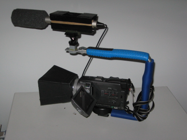

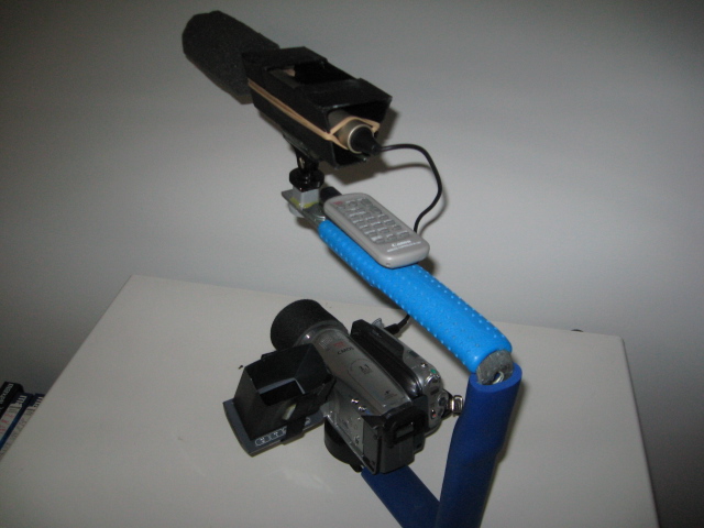

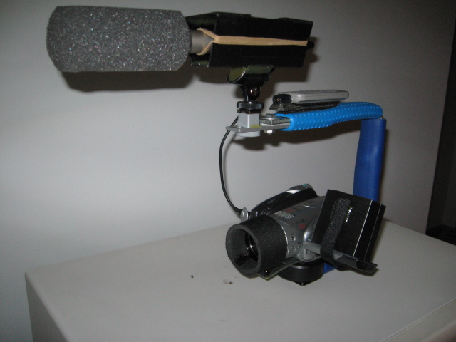

Hi Jonathan,
If you want to save $$$, you might consider making your own.
I've made up two for about $1.50 a piece.
They work well.
Check my posts for other Pics and explanation.
Harold
