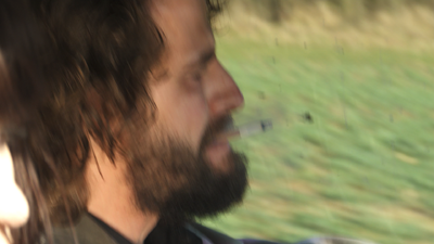

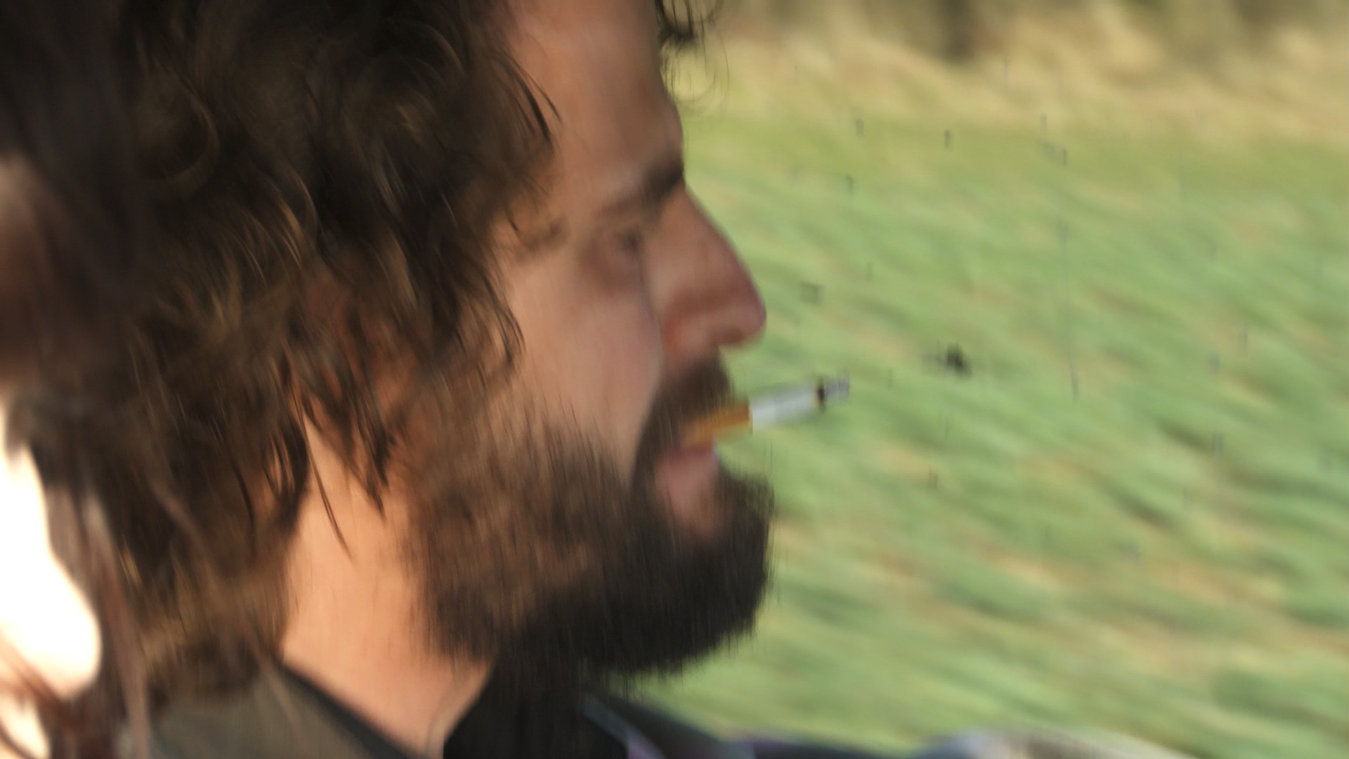

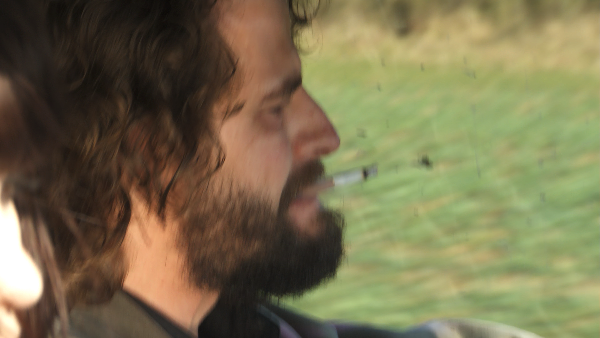

As I said, this is things you can get with the rolling shutter effect when the camera is having a really fast shake.
This is 3 consecutive frames.
This will only happen in special circumstances, but you need to know :)
What about "real" Rolling Shutter problems ?-4-09a-1-1.png   What about "real" Rolling Shutter problems ?-4-09a-1-2.png

The pictures of Sebastien show me, that this it just impossible to use for me at the moment. I have a upcoming Helicopter shot and now I will 100% not do it on a CMOS Camera.
