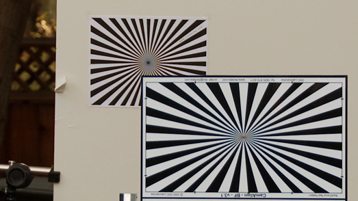

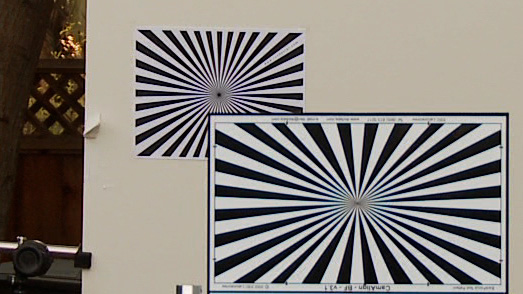

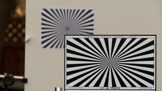

Old January 15th, 2009, 11:45 PM   #24
Location: San Francisco, CA
Posts: 121
Apparent DoF Myth Myth
I did the same experiment as the author of the article cited in a previous post, isolating parts of the image, and it's more than just an apparent illusion. This looks exactly like a changing DoF to me.
And to be clear: the f-stop was held constant as was the sensor size
Shallow Depth of Field without adapter?-bdga0059_01-1.jpg   Shallow Depth of Field without adapter?-bdga0059_01-2.jpg

Yes, I must admit, I was interested but not totally convinced by Walter Graf's article - firstly, if the background is perceived as softer, it IS softer as far as I'm concerned, and in the part where he posted two close ups of a blue ball on a shelf behind the subject to show they were the same - to my eyes the right hand one is clearly softer.

I agree with you guys, however, I think the point Simon was wanting to make is that zoom/tele lenses don't, TECHNICALLY speaking, create a more shallow DOF. It only looks like it. DOF is a very specific phenomenon in the physics of optics that can be calculated. Using a higher zoom factor with the math that describes DOF, will not show a change in DOf
And my point is, that's good enough for me to use a zoom/tele for shallow DOF, if appropriate for the scene.
