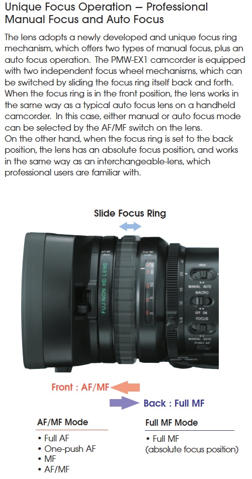

Have you tried pulling the lens so it's in full manual (disengages the servo altogether)? That'll at least let you know if it's in any part mechanical. That info might help Sony trouble shoot this.

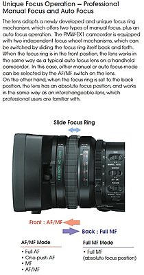

Don't confuse manual with full manual.
Full manual is just that. Pull the focus ring towards you until you hear it click. It's disable all the electronics related to focus. You should then be able to focus manually if there's nothing mechanically broken.

See pic for example.

I have been using the camera for the last 6 weeks or so and had Doug Jensen's Vortex Media DVD for a year before that and became quite familiar with the contols so I did bring it back until I heard the click. I remember reading in one of the threads on the PMW-EX3 "loss of ability to focus" that it is not an actual mechanical connection with the lens but simulates it. The actual problem I have simulates what happened with the PMW-EX3 (in a long thread on this forum) - just wondered if it has happened to other PMW-EX1 owners.

Just found the thread on the PMW-EX3 where it says of the problem: "the issue comes from the camera body. It disengages the servo clutch in the lens so that the ring spins and does not pick up and move the lens elements" - so even in manual mode the camera will not focus properly.

The lens focus is all servo, though zoom and iris have mechanical links to the controls.
