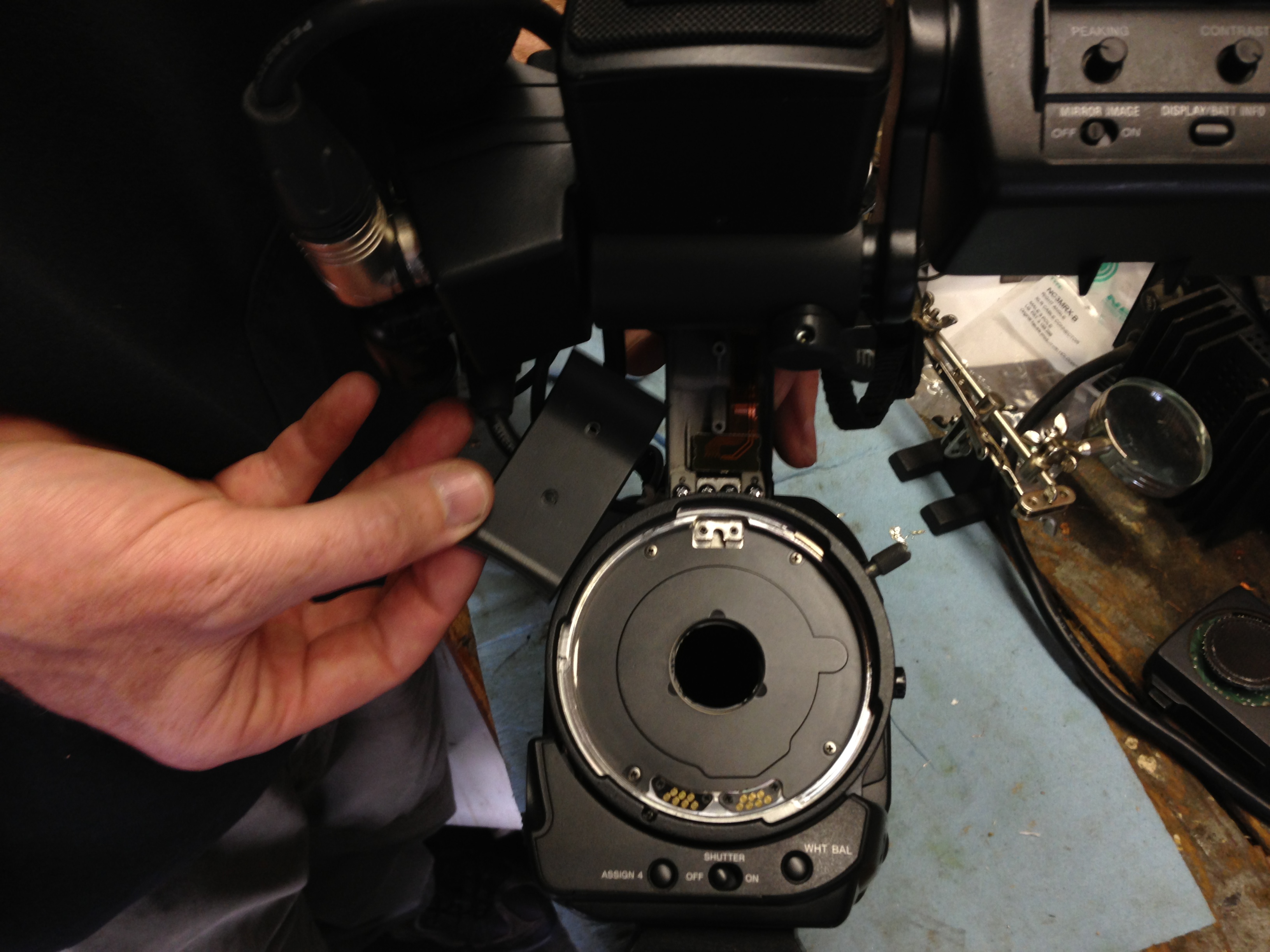

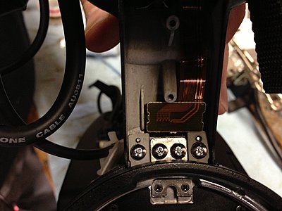

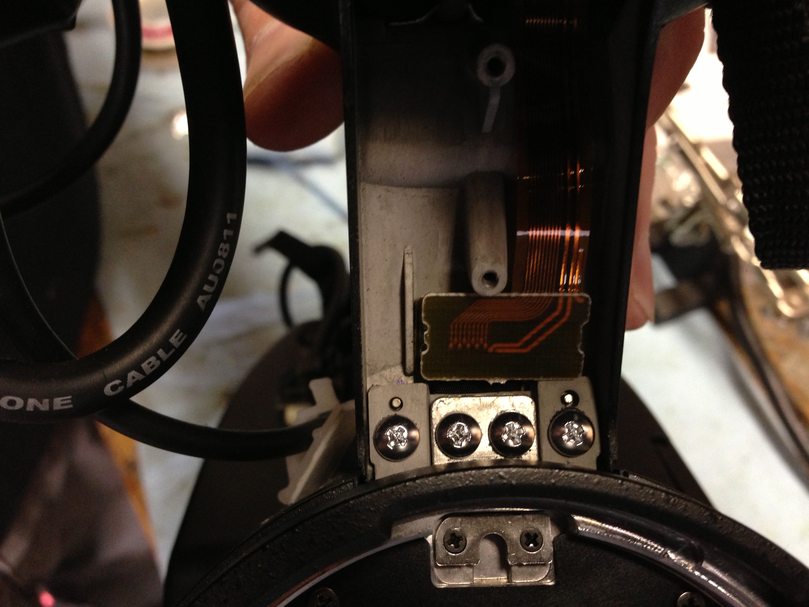

Thanks for the reply's it was as Allister said 2 loose screws under the front plate.

Working with a big Colombian television network this week. Caracol. They brought up an EX3 as a second camera for reverse angles during sit-down interviews.
As you might imagine...the camera is totally beat to hell. Tons of paint worn off the camera body. Lots of "silver" showing.
I think this thing was in a war.
Still shoots well but...the handle was very loose.
Had some time to kill. Did a search here thinking there might be a possible solution. I was not disappointed.
Fixed the handle on their camera thanks to the great photos, plus the usual, reset the back-focus and cleaned it up a bit.
DV Info.net made me a hero with these clients.
Have to say "thanks". Wouldn't have happened without the great group here willing to share and help.
