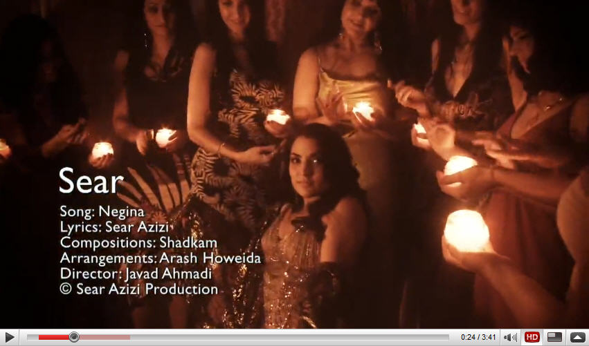

The image quality of the EX cameras is amazing and it's the best value in terms of image quality of any video cameras out there. You can argue all you want about the slight differences in image detail compared to the full size HD cameras but music videos are not about that. It's the look and the feel of the music.
This is a video shot with 2 EX cameras, 5 DJ type of lights and 2 smoke machines in a club. YouTube - Sear Azizi, Negina video (HD version), Directed by Javad Ahmadi
It was not a big budget shoot. I want to give credit to Joesutherland.com for giving me a good deal on the camera rental. You can see the detail in the blacks and the image quality is excellent. ) Db and 3 Db were used in this all day shoot. There are several sites that have this video and they get thousands of hits. Please look at it from a technical point of view. Does it do the job? You will get amazing quality outdoors but this is an example of low light shooting. Get the camera or wait for NAB to see what is new
