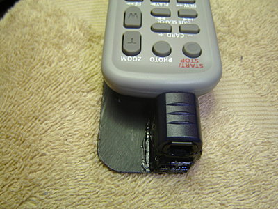

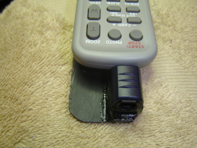

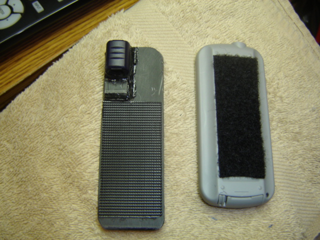

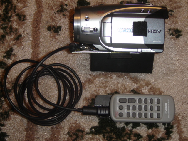

Gentlemen,
Just make up a "IR Remote to Cam, by Fiberoptic cable Mod".
Simple, cheap, and you can use the IR Remote "freehand", or attached to your Tri-Pod's Control Handle. For more Pics, ckeck my other Posts. I've made this setup for about 10 different Cams now, since 2000.
Harold

Harold,
I considered your fibre optic cable option but it seemed bulky as well as more work and cost than a simple reflector. It would also be something else to trip over.
