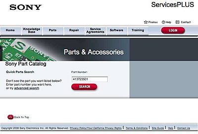

Originally Posted by William Griffin View Post
When I go to that site and put in the part number...all is says: "no matches found"..so what am I doing wrong?

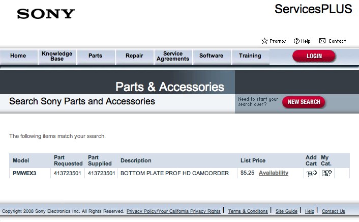

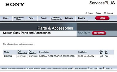

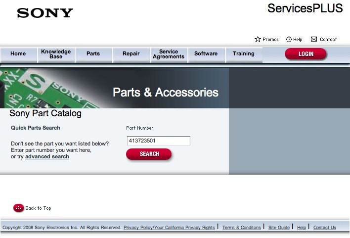

It doesn't appear that you're doing anything wrong. I couldn't access the repair kit part number, either. However, if you use the two part numbers posted earlier in this thread, one for the plastic plate and one for the screws, those numbers work if you plug them into the "Quick Parts Search" text field at the Sony Site. For example, if you type in the part number for the little plastic plate you get the following result:
Are EX3s shipping with tripod mounting fitting?-ex3_001.jpg   Are EX3s shipping with tripod mounting fitting?-ex3_002.jpg
