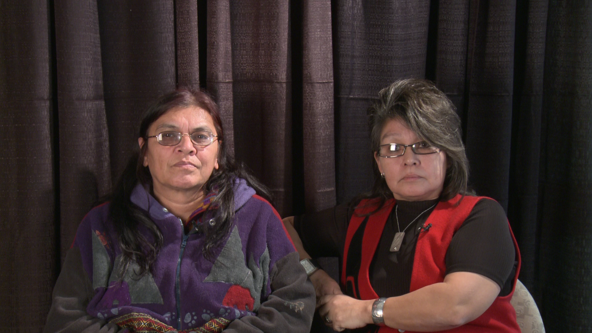

This shot was done using a Lowell DV Creator Kit #55, which is of course, all incandescent. You'll notice that the area of the black drapes lit by the hair light creates more IR contamination than other areas. Thankfully, all it takes to fix this is one click in FCP's 3 way colour corrector.
I have had 2 Tiffen T1 IR filters on order for a while now.
- Don
Last edited by Don Greening; January 27th, 2010 at 04:14 AM. Reason: adding attachment

Don that Redish glow on the back curtain doesnt really bother the picture much, if i was analising this i would think that turning her into a red-head :-) would be the thing THEY would notice . In THIS case couldnt you just offset the light(s), solve the excess in the center, and kill the light reflection on the glasses in the same move?
that wouldnt cause me to stuff a filter on, thier skin tones look ok and all thier blacks other than her hair is ok. and the whole thing doesnt fall into the OMG look what happened realm. I can see it, but its not destroying everything at all.
If you can get them to smile, instead of worring about such excess technical stuff :-) why it wouldnt exist at all

We interviewed about 40 sets of people over a 2 day period in 2 different rooms. I was the card wrangler and hired 2 crews, including boom operators, to do the actual shooting with my gear. The lack of smiling was because of the subject matter: serious human rights violations. The frame grab was taken before that particular interview got underway.
- Don

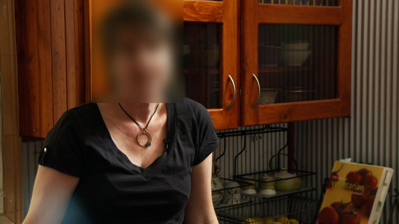

Today I was filming this girl in a black t-shirt. I noticed the black browning up in the flip out screen and put the 486 filter on. This fixed the shot and it looks really good even though there's not much light
The full wide wide shots did not show any vignetting that I can see
But on this grab of a shot 1/2 zoomed in you can see a weird blue corner
There's a window just to her right so I guess the rays are coming in at a low side angle and hitting the filter
I remember now I didn't have the lens hood on so that may have caused it
Apart from that a great day!
Steve Browne is offline   Reply With Quote

Yep, sure looks like a light flare to me, too.
