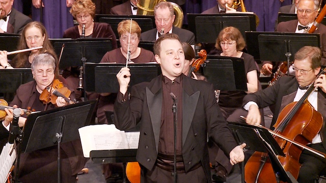

But imagine you were covering a concert orchestra only for the view to be peppered by people wearing brown/purple instead of black!
Even if some people reading this think they don't need a T1, they could save an awful lot of explaining to the client if they stash one in the camera bag just in case.

You mean something like this.

A great illustration of the problem!
