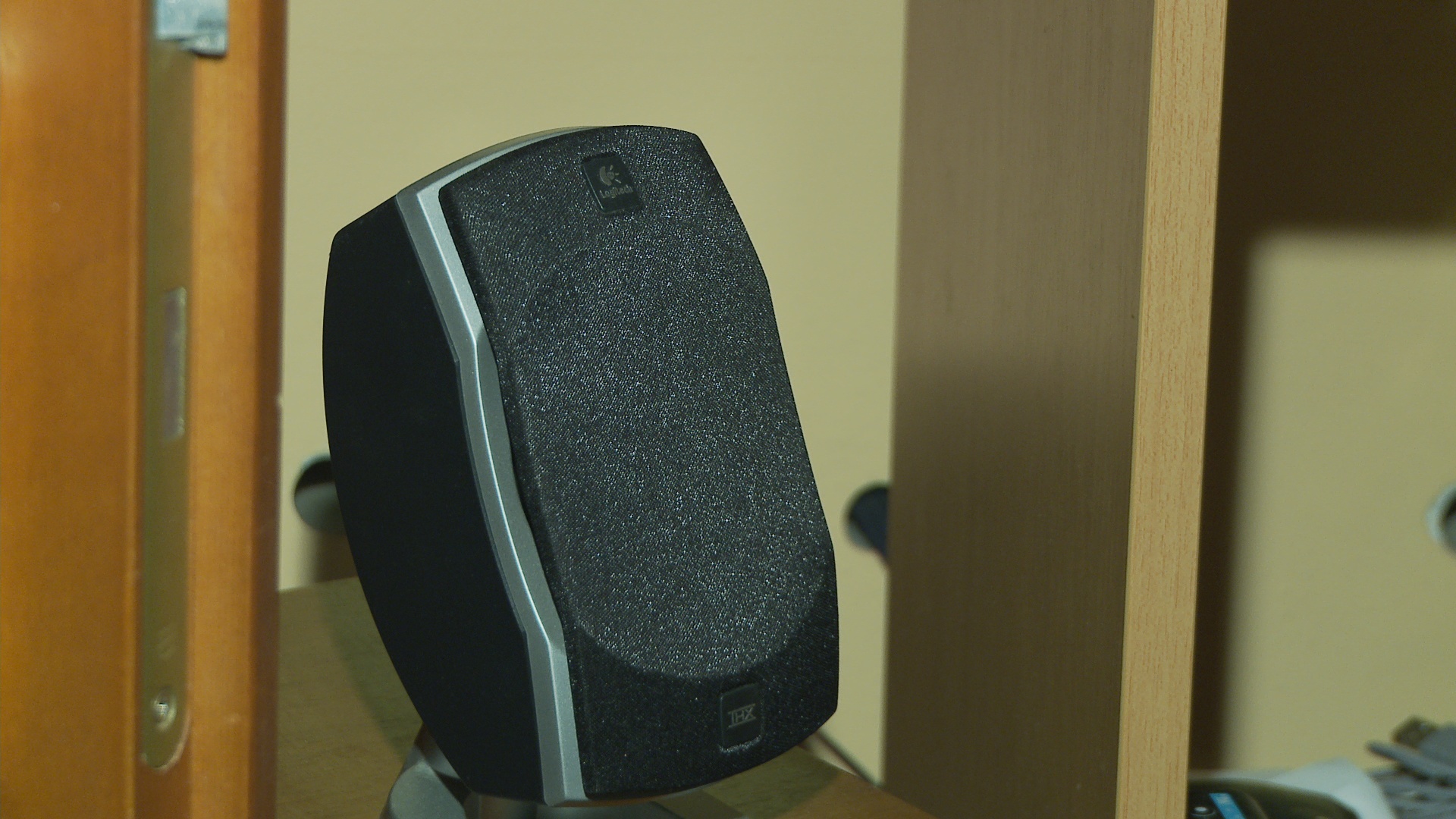

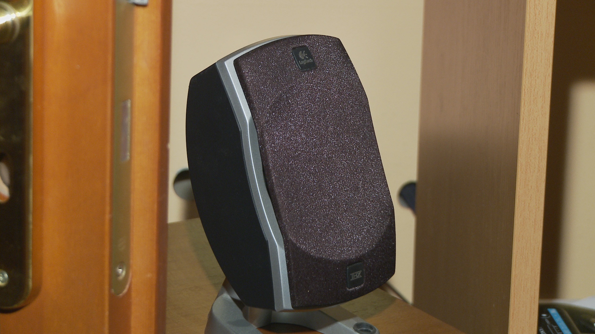

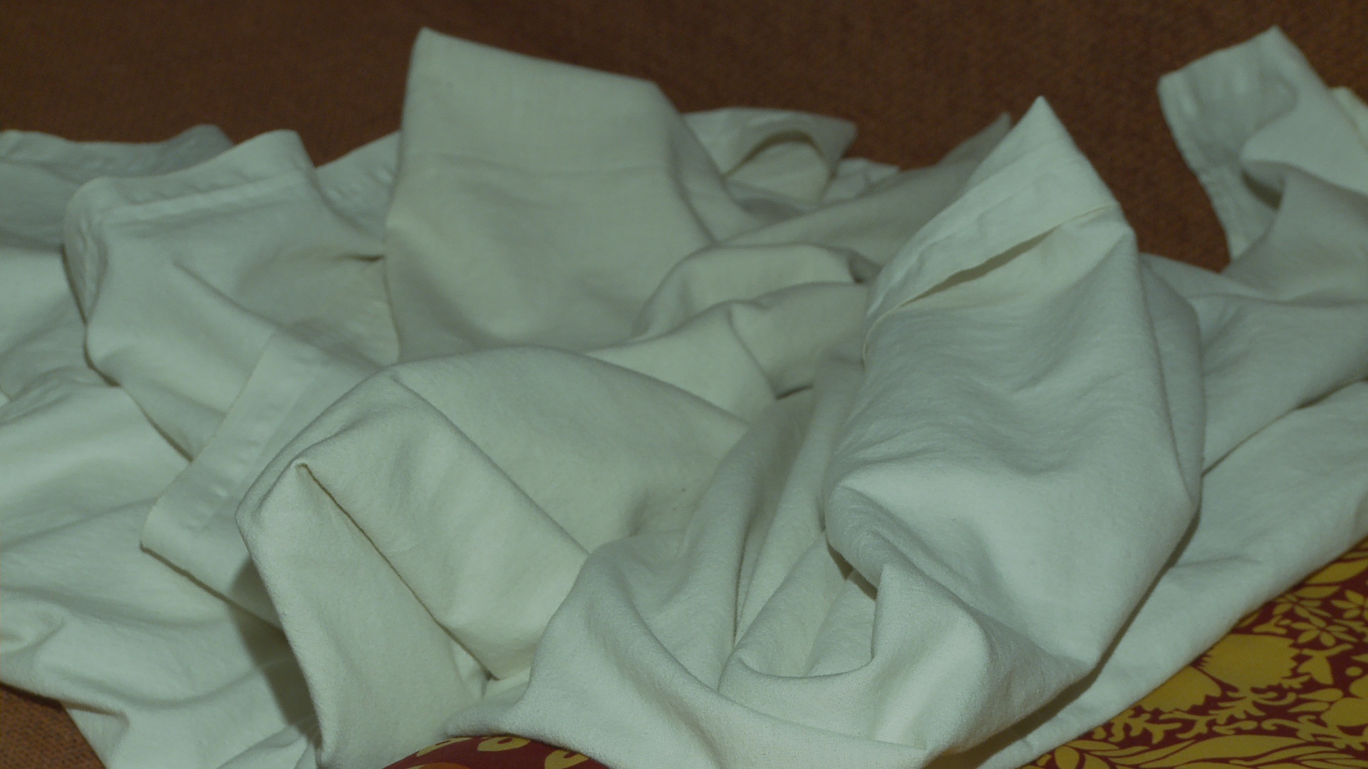

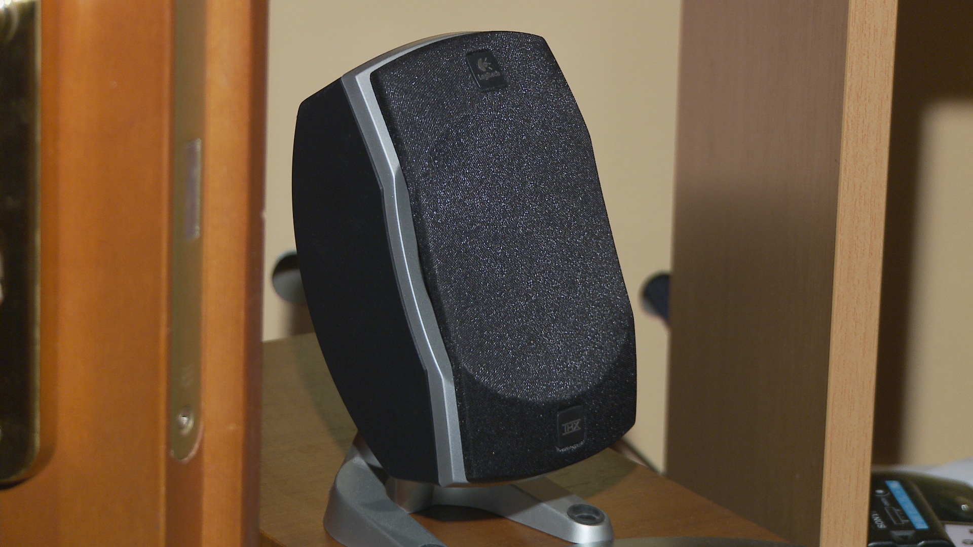

For those still looking for a solution to the IR (or far red) contamination problem, here's some pictures showing the effectiveness of the $69 T1 filter.
These were shot in my room, with a mix of a typical home lighting bulbs and my on-camera, 35W tungsten light. Initially, there was no filter, and the WB was set to 2700K - the upper left screen grab shows the black speaker grill evidently contaminated.
Then I just put the T1 filter on - the upper right pic shows the improvement of blacks, with the evident, overall green tint.
The middle row shows how the casual white balancing got rid of the green tint, while the camera CT read-out only changed some 100K - from 2700 to 2800K. It's obvious the mere 100K difference could not improve the WB if simply dialed up in the PP; some specific compensation of each of the RGB channels must have taken place.
The result is shown in the bottom picture; black is black, and there is no green tint.
Of course the same could be achieved with the 486 filter (I used to own one), but at wide angles the green vignetting was impossible to get rid of in post.
The decision on which filter to use is up to you guys - but personally, I invested in both the 77mm screw-in and the 4x5.65" T1 filters, and am happy so far. The light loss is no more than half a stop.
To answer the OP question of this thread: definitely no, I don't keep those filters on permanently - only use them when needed.
Just my $0.2 to consider:)

One thing though Piotr, with the T1 attached look at what it has done to the colour of the wood and to the walls. All very green and sickly looking. Those are very similar to skin tones, and is one reason I try to avoid using the filter other than when absolutely necessary now.
[Edit] Just seen that it is the bottom picture you had the T1 on. Though I still haven't had great experiences when it comes to peoples faces with the T1
Simon Wyndham is offline   Reply With Quote
Old March 18th, 2010, 02:17 AM   #74
Location: Poland
Posts: 4,086
Simon,
Yes it's the bottom picture that shows it corrected. BTW, when you hover the mouse over the pics, their titles tell it all!
Also, the procedure shown with my examples has been very casual - the white balancing should have been done using a proper white card, in the exactly same lighting as the original picture (the speaker).
I had several weak light sources in the room, and to perform WB I just turned the camera 180 degrees for it to look at the white sheet, casually dropped on the sofa. The lighting was definitely not the same as in the direction of the speaker!
I mainly do live performances of classical music - all in rather low and usually rather warm lighting. Without the T1 filter, the colors of musicians' suits would be unacceptable.
Other than that however, I always take the filter off - if only because of rather cumbersome WB procedure needed with every light change, and inability to use WB presets.
