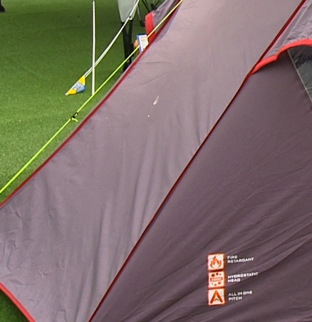

I was going to start a new thread about my weird IR EX1 experiences, but I'll hijack this'un. Hee.
Here's a tent I've just been filming, late morning, outdoors and overcast. (good old blighty)
Firstly, the tent's supposed to be pure grey... Also you'll notice a white blob on the side of the tent which wasn't visible to the naked eye! It was original some bird crap which we got wiped off, but on the EX1 is shows up a beaut.
Here's a short video link (720p), you can see the offending excrement appearing and disappearing as the tent moves, weird innit? It's almost as if the fabric has become see-through, or is acting as an interferometer or reflector of sorts, Strange huh? http://www.duncancraig.co.uk/Kit/EX1-IR/DHG_1335_01.mov
Anyway I've got a T1 now, which I will only use when I need it. It fit under the lens hood just fine too.
