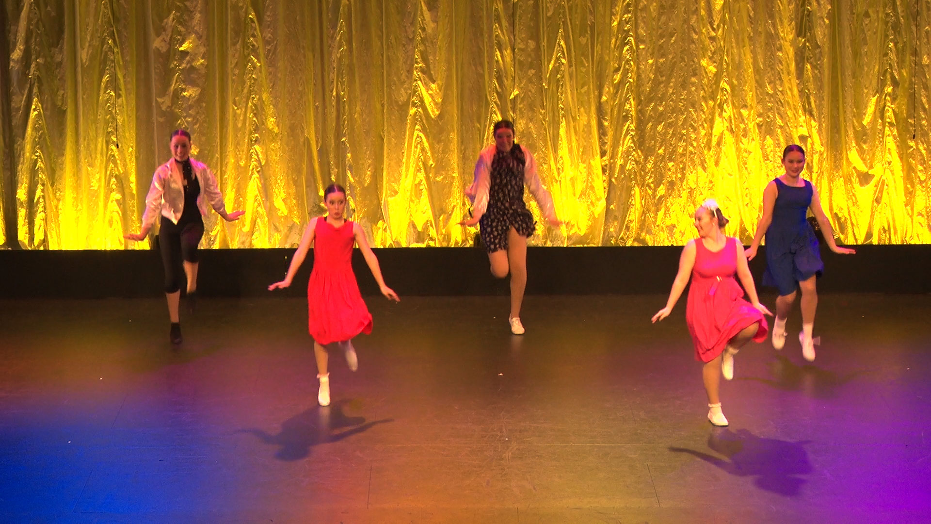

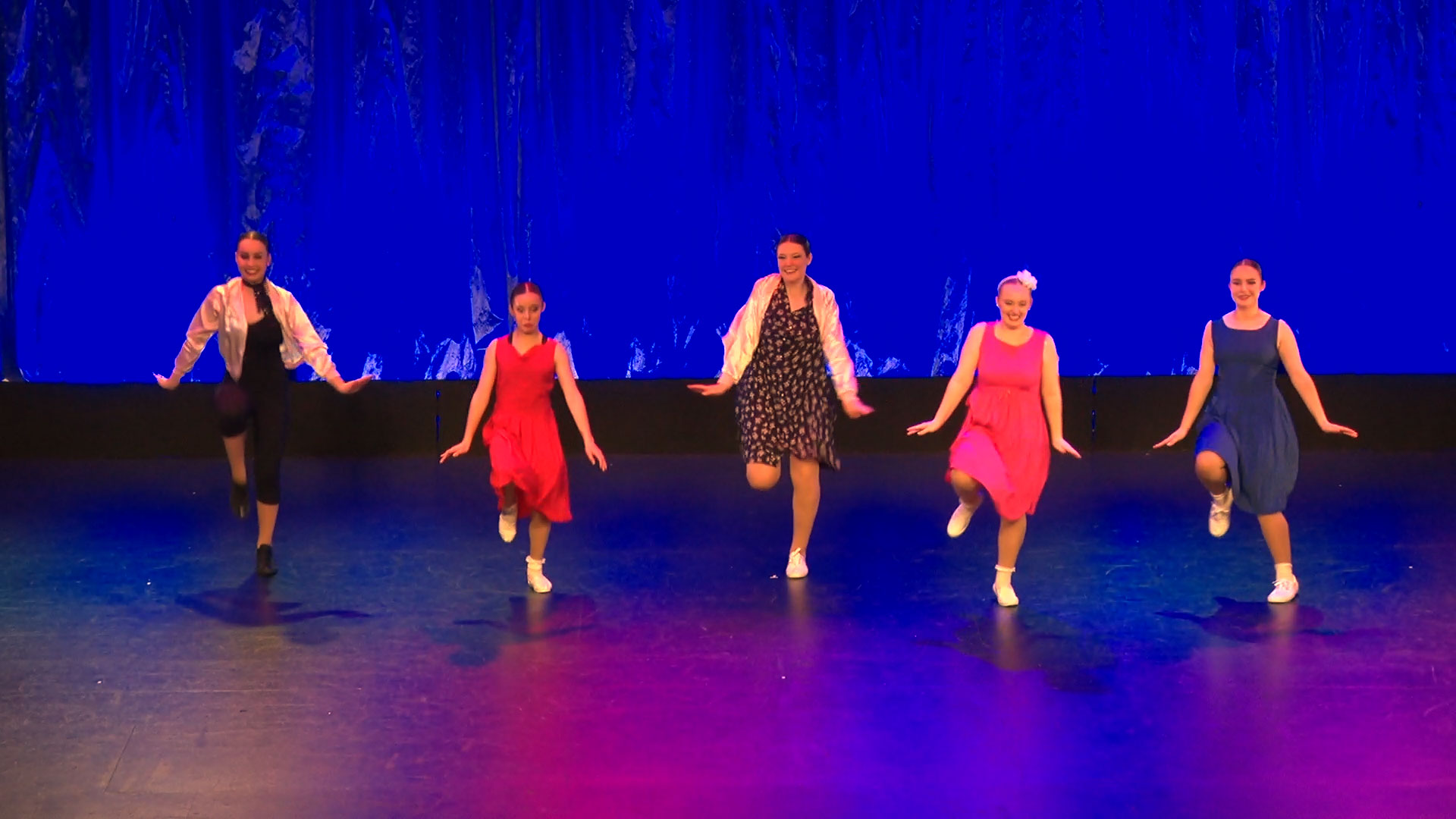

Thanks Pete & Paul, I probably wasn't totally clear, the LED lighting issue I'm mainly trying to avoid is with over saturated images / lost detail, i.e. This:
http://www.dvnonstop.com/hxr-nx5r/Si...tainFrame1.jpg
versus this:
http://www.dvnonstop.com/hxr-nx5r/Si...tainFrame5.jpg
There are other examples in threads linked in the first post, but it's basically the complete loss of detail you see in the second pic, when the scene was lit with "purple" LED lighting (the colours were strobing in that item, so some registered fine, and when the purple/blue was used, the detail was lost). I'm aware of the other issues with dimmed (flickering) LEDs, rolling shutter, strobes, etc - I don't consider any of those particularly fixable on a live show (where I can't control the lighting), and I'm happy enough with the results the camera gets there. Usually any impact of these effects is minimal - losing all the detail because a particular colour light is used in an item is a much bigger issue.
Paul has hit the nail on the head with respect to live shows, most of mine and children's dance schools, and I'm just making a recording of the event for them. Pretty much no camera consideration is ever given in the lighting design, I'm never asked for any input, and I've even been told outright by one client "not to complain about the lighting like the last guy did!" (Their show was at least 50% pink/purple/red LED lighting, it was horrible to film).
The thing that most gets me here, is that the older cameras handled this better. The Sony Z1 (CCD sensor) captures the colours fine, the HXR-NX5P (CMOS) was quite similar. The HXR-NX5R was where I first experienced the over saturation issue, but so long as you change the colour mode on that camera to anything other than ITU709, you're fine, only that colour mode over saturates and loses the detail. Every newer camera / 4K camera I've looked at seems to now have the issue (with no work around), or is a mess of noise or other issues when trying to film under this sort of lighting.
It almost seems like the manufacturers have just accepted this issue at this point, even though it affects more than just theatre situations. As an example, taking a look at the video posted here:

The over saturated loss of detail again is due to RGB led lights. This new technology allows color changes without adding a gel to a white light. While it might look ok to our eyes, it causes problems with the camera sensor. This isn’t about assigning blame but describing the reality of the situation. Today’s camera sensors can film daylight or tungsten well and even good led white light but not led rgb. Today’s theater lights are increasing using led rgb lights instead of gels, as long as it looks good to the human eye of the audience that’s all that matters to a theater production.
The answer to your original question, there are no cameras that I know of today that will avoid the problems you describe because they use the same sensor technology. The best you can do is explain to the client why it looks that way. But in truth there has always been limitations with how video cameras capture color. For example the lack of an ability to capture details in saturated red has been a problem and continues to this day (look at the dancers red dress in the still you posted). Since the primary purpose of events like dance recitals is for the audience and not the video you have to resign yourself to the realities of the situation.
In the samples you posted you were lucky they only used rgb led to color the background. I’ve filmed productions where they’ve used that blue light on the entire stage and everything including the dancers are washed out with no details.

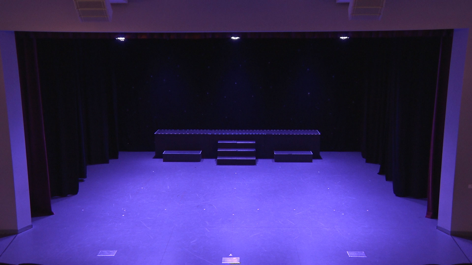

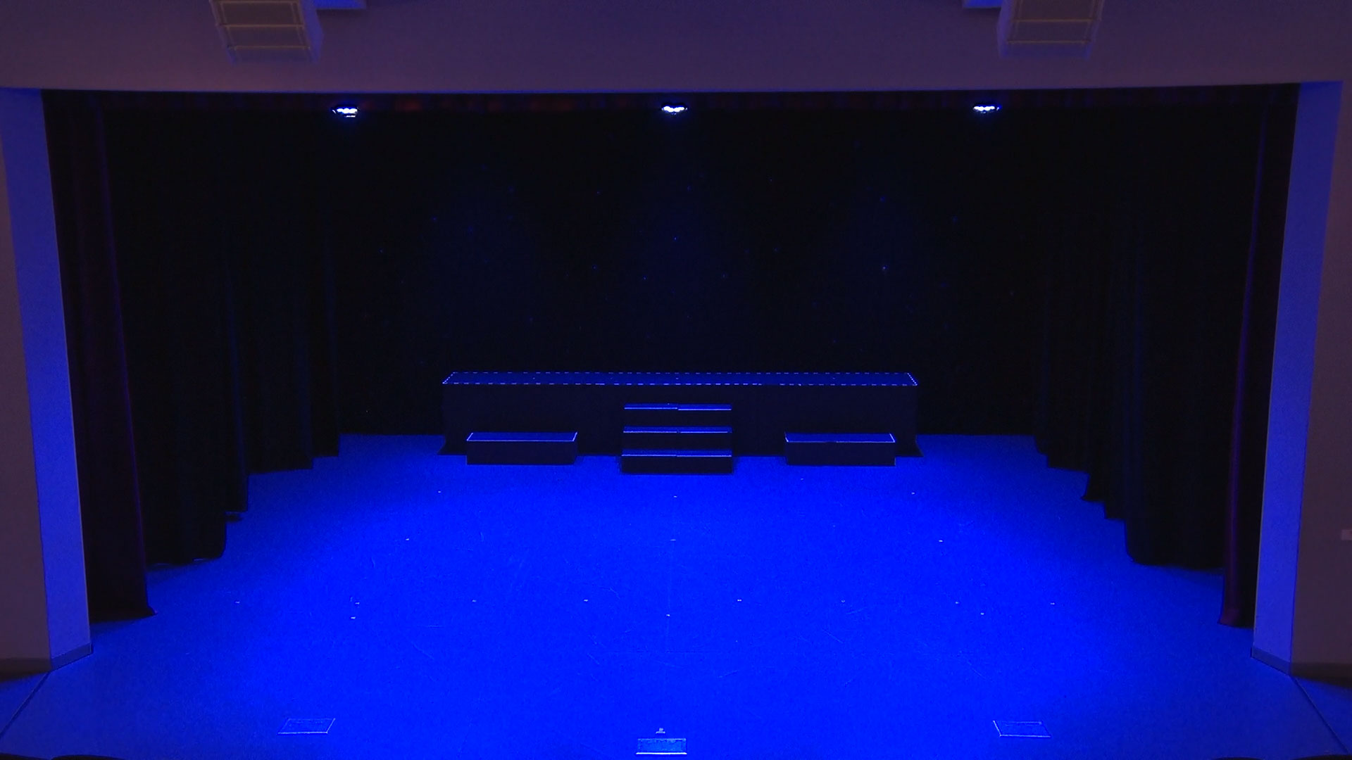

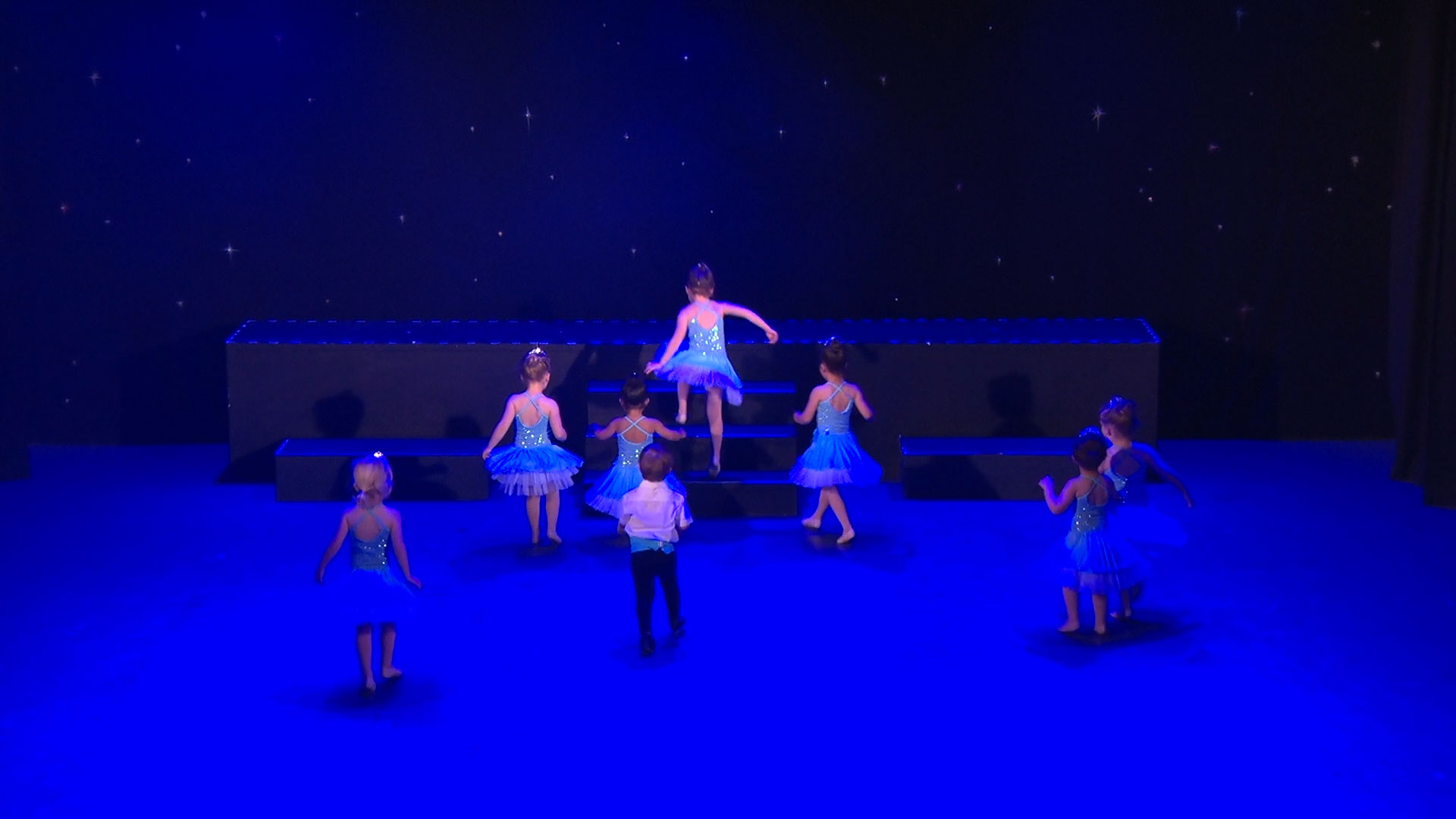

Don't worry Pete - I've had those purple/blue LEDs used across the entire stage, and lost the detail on costumes & people as well (look at the skirt on the girl in the lower left, compared to those standing in white light at the top of frame):
http://www.dvnonstop.com/hxr-nx5r/BalletSkirts.jpg
What gets me with the NX5R, is that the over saturation only occurs when using the ITU709 colour profile:
http://www.dvnonstop.com/hxr-nx5r/ColorITU709.jpg
The other colour profiles on the NX5R just don't over saturate the blue channel to the point of losing detail like that:
http://www.dvnonstop.com/hxr-nx5r/ColorCinematone2.jpg
The older NX5P doesn't have the issue at all (on any colour profile). To me it seems like it isn't just a function of the sensor alone, but other components or software in the camera as well. The fact that changing the colour mode on the NX5R can basically remove the saturation problem says to me that the problem is solvable, but none of the current Sony cameras are implemented in a way to make that possible for whatever reason. Note that with the work around on the NX5R, the colours still need some adjusting in post (the camera still prefers blue over red under LED), but at least with all the detail retained, those adjustments are possible. Usually for my work, I just add a bit of red back in, and pull some blue out, and that's all that's needed.
