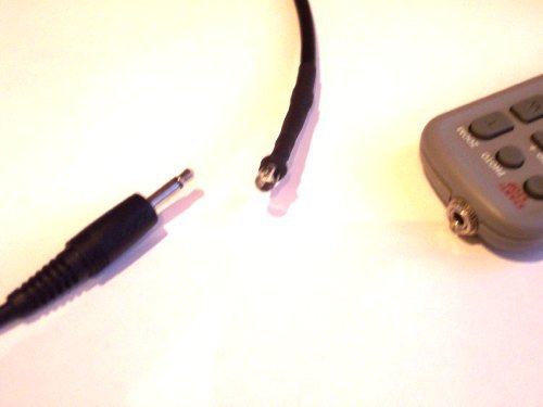

That sounds like the HV20 hack. I did it years ago for a couple bucks and can probably pull up the old article on it if anyone is interested.
You open your infra red standard remote that comes with the camera and cut the wires in the middle going to the bulb. Leave some on the bulb and some on the board.
Solder an 1/8" phone socket in the remote in its place. A little shaping of the whole were the bulb was and the socket fits in and tightens down.
Plug in an extension cable, then another cable. Then solder the bulb on the end of the cable. Shrink wrap around the connection makes it look pretty.
The middle cable is so you can put different length extensions in between. You put the bulb right in front of the camera's sensor. It works real well, triggers all the things the remote can normally control and is real helpful for cranes and such.
