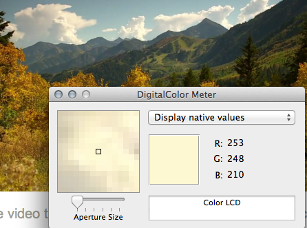

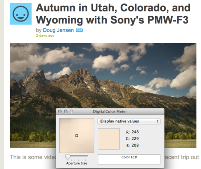

I don't understand what all this talk is about highlight handling problems with the F3. What problems? I don't have any problems with handling hightligts. Do you have any examples of what you are referring to?
If you shoot with preset white balance, anything over 100 or 109 (depending on CG), goes yellow. Midtones go green. Chroma isn't rolled off as it goes into clip, which cameras like the Alexa, Canons, and Red do.
If you don't have anything that's saturated and about to clip, then you're fine. I don't see a single frame in your video where you're clipping, although all the whites are going yellow (which looks nice in your case), but I personally am not into that on every job I do.
These are traits I've seen in the entire XDCAM line starting with the PDW-F350 I had years ago.
I pulled this still from a video Douglas Villaba posted on Vimeo, hope he doesn't mind! I should mention that the below is about the worst I've ever seen what I'm talking about. Most of the time it's more subtle, both the chroma clipping and the color casts.

Quote: "I don't see a single frame in your video where you're clipping, although all the whites are going yellow (which looks nice in your case), but I personally am not into that on every job I do."
Yes, I take care to expose properly -- thus no clipping. Problem solved.
So, "alll the whites are going yellow"? Really? You better take another look. Yes, SOME of the whites are going yellow -- that is the whole point of shooting at certain times of day. What am I supposed to do, white balance at sunset/sunrise and remove the natural tones that exist in real life? If you want pure white clouds, have a late breakfast and shoot at noon. If you look at any scenes shot around mid-day, (such as 2:24 and 3:04) those whites are not "going yellow".
Any whites that ARE going yellow, were captured that way correctly by the camera. If someone is having trouble with clipped highlights shifting colors, then the solution is simple -- expose properly. Problem solved.
I don't see what we are supposed to learn from the freeze you posted from Douglas Villaba's. If you want to see badly shot video, I can point out many examples. How about if I post a still that is out of focus and then use that to prove my point that the camera has a focus problem? The so-called color problems with highlights from the F3 are attributable to operator error. Build a good PP, expose properly, and all is well.

Doug, if you don't agree, then can we agree to disagree? My observation is about the camera, not your shooting.
I myself, kept the opinion to myself until I found other shooters who, unsolicited, expressed the same opinion. Then I knew what my eyes were telling me wasn't completely off base. In addition, it's not practical at all times to expose so nothing in the frame is clipping. Often, I WANT some aspect of the picture to go white. But I want it a graceful, neutral white, and while the F3 stock will do it sometimes, other times it goes ugly for me.
By the way, below are some RGB values. What I see there is the same thing that the parade scope in Davinci tells me. Another thing, somebody has mentioned to me the problem is mitigated when doing a manual white balance.
My aim is not to argue about it...if you don't agree, then that's ok with me. You seem to make great pictures no matter what the case is.
