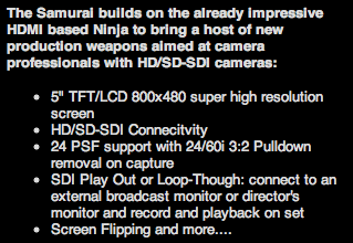

Can the Samurai remove pulldown because the Ninja cannot.
From what I have personally seen, no external recorder has a great LCD but the PIX240 has the best screen and is sooo easy to setup and use. Its no TVLogic but it works good enough for viewing and playback. It took me all of 2 minutes to set it up, format the SSD and go. For my money, I would go with a trusted manufacturer who has a proven track record of reliable equipment. I have seen how cheaply made the Ninja and its accessories are and it would make me nervous to use on paying jobs. Also, I really like the 'caddy' idea of the PIX and that it can record to an internal SSD or a CF card. I like that I can record to the CF card and take home with me while my friend takes his PIX with him. This would also work for giving a client a copy of footage at the end of the day on a CF card.

Originally Posted by Steve Kalle View Post
Can the Samurai remove pulldown because the Ninja cannot..
I hadn't thought of that yet, but apparently it can.
