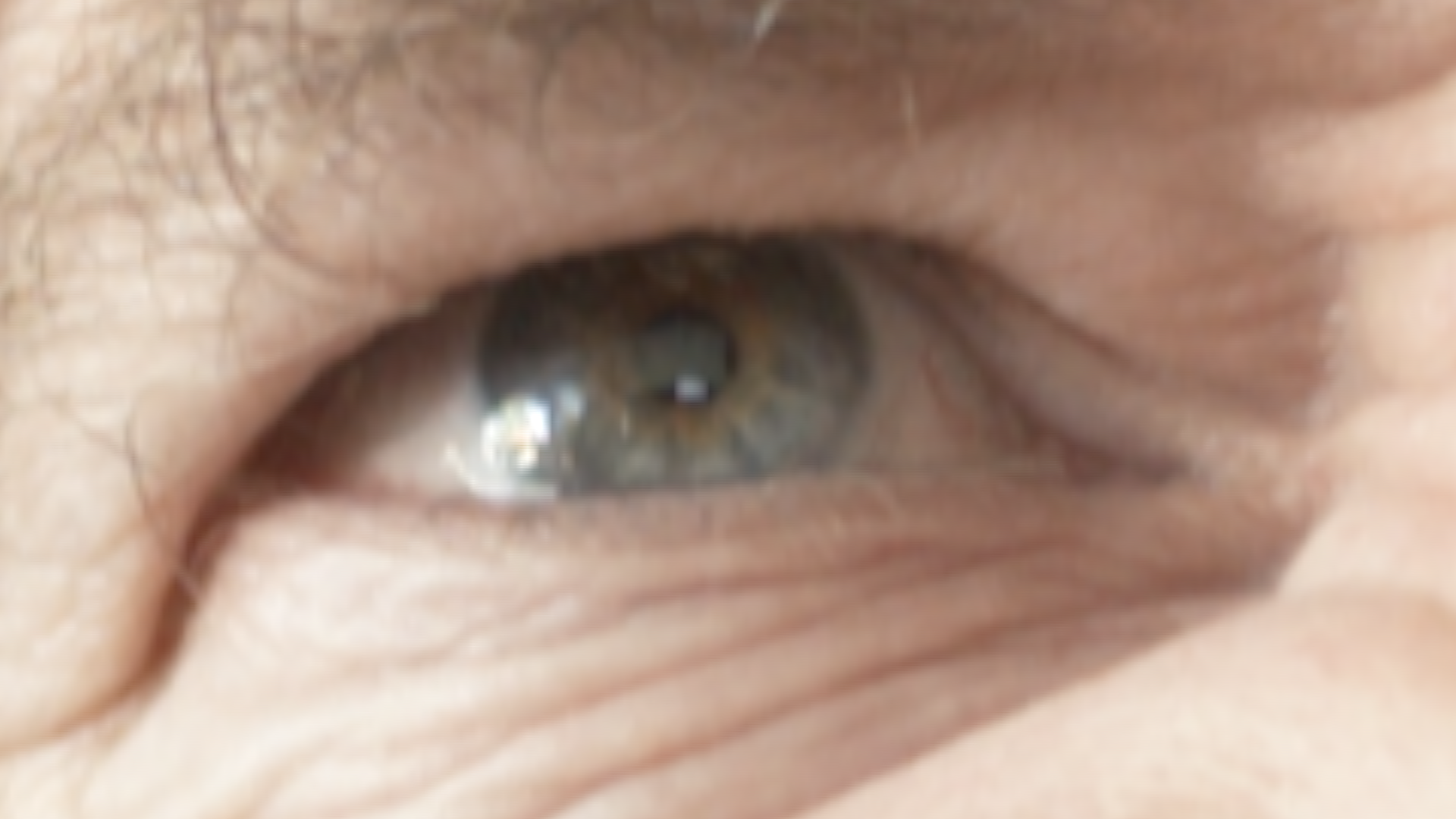

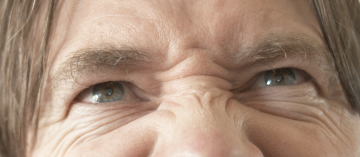

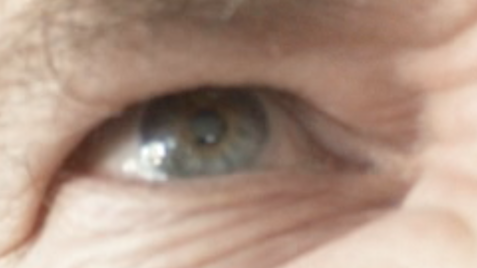

Attached are two images. They are still frames of video at 800% magnification and saved as PNG files. One is using the ProRes422 10bit 220mbps (Pix 240) and the other is an identical time from the SxS card 8bit 35mbps.
F3 4:4:4 recording solution? Forget the gemini!-prores422.png   F3 4:4:4 recording solution? Forget the gemini!-sxs-card.png

Holy cow. I knew XDCAM was a little softer, but not like that.
the difference in those is huge!

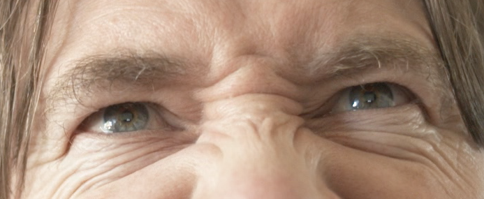

By the way, those are not wrinkles. I was squinting as much as possible to create more detail for s-log.
Remember, that's 8x the original size. Most images look quite ordinary when you magnify them like that.
F3 4:4:4 recording solution? Forget the gemini!-sxs100.png   F3 4:4:4 recording solution? Forget the gemini!-prores100.png
Oh, I caught that. You can't convince me it's still not a big deal. When you manipulate the image later in color or otherwise, those 'softer' areas fall apart before everything else.
I understand this might seem like splitting hairs, but after shooting Red for 2-3 years, I'm excited to see this cam close the gap.
Also, kudos for the 'angst' codec test. Tektronix might be interested!

Is the difference related to ProRess vs. XDCam or to 10bit 220mbps vs 8bit 35mbps? Or in other words, will capturing with nanoflash at XD Cam HD422 @ 220mbps be comparable with the proress example or with the SxS card example? I don't have a F3 (yet), but have a nano and consider the F3.
