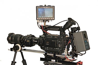

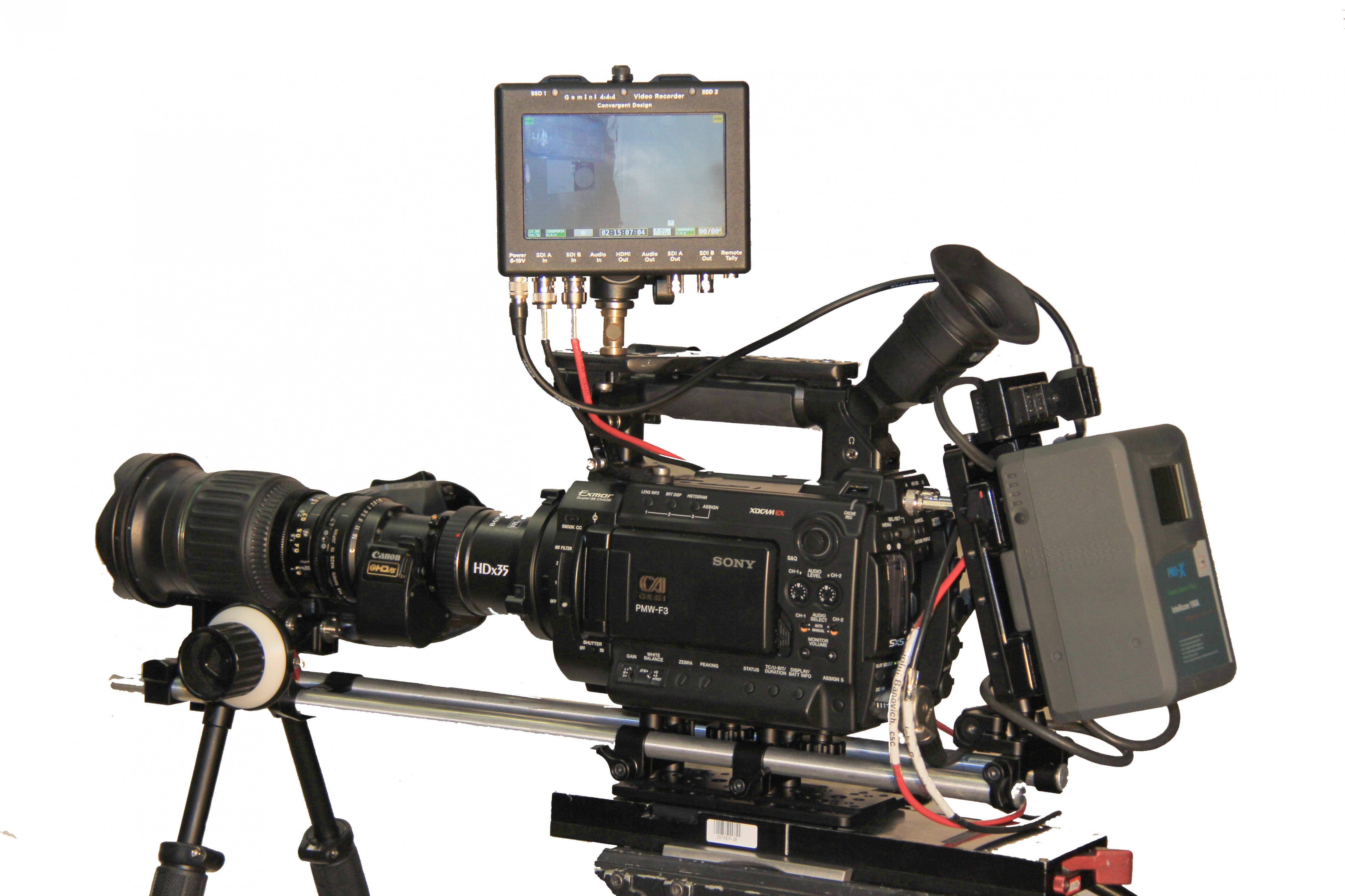

This is my F3 with the Gemini on top and my HDx35 with a Fujinon 18x up front. Excellent package for Documentary and Reality work.
F3 4:4:4 recording solution? Forget the gemini!-f3-no-bg-alpha.jpg
