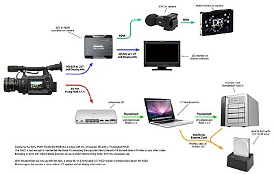

F3 4:4:4 recording solution? Forget the gemini!
Hi there,
since I got my S-Log upgrade for my F3 I have been searching/waiting for the perfect 4:4:4 recorder and I was quite sure that I'll buy a Gemini444 when it is available. Now I have built my own setup at half the price of the Gemini with even more features. And it works great!
Read about my workflow here:
Sony F3 4:4:4 RGB uncompressed workflow | _mxr blog
Compared to the Gemini444 workflow there is one big disadvantage: it’s bulky, big, heavy, and you need external power supply – no batteries. But remember: the Gemini 444 records onto SSDs with a max capacity of 512GB. The Gemini can span over two SSDs which gives you a max capacity of 1024GB and a recording duration of approx. two hours. When you shoot more than two hours of footage on set you have to buy additional SSDs or download the footage into a DIT-station which is practically the same thing as my workflow – a computer with a RAID.
F3 4:4:4 recording solution? Forget the gemini!-f3workflow.jpg
Christoph Tilley is offline   Reply With Quote

this a very interesting solution...what do you think...could the same workflow logistics be applied to the aja Io XT device? it has also dual hd-sdi inputs...could even serve as a 1080p 60p recorder...what do you think?

If you use the Ultrastudio 3D or IO XT you're going to be tethered for both power and video signal. Not too good for field work. I think you could just go with a 4.4.4 card from Black Magic and do it cheaper.
