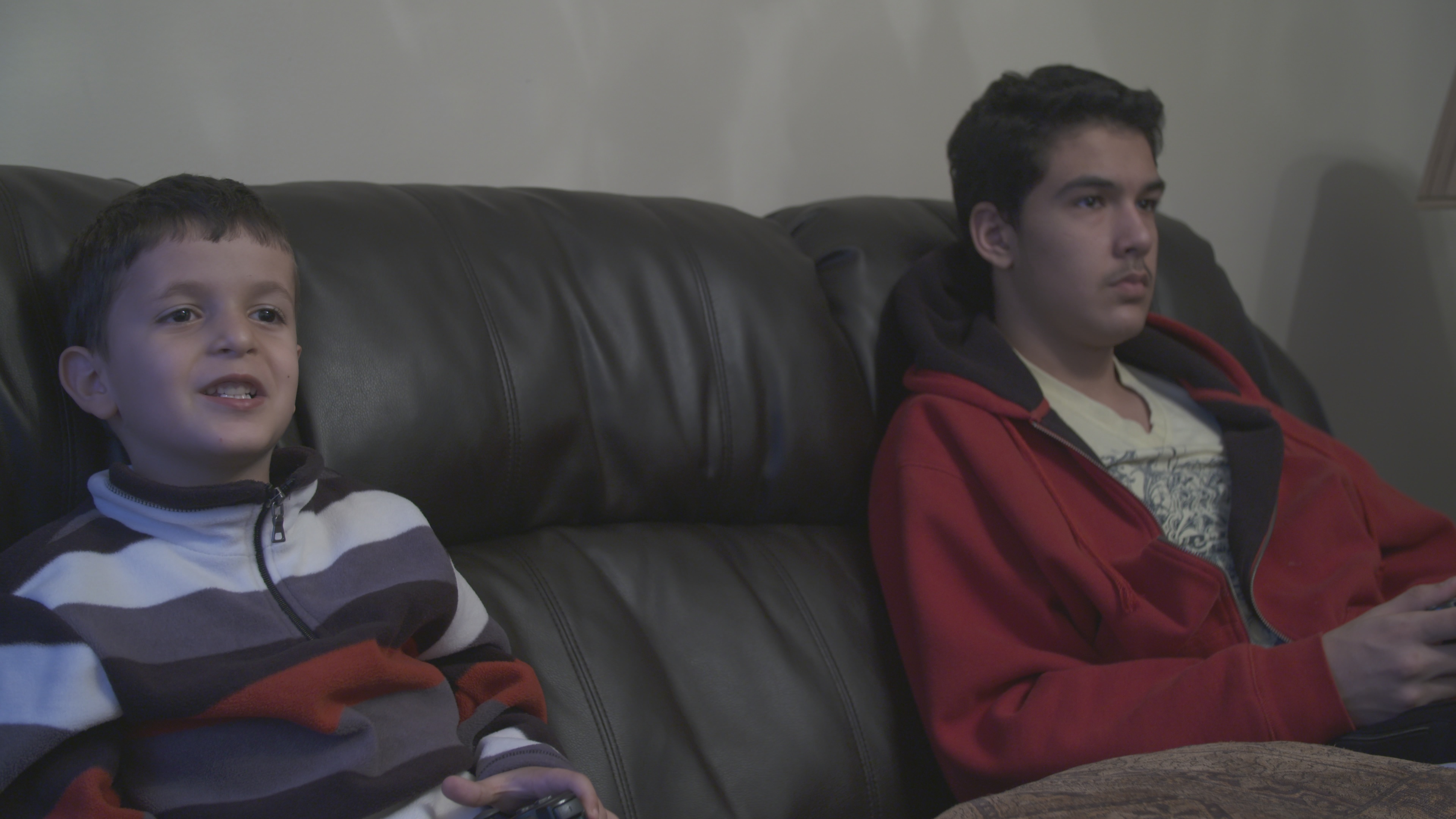

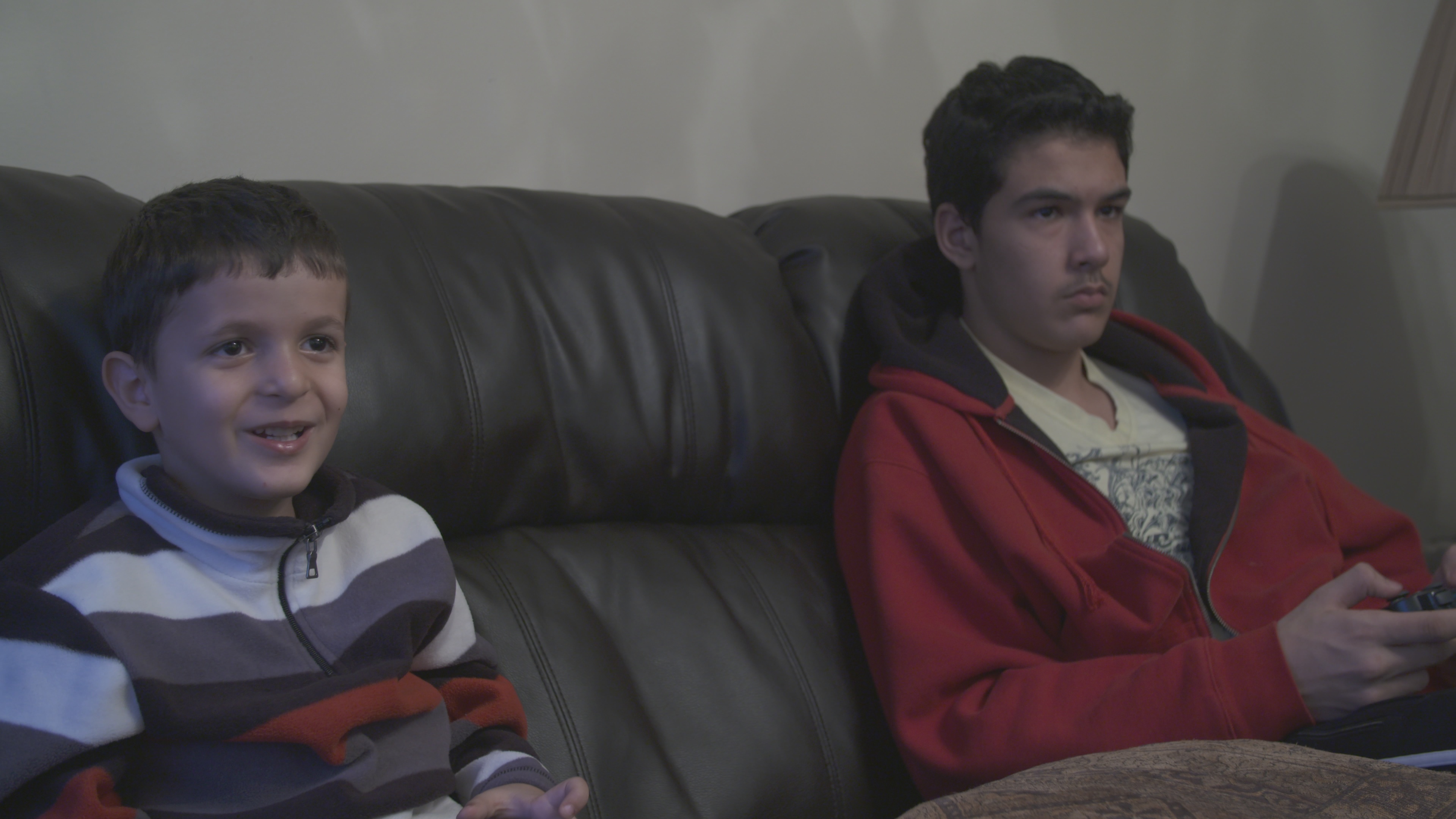

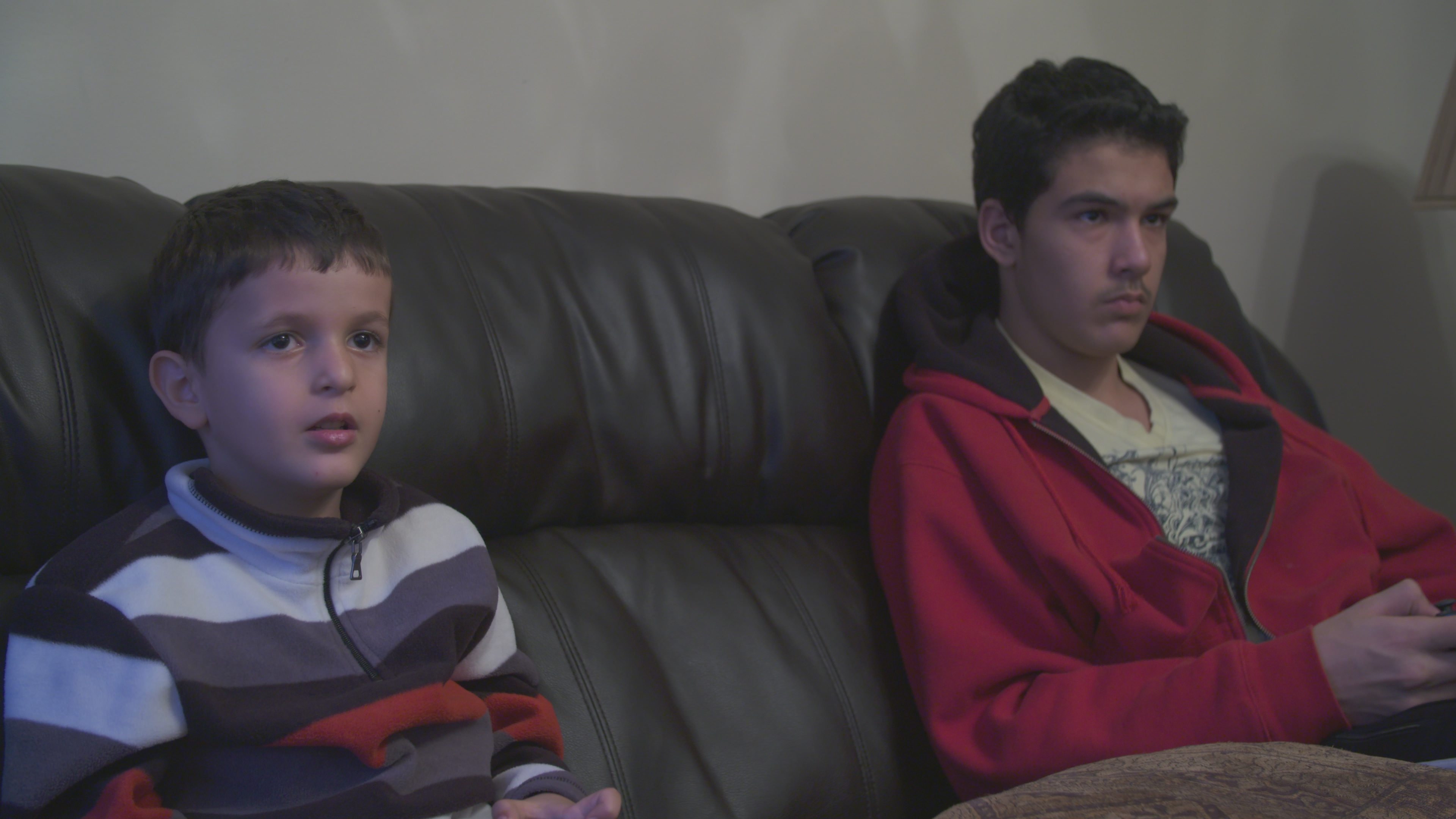

I shot this test with all natural lighting. Not that i would use Cine EI/ S-Gamut3.cine/Slog 3 for low light situations but i wanted to see how it looks. Of course the exposure would have to be pushed up with such mode, and oh ya, proper lighting and monitoring also.
The HG modes produced the cleanest blacks. Nothing has been altered in post and the noise suppression feature internally has been set to high.

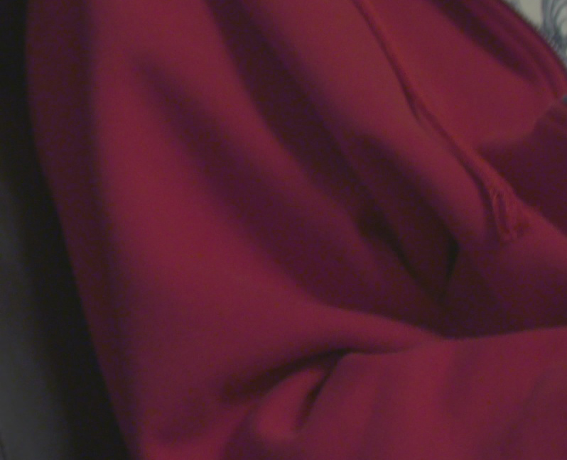

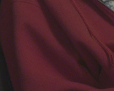

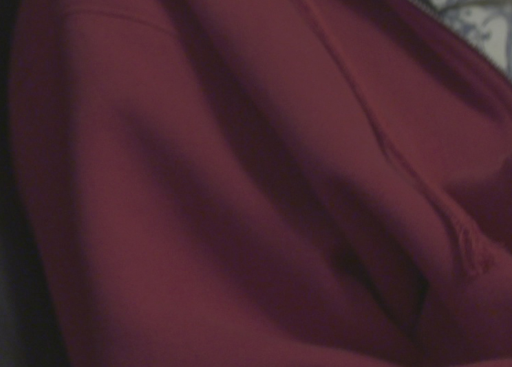

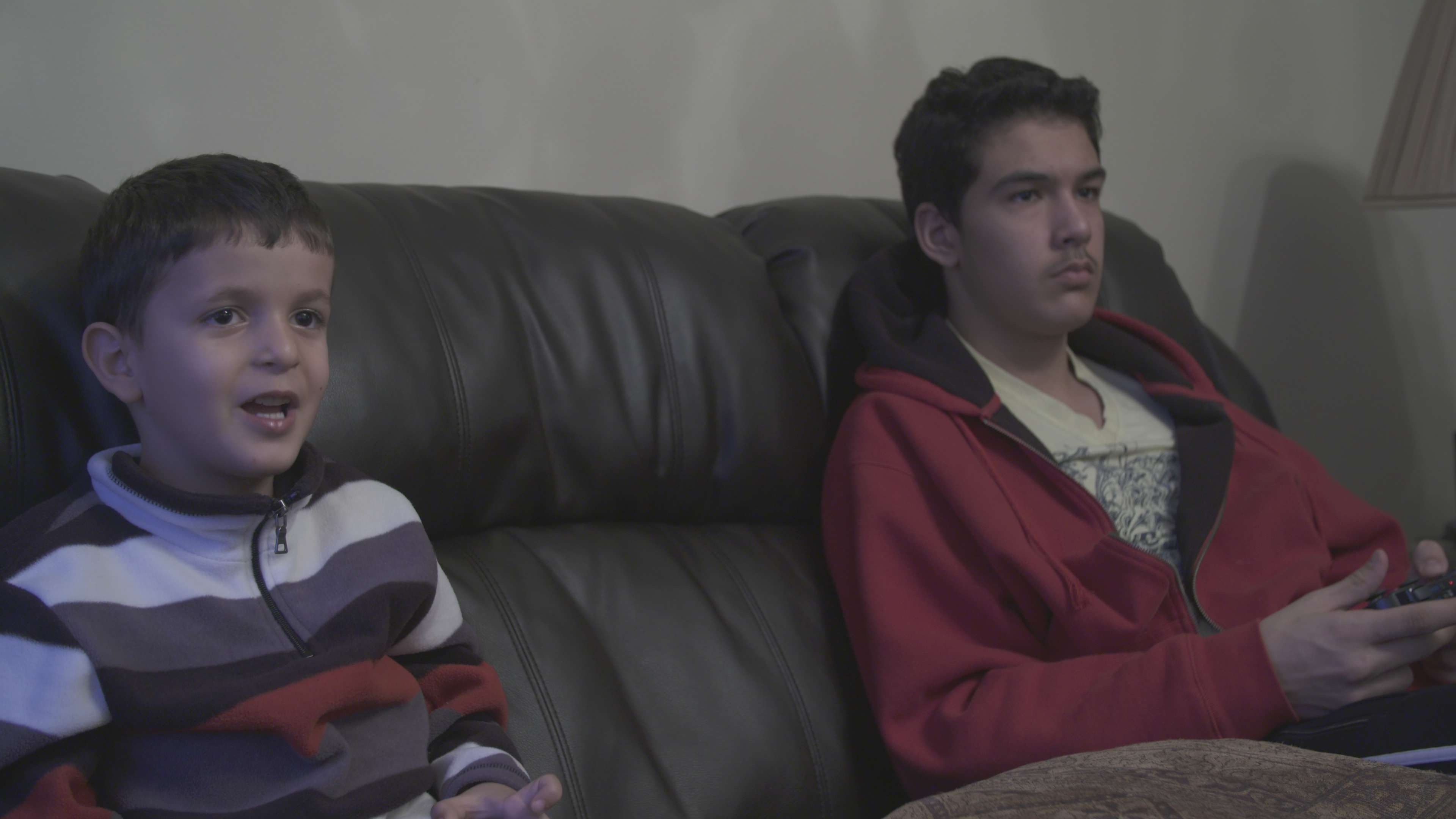

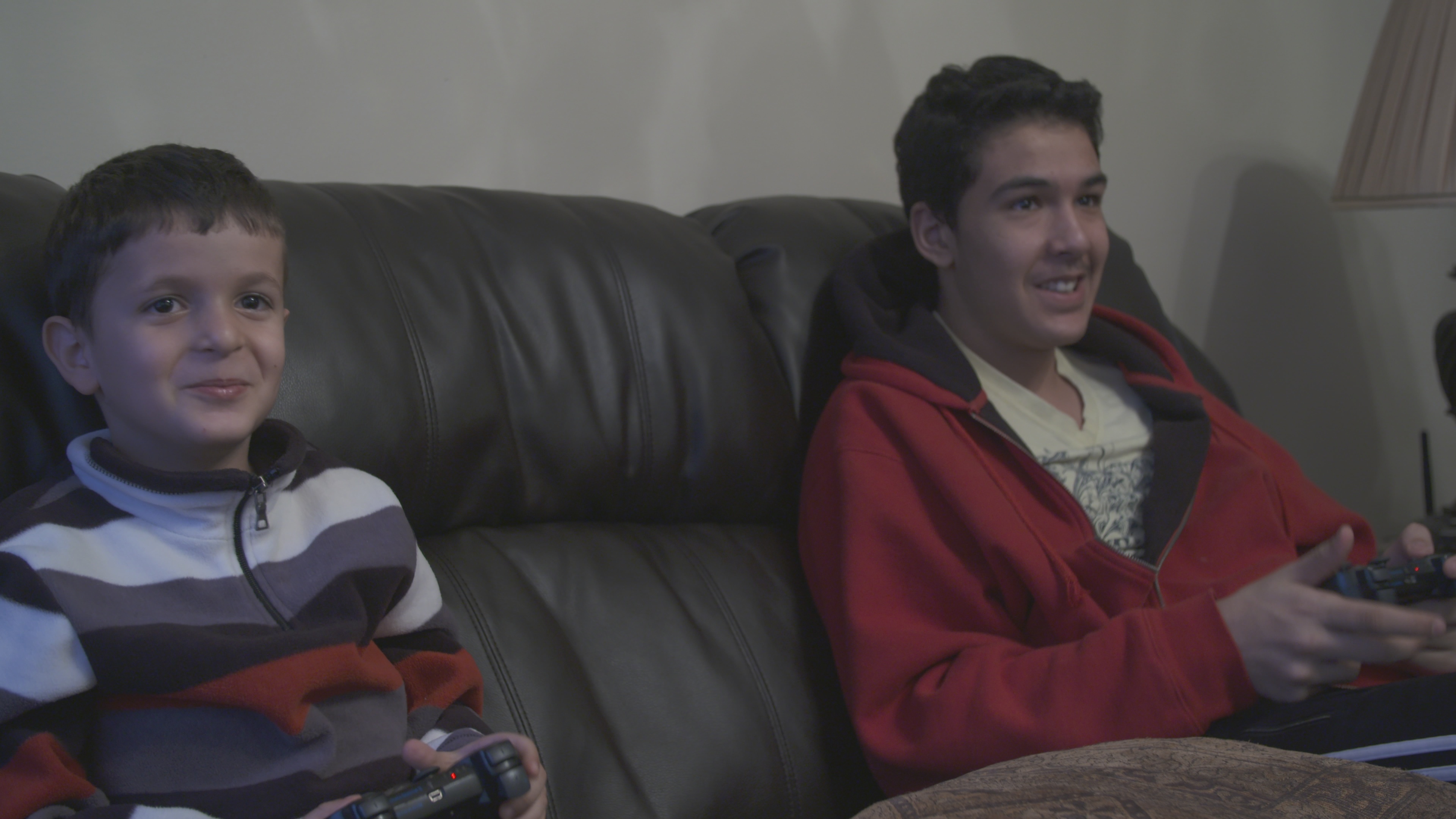

I have extensively tested the FS7 under all the gamma settings and color profiles with a speed booster and the Canon 24-105. I tested both in low light and standard average room lighting. There is red chroma noise in all modes and settings. This also included a custom profile where i decreased the red gain. This is the same problem that is evident in Doug Jensen's video. The only difference might be the lense he used, he also mentioned that he didn't adjust anything under the custom menu. I can tell you that i exhausted every mode. This is diffidently a Show Stopper for me.
New Sony FS7 4K XDCAM at IBC 2014-reda.jpg   New Sony FS7 4K XDCAM at IBC 2014-redb.jpg
New Sony FS7 4K XDCAM at IBC 2014-redc.jpg   New Sony FS7 4K XDCAM at IBC 2014-red-2.jpg
New Sony FS7 4K XDCAM at IBC 2014-red-3.jpg   New Sony FS7 4K XDCAM at IBC 2014-red-4.jpg
New Sony FS7 4K XDCAM at IBC 2014-red-5.jpg   New Sony FS7 4K XDCAM at IBC 2014-red1.jpg

PLEASE STOP MISQUOTING ME ON DIFFERENT FORUMS.
My video does not show that. Sorry, but you are making incorrect satements about my video.
1) There is no problem with red chroma noise in the parade video. The problem with the reds is that they are oversatured and have a magenta shift. But there's no noise problem. If you are having an issue with noise, you've got a different problem.
2) The parade video WAS shot with a custom scene file. Unfortunately it was the combination of settings I had programmed that did not work well together on a real-world shoot instead of charts. It was my own fault and I have since corrected the problem with a new scene file that looks great. Also, I've been able to do a regrade of the parade footage in Resolve and it looks almost perfect and completely salvagable. I'll see if I can post a new version in a week or two.
The video of the boys on the couch has a lot more problems that just with the reds. You better reset the camera and start over again from scratch.
If someone can't get good results with the FS7, they are doing something wrong. It is as simple as that. The camera is solid when the right menu settings, exposure, and WB are used.
