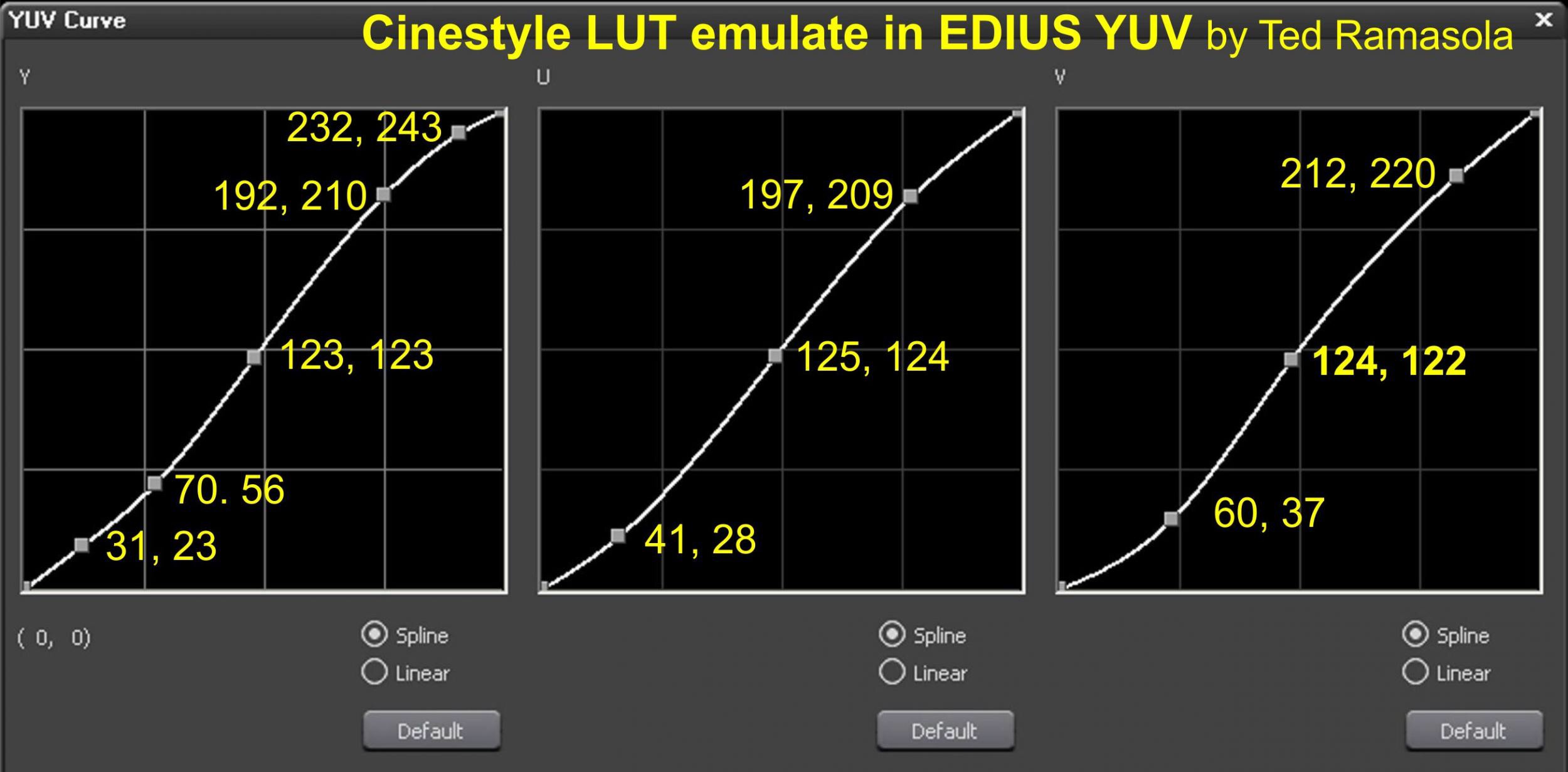

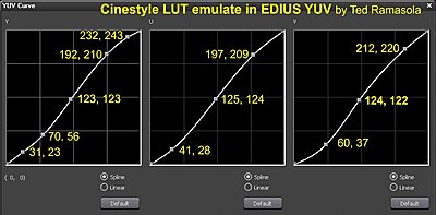

Edius does not support LUTs directly but there is a way going through AE and using LUT Buddy from Red Giant but it sounds rather cumbersome. Edius does have some good color correction tools - the more advanced one being the YUV color filter. I found a curve with the proper nodes on the curves that simulated a Cinestyle LUT and applied it to a CineE1 4k clip (XAVC Intra) from the net (F55) and it looked rather good. I feel, with a bit of experience I could make my own that would be a good first step in grading S-Log3 clips.
Any way to share that curve for us Edius users? Thanks.
Steve Kimmel is offline   Reply With Quote
Old October 6th, 2014, 08:39 PM   #130
Location: providence, RI
Posts: 107
Re: New Sony FS7 4K XDCAM at IBC 2014
While there is no import/export for the YUV Curve in Edius, each node is based on values of 0-255 in each X and Y axis. So it does seem possible to create and save a YUV Curve by editing the nodes from curve data.
Brian Jansen is offline   Reply With Quote
So, if someone posted the X/Y values for each node, I could recreate the YUV Curve. Too bad it's not easier in Edius.
As you requested:
Also the link on the original discussion:
http://www.dvinfo.net/forum/grass-va...edius-yuv.html

But a simple curve won't sort out the color space correctly, that really does need a LUT to be done right. Not saying you can't grade without LUT's but it's a heck of a lot easier if you can use LUT's. With LUT's you can build up a collection of looks that you can quickly apply in a matter if minutes. In addition if you really want to take full advantage of the CineEI mode in the FS7 you are probably going to want to find a way to generate your own LUT's to upload to the camera.
Don't be afraid of round tripping from your edit package into a grading package. It's normally pretty straight forward and the additional tools and features you'll find in a good color tool such as Resolve can transform the look of your work.
