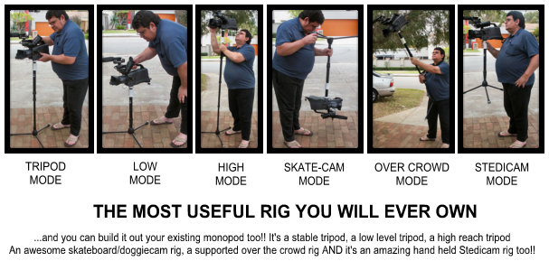

Hi Noa,
Most of the day its on a Manfrotto monopod or the Steddiepod. It can be used handheld.
The worst part is it is hard to put down because the QR plate on the bottom is offset, so it wants to fall over. It needs a foot added to the bottom.
I usually use the add on monitor (Lilliput 664 O/P) on a tripod.

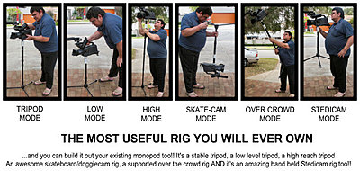

Hey Mark
A genuine Steddiepod?? I was looking at one and then decided that I would make one instead.. Just used a Bogen Monopod and fixed the legs from an old mic stand to the base and put a bunch of counterweights on each leg. It worked quite well actually ...the grip was made from a PVC retic fitting I had. Sadly my camera at that time was a bit too heavy for it!! I eventually used it as a basis for a DIY rig tutorial
Chris
