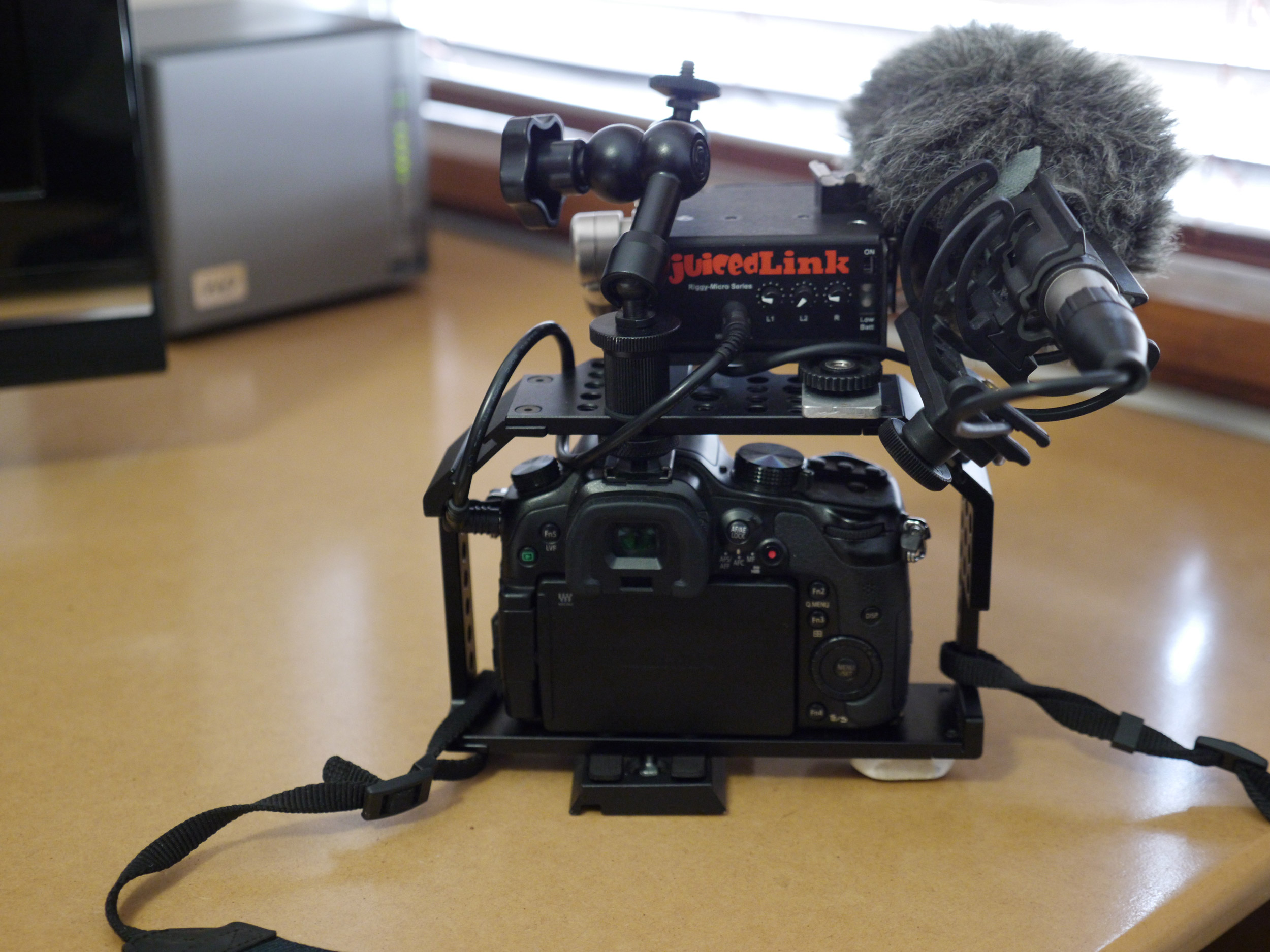

I use a GH3 with a juiced link preamp. I gotta tell you it's not bad. Not as good as a proper video camera for various reasons as mentioned but records uncompressed 48k 16bit which is more than I can say for my HVR Z5 HDV camera. I'm not using it to record symphony orchestras so the quality is fine for my needs. It has 3 XLR inputs: 1 & 2 mix down to one channel and 3 on the other. You can turn off phantom power or even the entire circuits you are not using to save power. It uses a 9V battery and these suckers are expensive so I'm planning on getting rechargeables now that true 9V rechargeables are available. Because once that very bright battery warning LED comes on you better have a spare handy.

Sure you can use such an adapter, or for an on camera mic Rode and others make ones that plug straight in, but for versatility, most good mics have an xlr plug and all condenser mics require power.
Mics with 1/4 or 1/8 plugs either use batteries or need "plug-in power". Rode's Lavalier is a good quality one that can work with plug-in power although I can't say I've tried it on the GH3. (No, I don't work for Rode!)
The mic input on the GH3 is stereo so if you only plug in a shotgun or lav you're only using one channel and you can't utilise the other one. I know an outboard mixer makes the camera bulkier but at least you have separate control over each channel and you can have a shotgun on the camera and a lav or radio mic at the same time.
But yes, you can plug something straight in, adjust the level and monitor with headphones without any extra bits.

My GH3 rig with fhugen cage, Rode NTG-1 and Riggy Micro mixer.
There's also an arm for mounting a monitor.
MW
