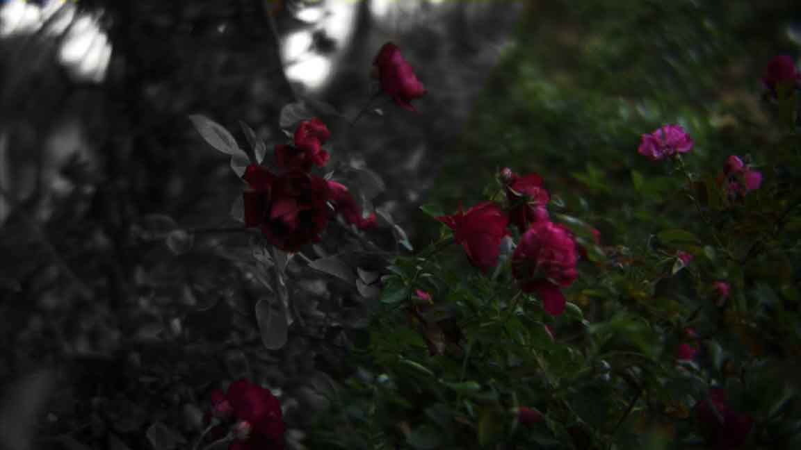

Overcast day, around an hour after sunset..
35mm DOF Box but with the GG spin turned off (not turned on yet).
Also, sorry about the compression on the jpeg. Have a real nice looking (5MB) file if anybody would like to see it...
Chris Leong is offline   Reply With Quote
Old May 18th, 2007, 06:50 AM   #11
Posts: 1,675
very cool looking. Nicely done.

The shot itself is a 15 second long diagonal wipe. Pretty darned effective and, as they say in Latin, QED.
