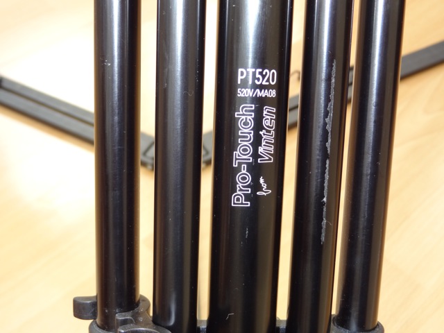

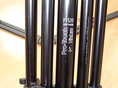

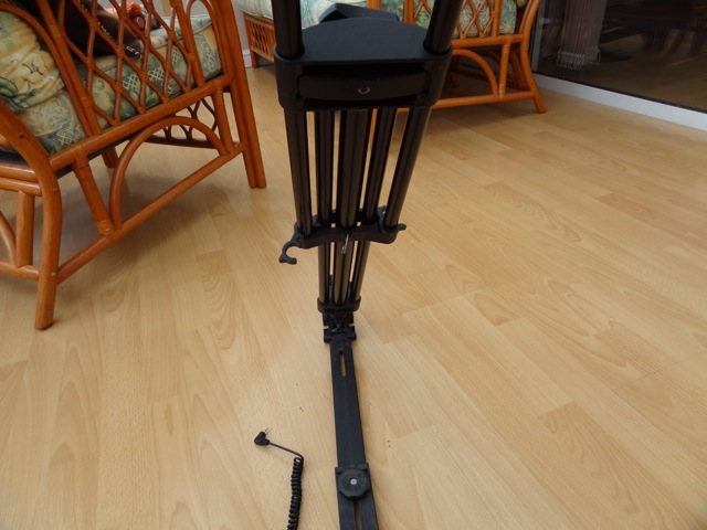

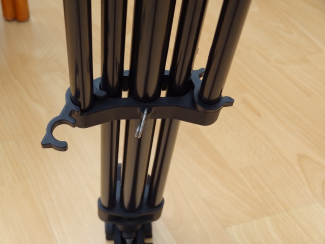

Recently acquired a PT520. Cannot get any information apart from Vinten advising that its at least 10 years old.
I'm after a mid-level spreader, and Vinten say none of their current models will fit. There appears to be an unusual spreader mount on the tripod, rather like the spring end of a safety pin made of strong wire. Presumably something once clipped onto this.
Has anybody any experience of this tripod and any experience of a suitable spreader. Seems to me it might be possible to find a way of fitting say a Manfrotto spreader.

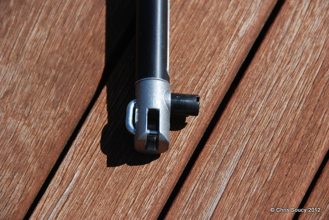

I can't find any info on the PT520, certainly what the MLS attachment points look like.
You might get lucky with someone who has what you're after, but if not, care to send us some (very detailed closeup) piccies of said attachment points?
I can't picture them from what you have described, and as the saying goes "a picture is worth a thousand words" or sommat similar.
Hint: get 'em in focus and up close and personal.
I might be able to suggest a suitable alternative if I but knew what I was dealing with.

Here goes,hope the attachments show up
Ron

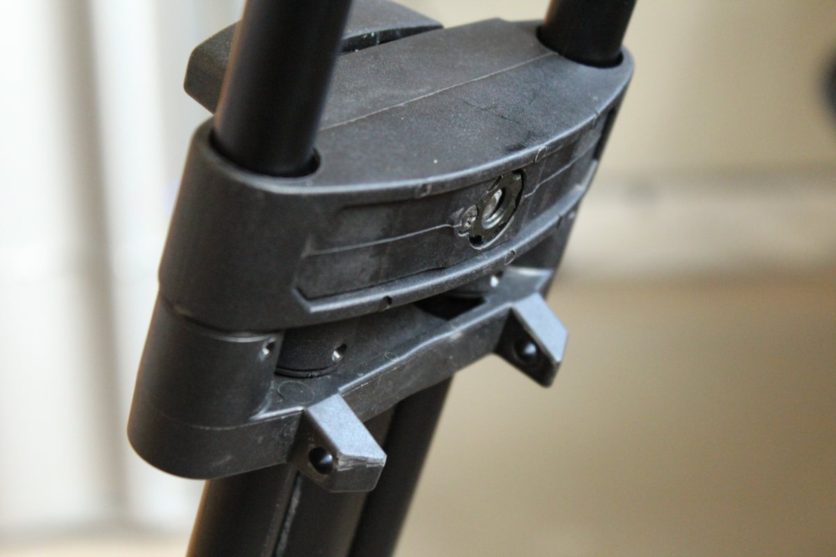

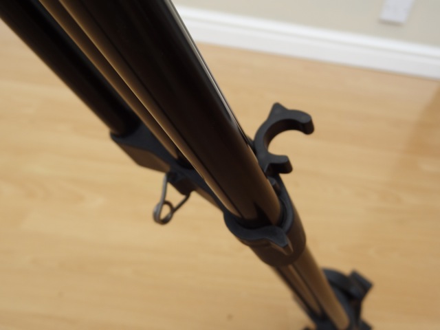

If it helps, here's two pictures of the spreader and the attachment on the tripod leg on my Vision Blue. I believe it's a standard Poziloc tripod, and I've seen the spreader available as a spare somewhere.

The PT520 is a standard Manfrotto 520 (precursor of the 525's) set of sticks, rebranded with a Vinten monicker.
I just happen to have a set cowering in a cupboard somewhere, complete with clip on mid level spreader.
Yep, they'd have to be well over 10 years old, I'm pretty sure I've had mine for over 12.
I simply don't know whether Manfrotto still make/ sell the appropriate MLS, I'll let you figure that one out, but those leg lock clips and MLS attachment "things" stick out like a sore thumb.
Even the GLS is a standard Manfrotto.
I had a sneaky suspicion with the "520" thing, but thought, nah, can't be that simple. But it was.

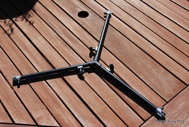

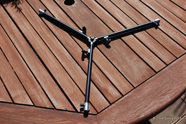

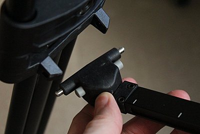

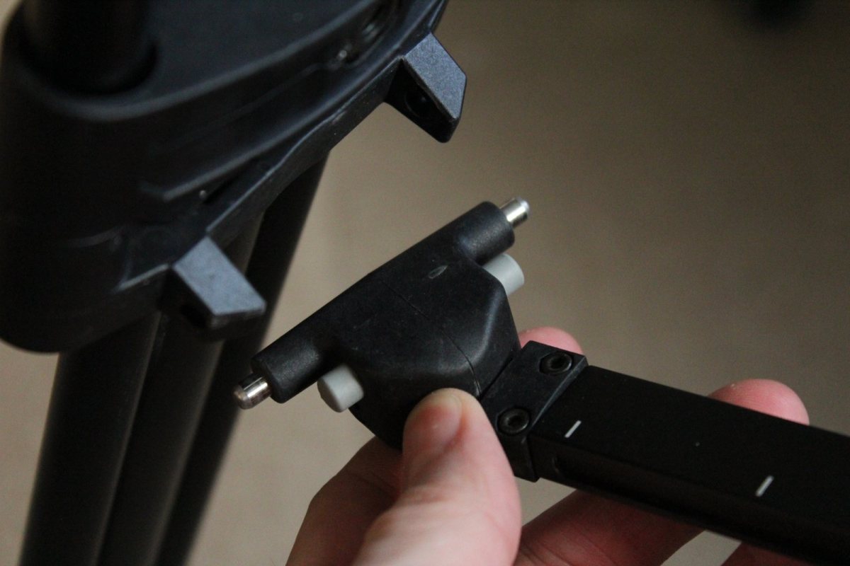

PS: Here's what the spreader looks like in person: Whoops, Top and Underside are the wrong way round, sorry about that.
PPS: They worked OK for SD when I was shooting my XL 1s, but my leap to HD 7 years ago did for them in very short order, which is how I ended up with Vinten. Kinda spooky to see "Vinten" written on them. No wonder no one at Vinten wanted to own up to them, can't blame them.
PPPS: If my eyes don't deceive me, the spreader would appear to be a 531 SPRB and is still listed on the Manfrotto (USA) web site.
