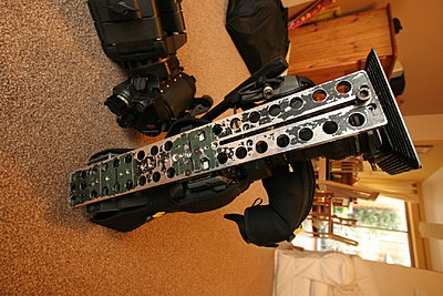

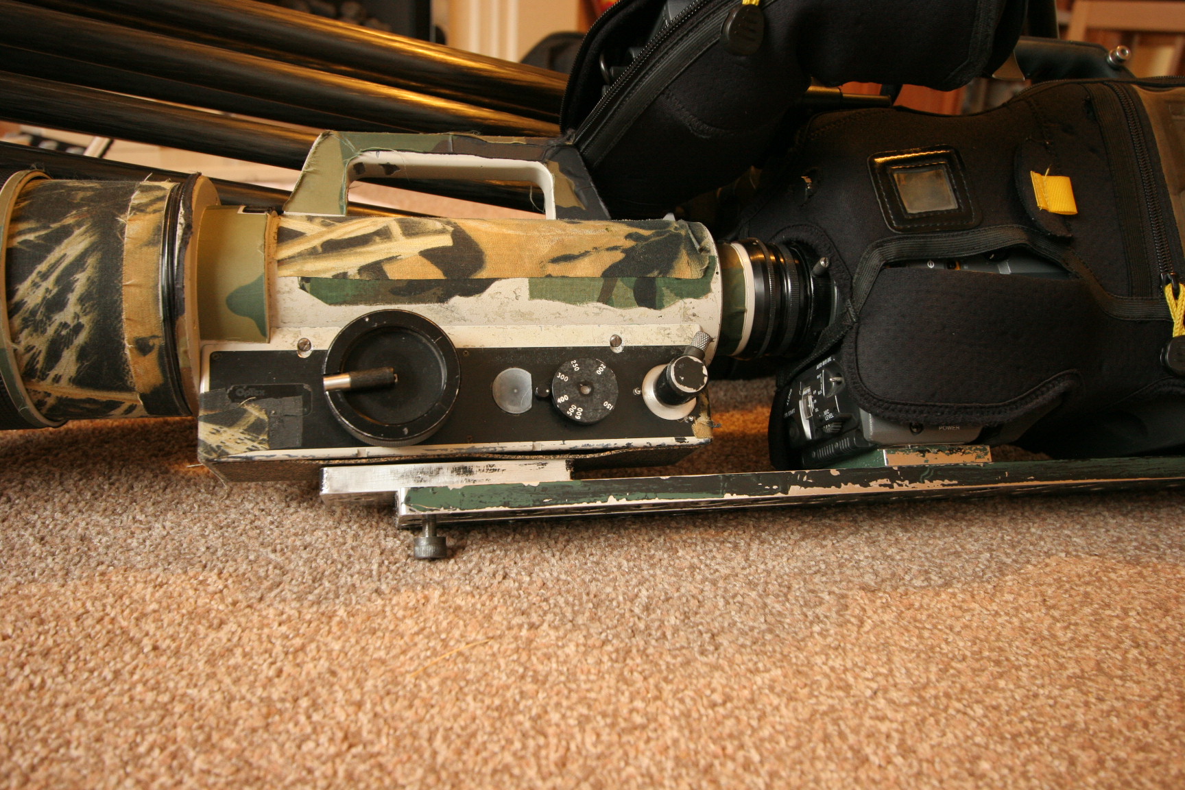

Bo, with regard to lens supports, don't assume that you have to buy off-the-shelf. It's perfectly possible (and often better) to get a machine shop to make a plate for you, they're quite simple.
Steve

Steve, personally I'd stay as far from the Sony plate as possible, they've always been awful for long lens work.
Just get a plate made up by an engineer, something like 2" wide, 1/4" thick and 15" long aluminium. Needs a countersunk hole underneath for attaching to camera base (ideally with a lip somewhere to stop it twisting), then a groove up front with a captive bolt in it to hold the lens foot. Then you can get spacers made for the lens feet of different lenses. Much more secure than anything off the shelf. See pics.
Steve
